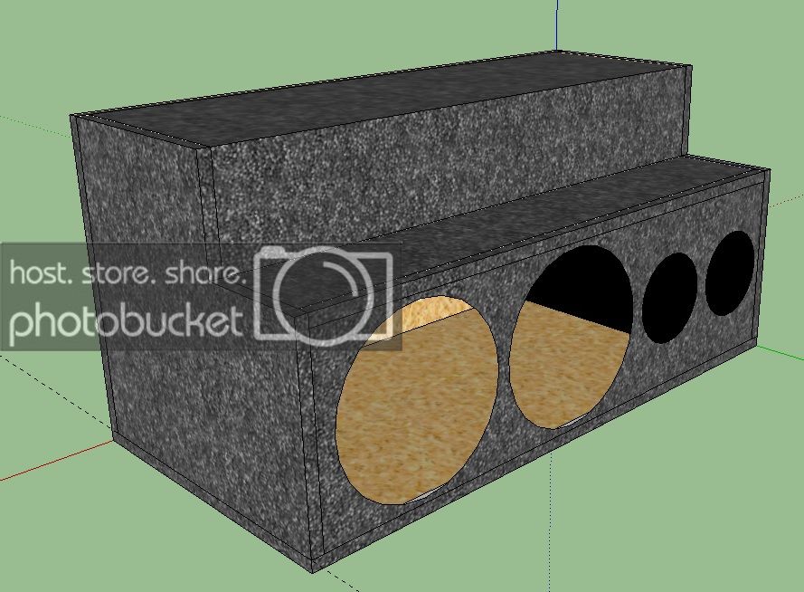

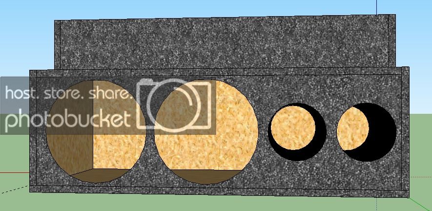

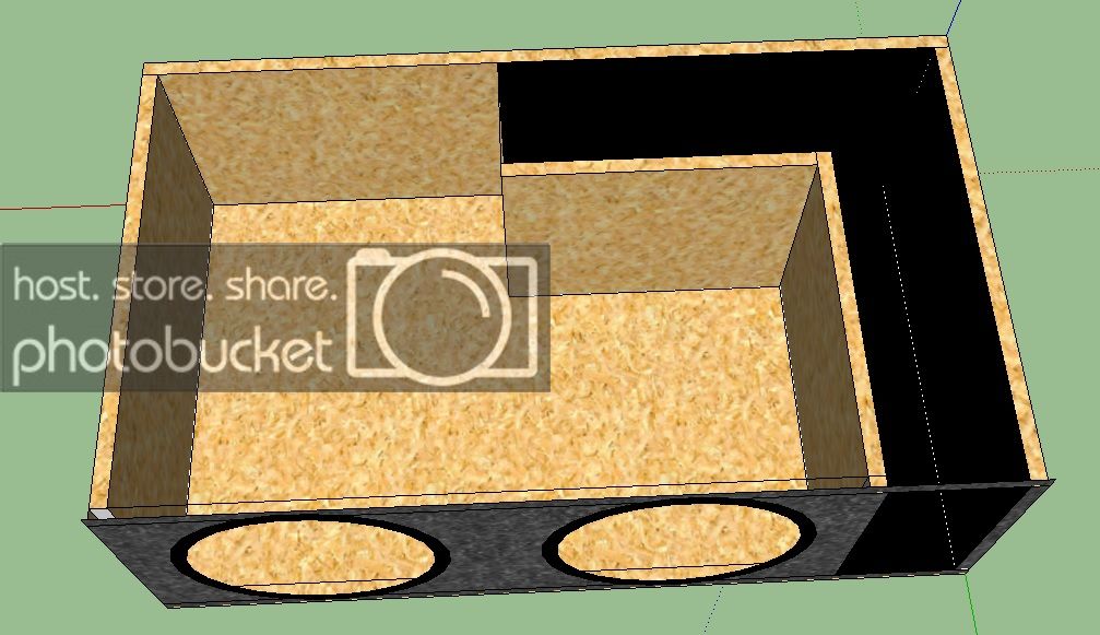

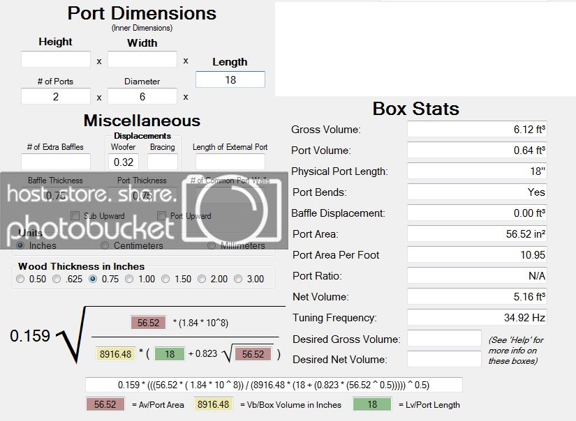

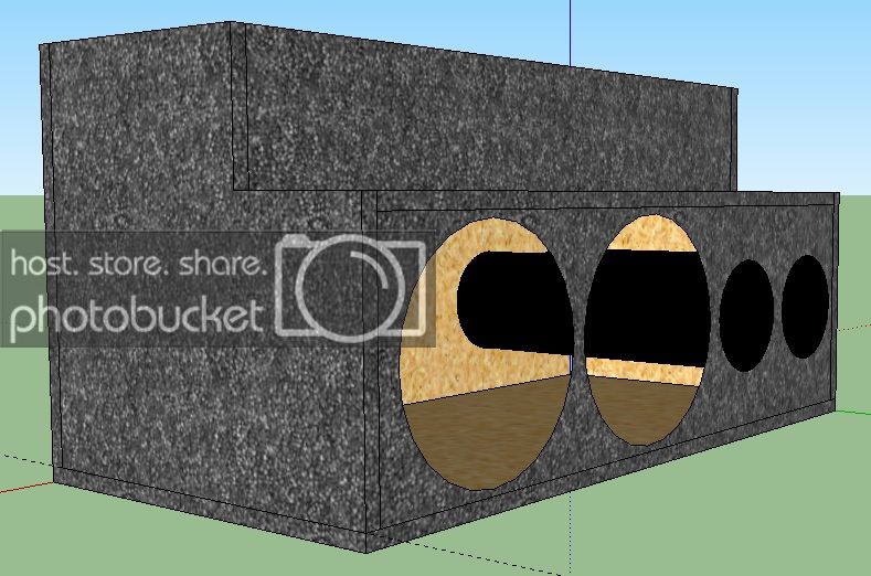

Ok guys The sdc2.5 I have now is loud but not enough. I designed a box today in sketchup that would be forward firing and sealed off with two havoc 12s on a soundqubed 2200d. Box is 6.12 Gross 5.16 Net tuned to 34.92hz with 2 6 inch aeros that are 18 inches long each. This gives me 10.95 per foot of port. WIll this work well?
I would center the ports. That really bothers me for some reason, it'll probably work fine though.
---------- Post added at 07:38 PM ---------- Previous post was at 07:38 PM ----------
How close are the ports to the back wall?
good catch on the port and back wall. I can change it to double 5 inch aeros that are 14 inches long and it will put the port 6 inches off the wall and tune it to 31.81hz
---------- Post added at 08:18 PM ---------- Previous post was at 08:17 PM ----------
would then have 7.20 port per foot
that's pretty low on port area, ive always gone slot though dont have much experience with aero
