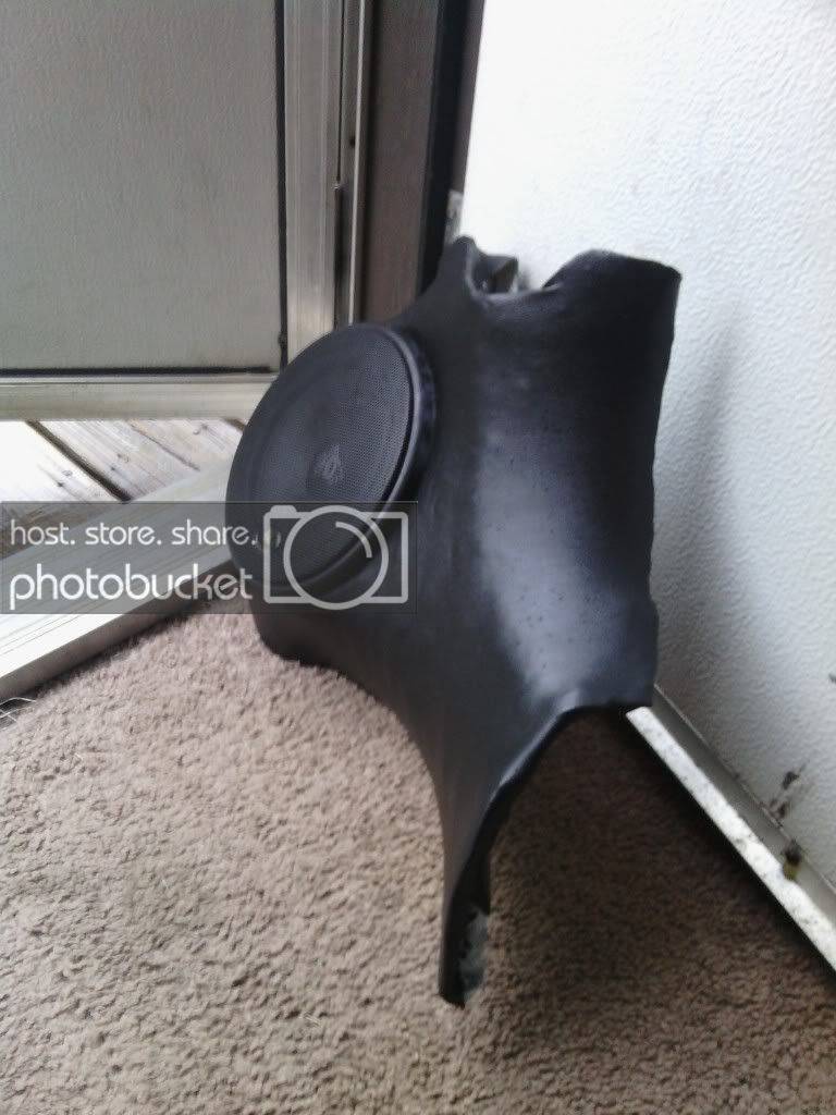

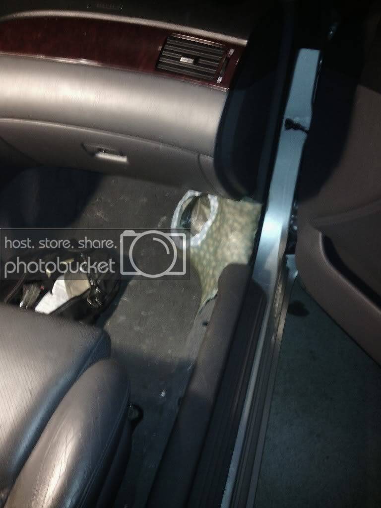

These are my old set. I'm working on new ones now.
But this is how they were mounted.
And this is the finished pod. Don't have pics of the finished pod mounted.

Finished product on the pod looks pretty clean, Im aiming for something similar. Yeah doors are sealed and deadened, though they could use some more deadening for sure!
