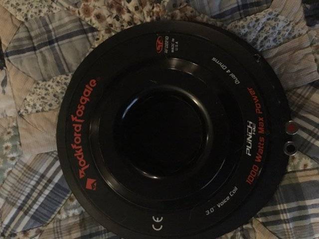

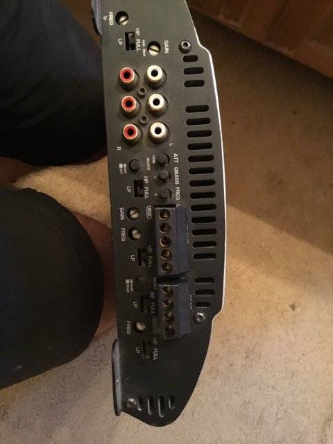

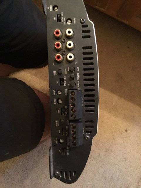

Been "sitting" on this amp and hanging on to these speakers for 12-14 years
t

a proper tune will sound good on anything you throw at it, It should sound like a real life studio performance on your dash. you usually cross tweeters at 2500-8000hz high passed and mids around the same low passed.
Those amp crossovers are no where near close to 1% adequate for any real results. Everything should be done on the DSR-1 soley, nothing on the amp, it should be full passed.

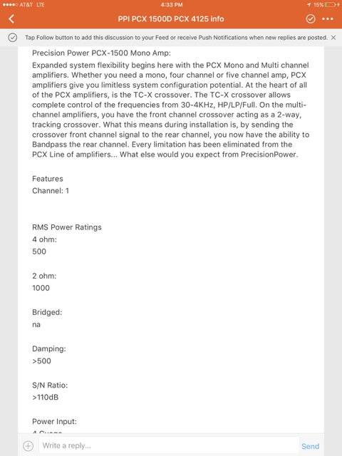

I'm about to check out the vid.... this is the crossover info on the ppi, just for shits and giggles

I would recommend you do not use that PPI amplifiers crossovers to run an active setup. It would be very difficult to do without an RTA and you could easily blow a tweeter with one wrong move if you don't know what you are doing. I have to say I haven't tried that myself but I know enough about these to not recommend that route. The PPI amp itself however I'm sure is a perfectly fine amplifier to use with a DSP or aftermarket HU.
