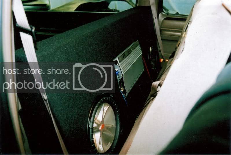

I got about 3.8 ft^3 back there. The hardest part is gettin the box deep enough for the sub. My seat is almost all the way up but after a while you just get use to it.
Heres a couple of pics.
12" hd3 ported and soundstream pca 2000d
soundsteam pca = love. i need to get mine repaired.
