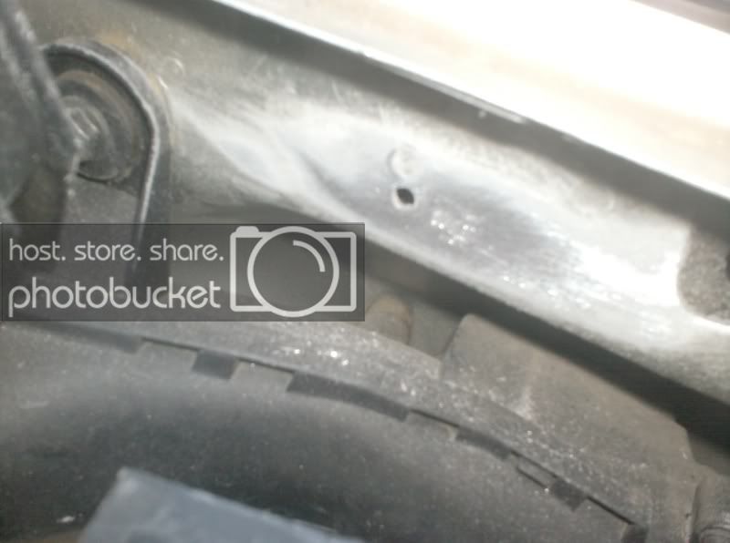

Alright, well i sanded further and now I'm only getting 0.1v so I think I need a new ground location. Here is a picture of the current ground:

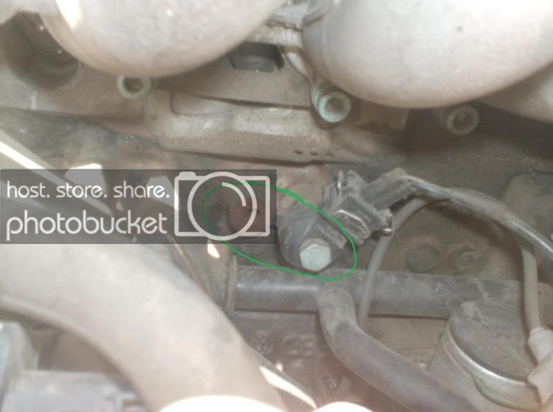

Also, will the screw hole on the left work to ground the engine block in this picture:

You can't test the location for matching voltage of the battery unless you also connect the ground wire. With the ground wire attached to the chassis and the battery, place the DMM on the battery positive and ground chassis. You should get the same voltage reading as when you touch the battery negative.
.1 volts when testing the way you are testing is a good sign that the location will be a good ground.
As for the block to chassis ground, I just used the existing ground location and replaced it with my 0 guage.
Was that screw hole in your picture already open or did you remove the screw? Do not place a new screw into an old location that had no screw. I do believe that some are intentially left open by the engineers.
Yeah, but I'm pretty sure my current ground is what is causing the problem. If i probe the pos terminal on the battery and then the wire that grounds the battery (when the wire is disconnected) I only get 0.6v... that's why I'm trying to find a new ground
In that test (with the ground disconnected from the battery) that is a bad grounding spot. But not because it's too low at .6. It's too high! It should read .2 or less I'd say.
okay i think that makes sense.. the battery isn't connected right now and I'm getting 2 volts when I touch the wire that I just connected to that ground I made. Guess that's a good sign that when I connect it to the battery I will get 12v again?
Also, that hole had no screw in it... what if i use the one to the right of it where there is a screw?
sand it and go with it
