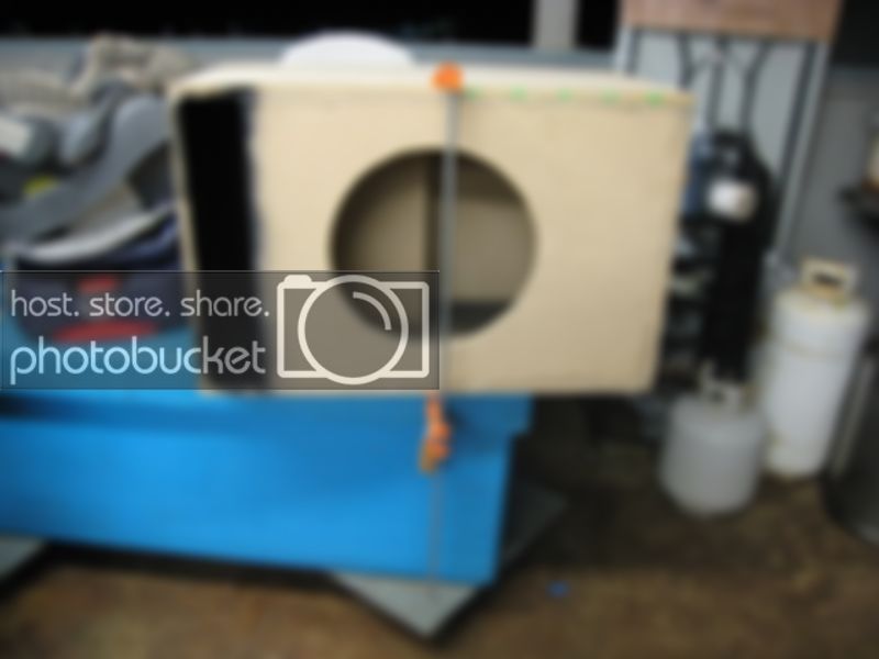

Got my box done yesterday, got my sub in today. FI Q 15" D2
Its running off a DLS A6 1200watts @ 1ohm.

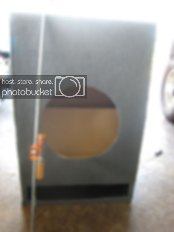

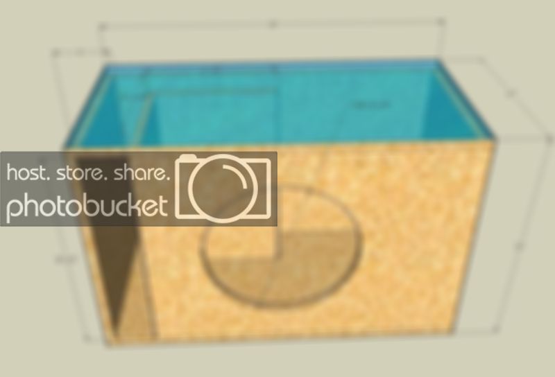

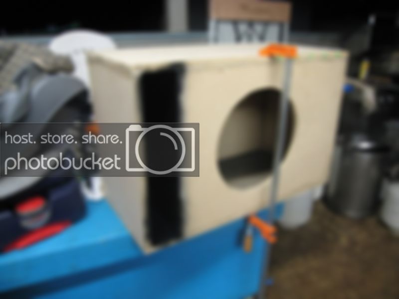

Box is about 4.05cf after displacement, tune to 32hz.
When i play it about 1/2 way, when the car is on or off, on mid high level, the sub stops working. Than i lower the volume, than it plays.

Yup, i check my digital voltmeter d-block, it was reading like 11.3-12.3volts when the car was off... Also, my power wire for my 2nd battery wasn't plugged in. So i place it back in. Now my voltage looks pretty good... Now i can play it a lil louder, but when i fully crank it. My DLS Amp, is ******* some serious juice! And it cuts off...
Oh ya, its fairly loud!
Its wierd, because i had 3 ED 11kv2, hooked up to 1ohm, .5cf sealed each. Never did cut off...
Should i hook it up to 4ohms? It will only recieve 500watts....
It shows pretty low voltage on my digital volt d-block, goes down to like 10.9volts (when the car is off).
I wonder if my 2nd battery is even doing something...
I think the amp is just clipping, since the voltage is dropping....
Did a test run, yes. My amp is not clipping, while driving. But when im parked, engine is off. My DLS amp, is ******* some serious juice, and it clips... Gain is about 60-70% on the amp. Im playing with the remote bass up front...
I think i might wanna hear it in a sealed box. Yes its loud! I can't imagine, what 2 15s would sound like or the BL or BTLs.... This is enough for me!
Im gonna have a friend, to tune all my xovers
