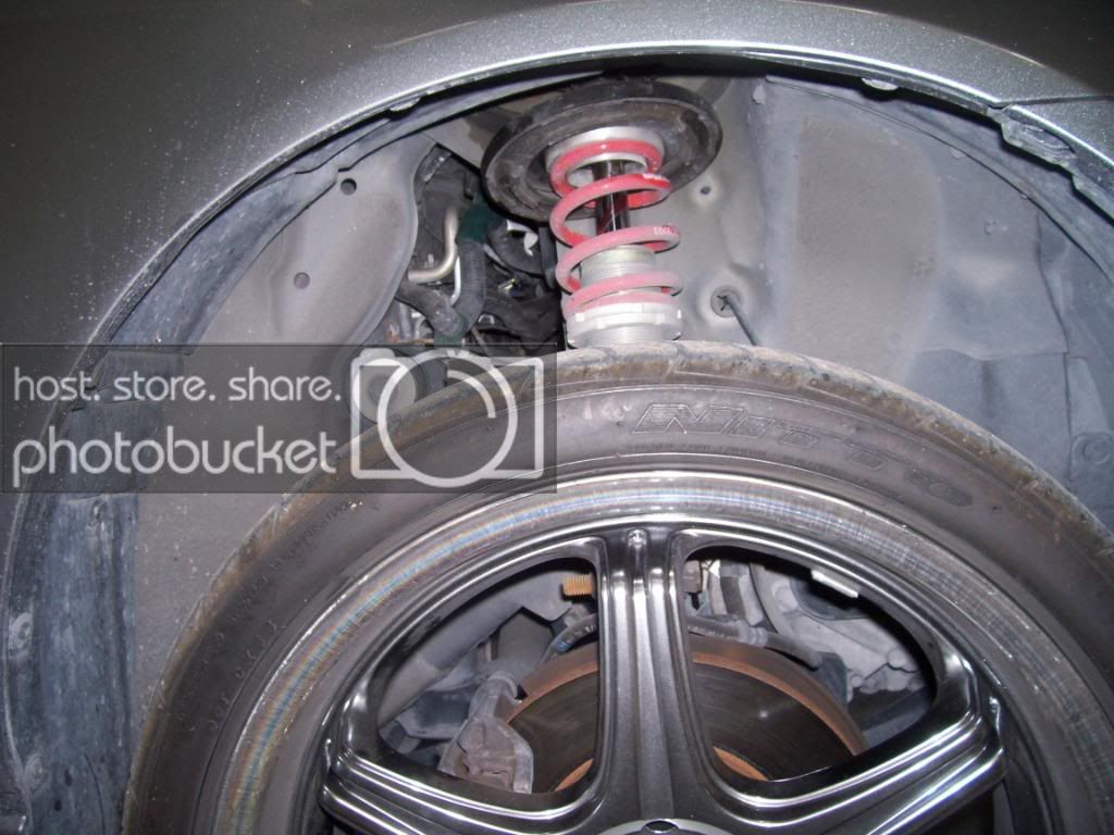

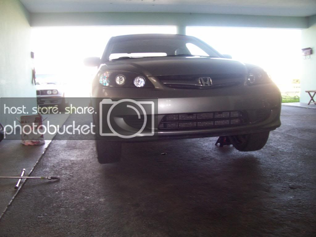

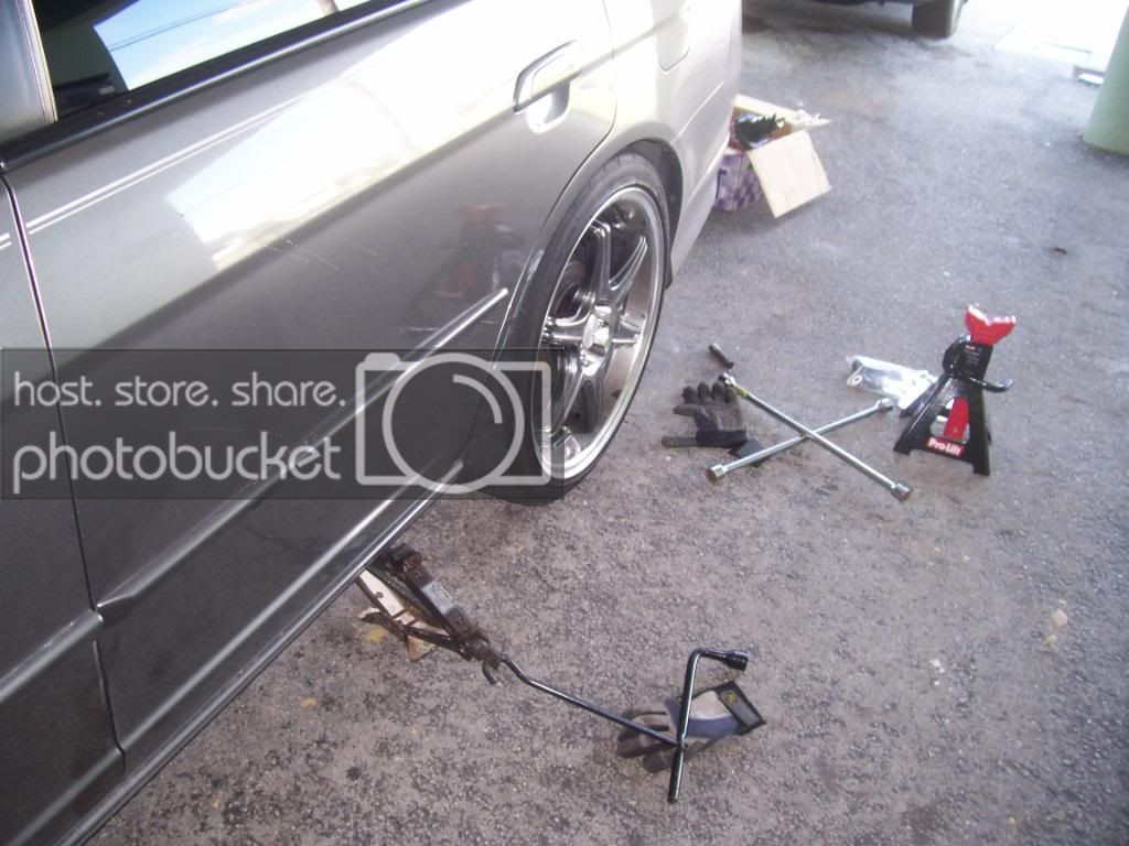

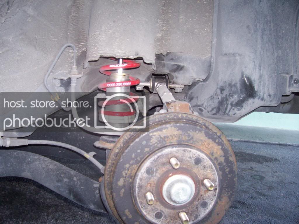

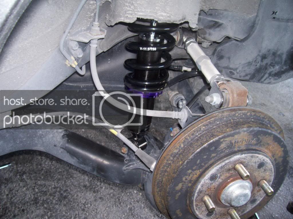

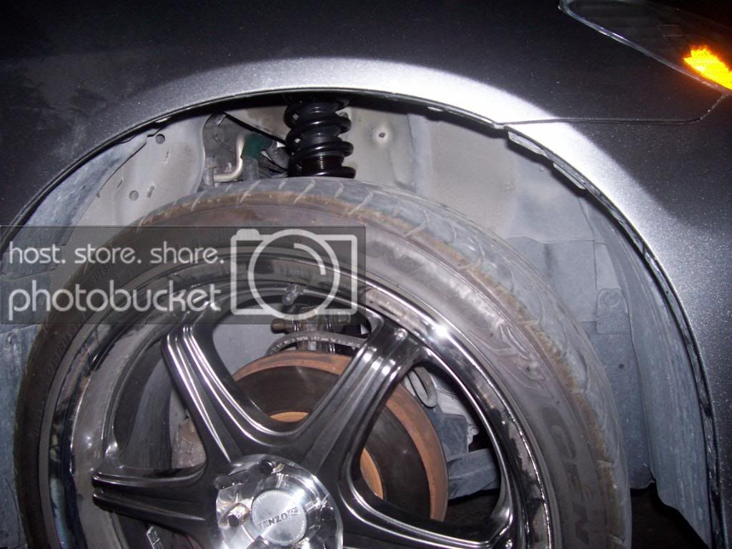

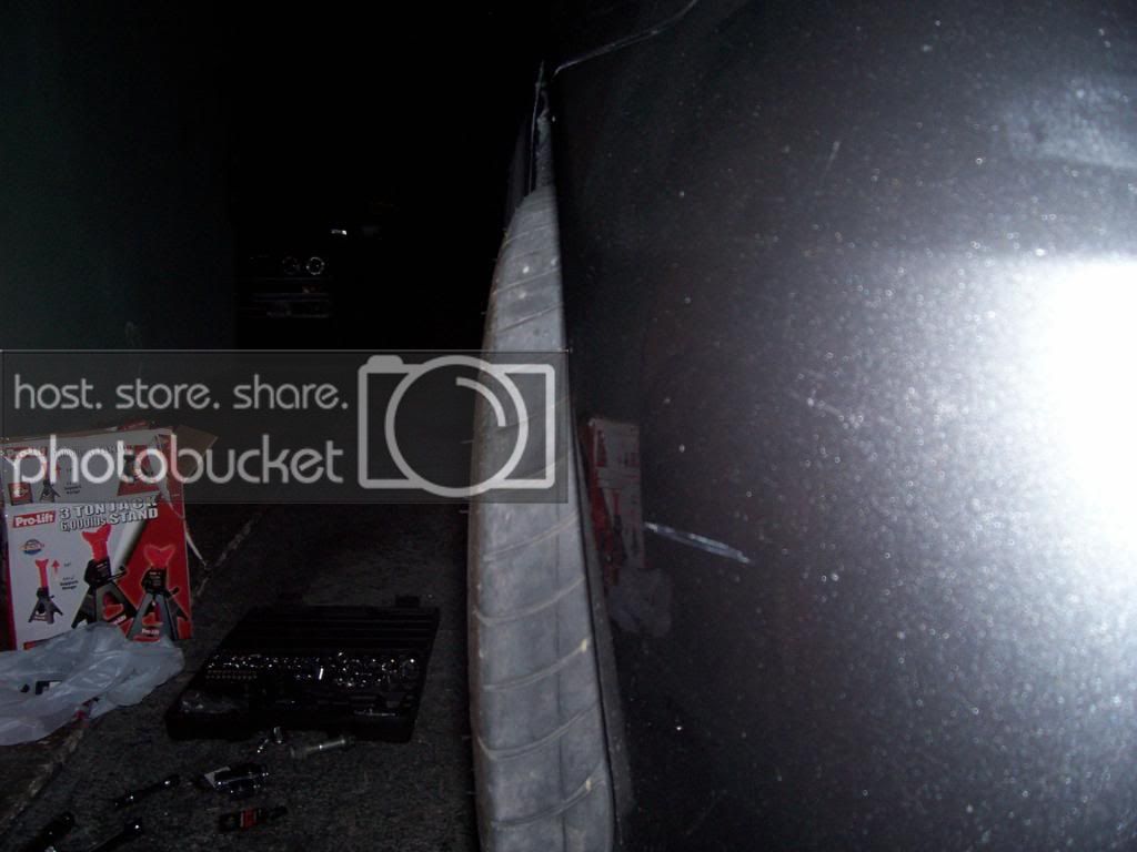

here is where i have an issue. everything is set to the height i want. camber seems just right at eye level.
toe,. is way off!! my wheels are pointing outwards on both. take a look.
drivers side.
passenger
wheel gap is fine though
will finish the rear tomorrow. then on monday i will have my car towed to sears to have an alighnment done. lol i'm not going to drive with my wheels pointing outwards.

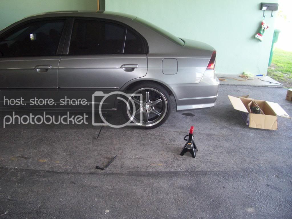

after i got the rear done i had to move the civic out of the porch so i could put the mazda back in. pulling it out wasn't pretty and i found that when i turn the wheel all the way in one direction that my tire is rubbing the sidewall/engine wall.
i left 2 black track marks from where the car was initially positioned and moved to it's resting place. i don't know about yall, but the alignments not drivable. lol

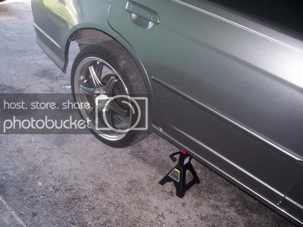

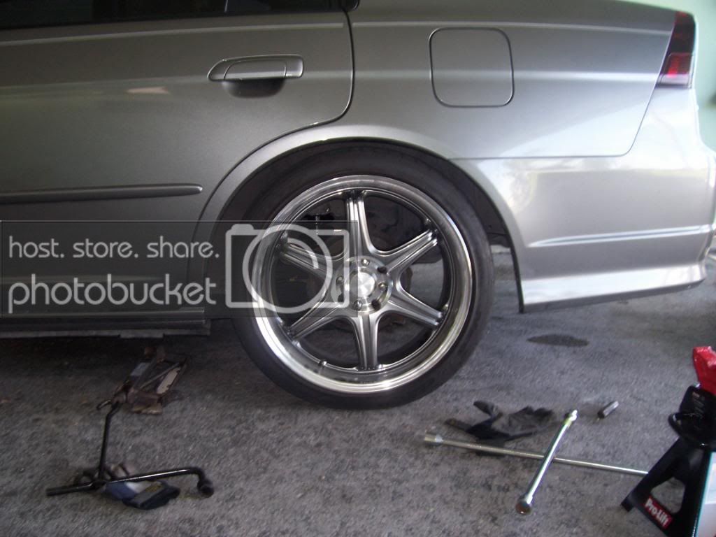

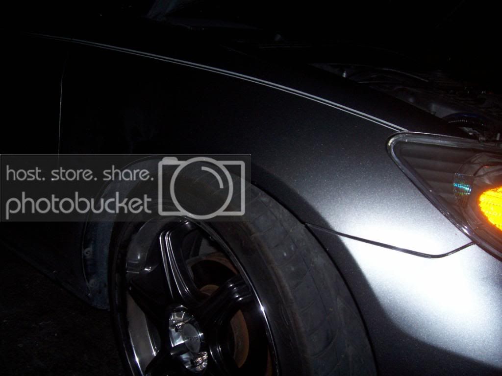

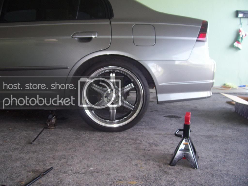

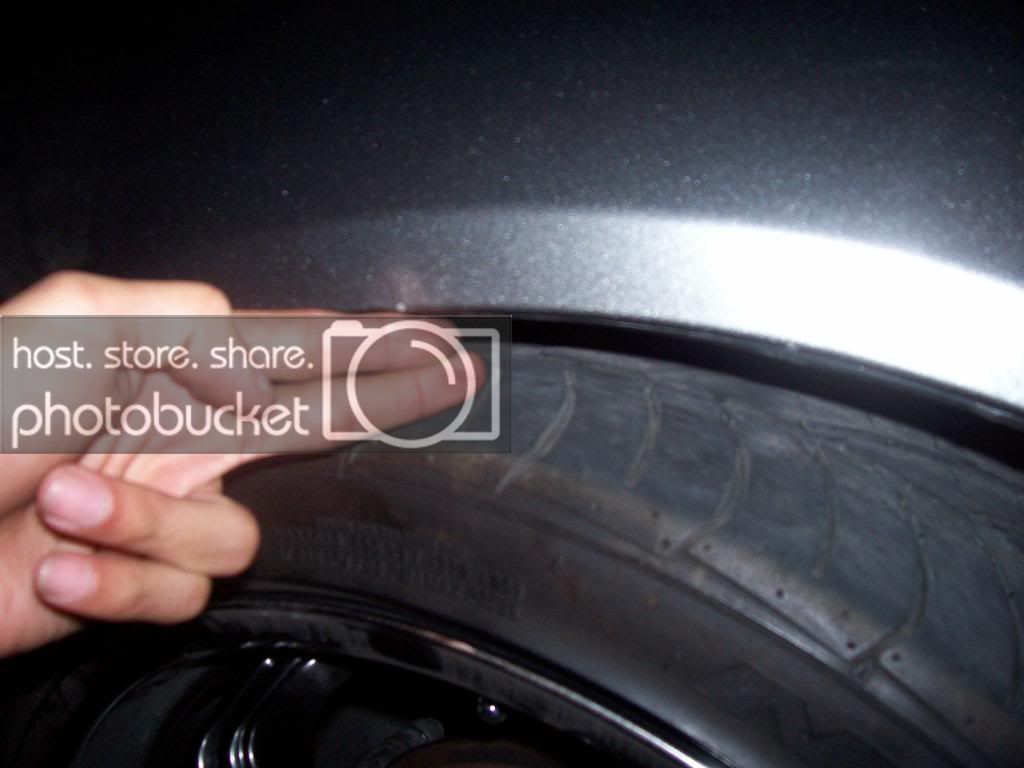

this is how it was initially set to when the coilovers were put in. no height adjustment was set yet. gap was like 2.5 finger gap. and i have skinny fingers.
then i set it to a 1 finger gap.
height is just where i want it. i'm sure when i put a system back in the trunk it will then tuck itself just a litle bit.
tomorrow i has to get the alignment done. gotta start calling first thing in the morning.
