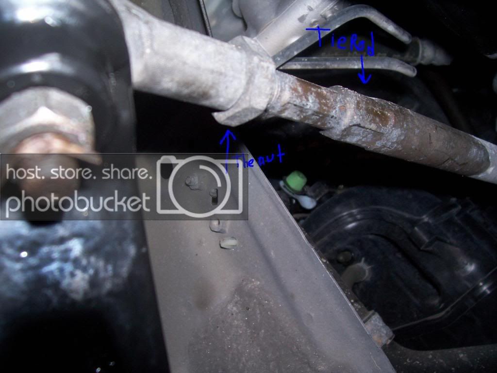

For the bolt that you are trying to untighten, what are you using? You can try a breaker bar. I found an adjustable one one at walmart for a few bucks. Don't remember exactly how much but it was no more than $15.
pic
see, after i loosen that nut, i should be able to spin the tie rod to adjust the direction of the wheel from them pointing outwards. i joust couldn't get the **** things loose. maybe i should try it w/o having it mounted to the strut?
pic
Wow, I was thinking it was just a bolt mounted to a flat surface. I see what you're saying. Maybe if you had some help you can use your force going one way and the other person going the other?

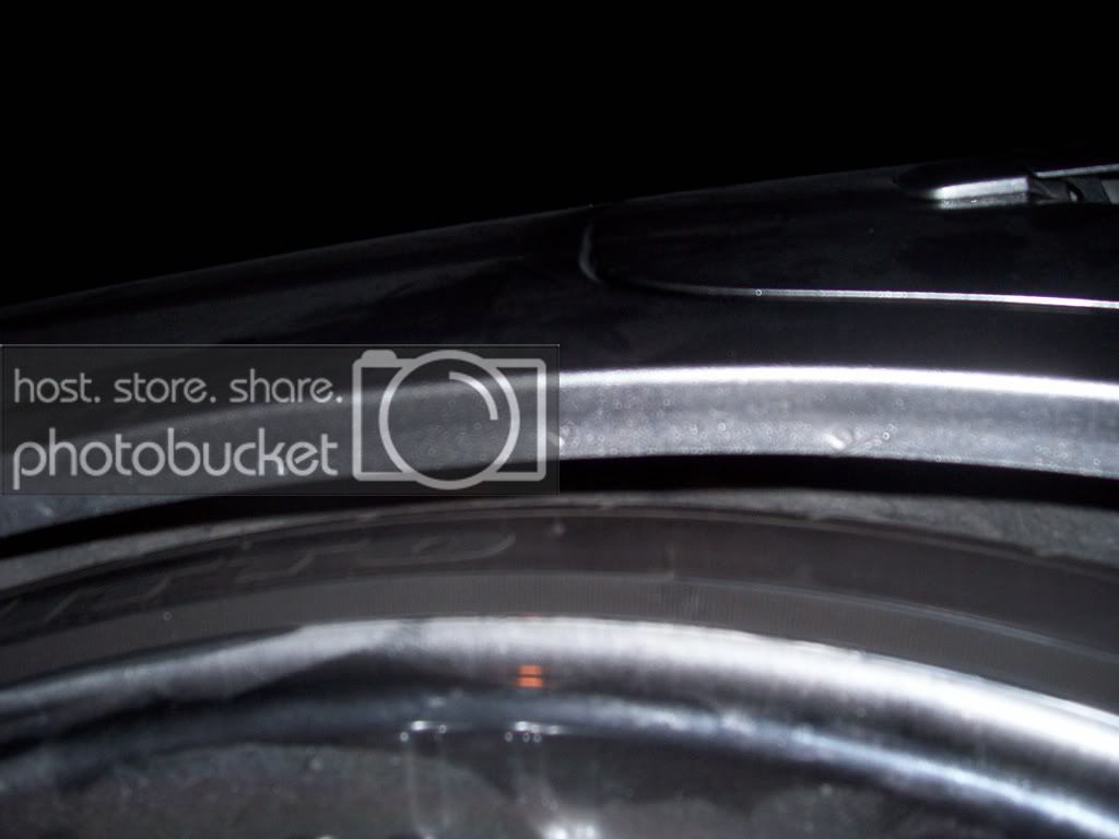

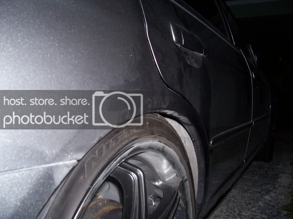

oo, well i got my car back around at 5pm. the front end is aligned but the rear is just SLIGHTLY off with very small amount of camber. when i went to pic up the car the person that had done my car who drives a lowered infiniti g35(sexy *** car //content.invisioncic.com/y282845/emoticons/yumyum.gif.0556df42231b304b9c995aefd13928a8.gif) gave me a quick explanation as to why, and well, i need to have my rear fenders rolled. the camber was just barely enough that it will slightly cause damage to my tread.
downside is there is no where in the keys to really have my fenders rolled professionally. so i have to go to miami for that. going to have to search a few forums for sugestions.

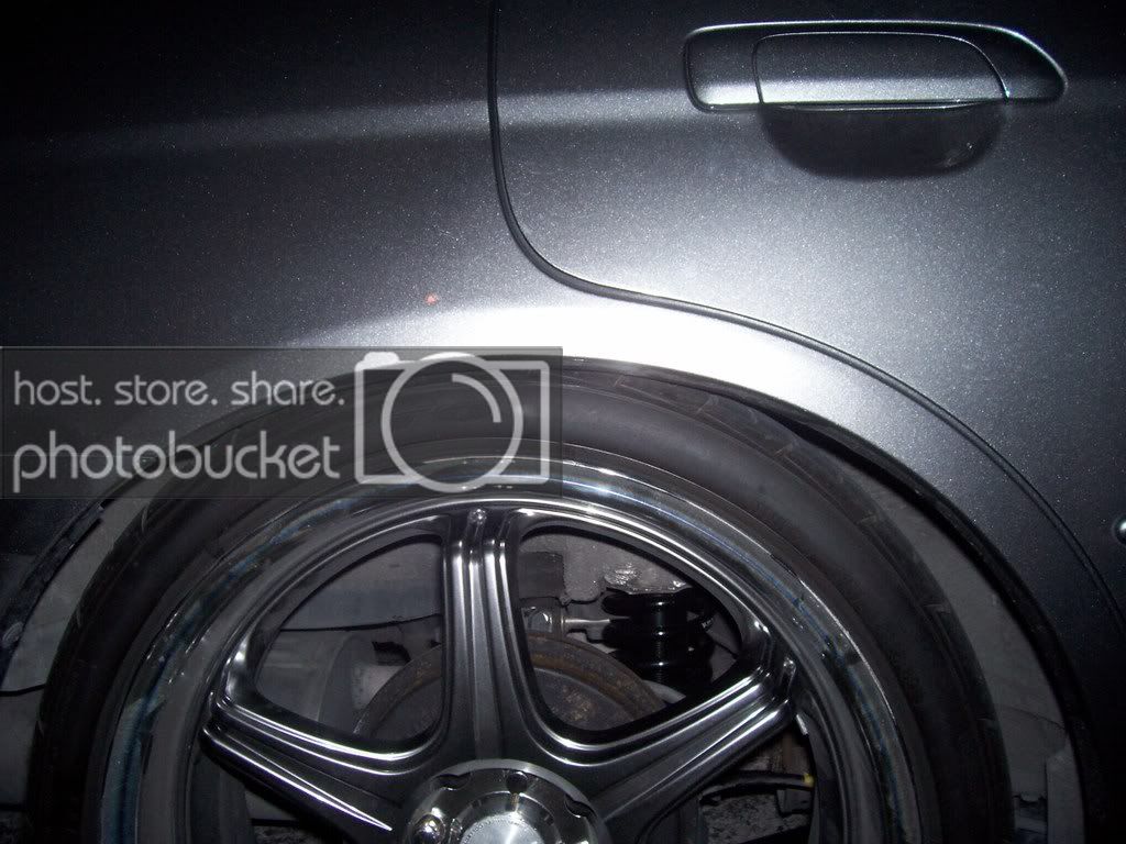

the rear gave in and sagged a bit since last night, but it sits just the way i wanted it. the front sits where i left it.
the ride? i'm highly satisfied with it. it's a little stiffer than when on stock springs and struts but is MUCH MUCH better than that ricer bounce of the sleeves and stock stuts.
when the money comes around i'll start looking into getting the rear fenders roller so i could sit the back wheels in better. i hope to have the funds and the point of contacts ready by then.
for now, heres pics of how the rear sits now.
i'd go take full shots but the car is nasty dirty and needs a wash n' wax.

I 'rolled' my fenders with a hammer //content.invisioncic.com/y282845/emoticons/smile.gif.1ebc41e1811405b213edfc4622c41e27.gif
Heat gun, lightly tap fender lip with hammer, heat gun, hammer, heat gun, hammer.
And I didn't even have stress cracks in my paint.
Saw a video of this being done. Another method was having someone slowly drive your car as you stick a pipe between the fender and tire. Ghetto, funny, but it worked.
