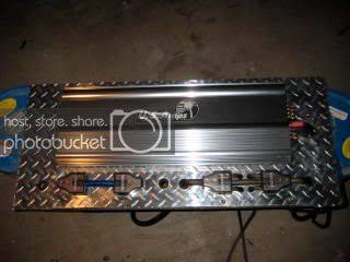

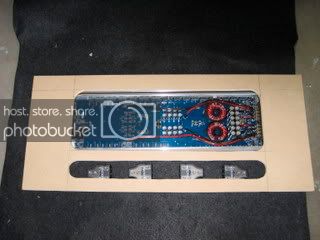

I was going to reverse mount the amp so the plexi showed but I also thought it looked pretty good this way.

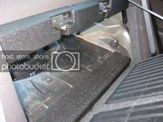

the rack will be mounted where the back seats fold down in my 2005 Pontiac G6.
It consists of a 3/4" piece of MDF with diamond plate mounted to it, there is my US Amps USA-2000 and 4 Kicker distro blocks. I used 4 because the us amps requires 4 power and 4 ground wires and I will eventually add a second USA-2000. I have 2 runs of 1/0 hyper flex for power and 1 run for ground from the battery under the hood(which is grounded to frame and engine block). I have a lot of photos and will be starting a build log soon. I quickly cut out a cover for the amp rack that will be wrapped in vinyl and will have plexi on the back.
Give me some suggestions, let me know what you think. Keep in mind there are a lot of finger prints on itt right now, when I am done it will get polished up a bit.
