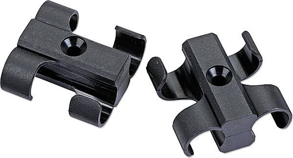

Streetwires has wire clips for 1/0 gauge wire.
http://www.streetwires.com/products/default.aspx?grp=19
Just an idea...
Can't say i've seen those before. Very cool. //content.invisioncic.com/y282845/emoticons/eek.gif.771b7a90cf45cabdc554ff1121c21c4a.gif
Sucks they're $3.50/ea though when i'd need ~50 of them.
