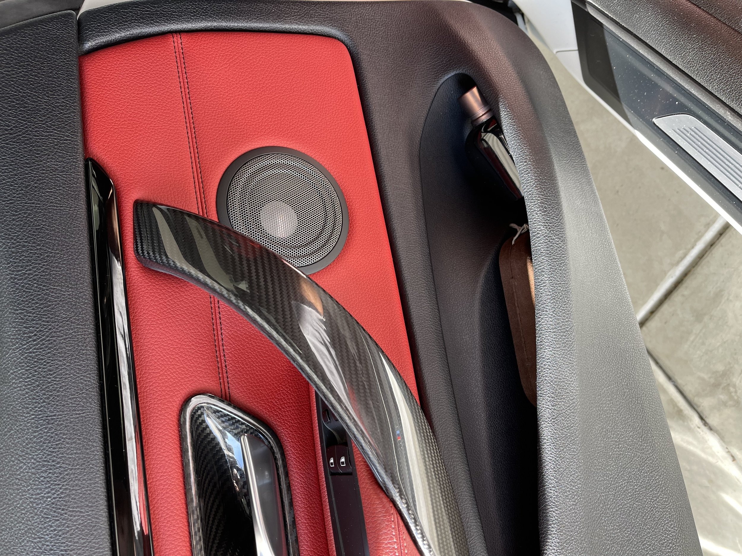

The cdt’s can have solid midbass output but like any set of speakers you choose, install is key. In infinite baffle applications that xover point of 100+ hz is due to exactly that. Most midbass drivers won’t do well under 100hz in the bass department when run IB (this is also vehicle dependent). In a sealed enclosure it’s a totally different ball game. Depending on the car and enclosure size you could easily achieve output as low as 60hz or even lower. Where are the factory speakers located? Could you post a pic of the location?

Some of the BMW's use an underseat midbass. esp. if it is the logic 7 system. I know my E60 had them, and the door speakers depending on the model and attached stereo; don't supply a full range signal to the doors. There is also some depth issues. That looks similar to the drivers I had in my door and they were only 100mm diameter and the depth was 65mm?
Check out a company called bavsound.com or the speakers on partsexpress from GRS that offer direct swaps. None of them are really cheap though. Focal, Gladen, earthquake and others offer midbass solutions but are expensive. Most will need a spacer and wiring adapter as the factory plugs are meant for their drivers.
Yes, my BMW has the factory 8’s under the seat. Im familiar with Bavsound and other replacements. I would rather someone build me door pods and throw a decent 6.5” in there.
