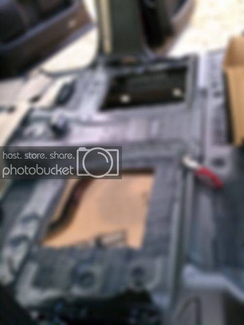

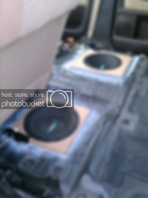

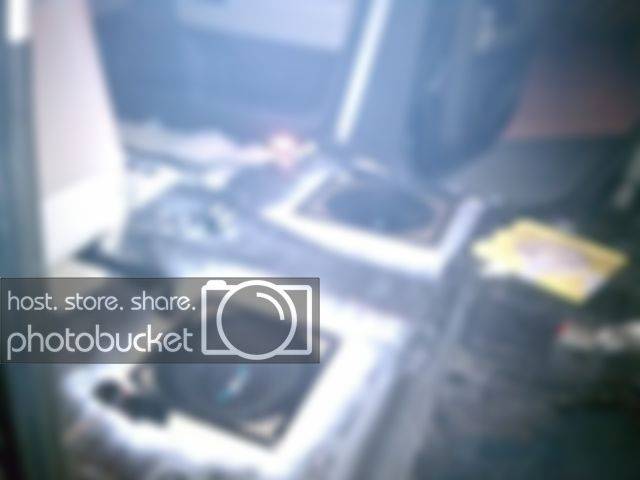

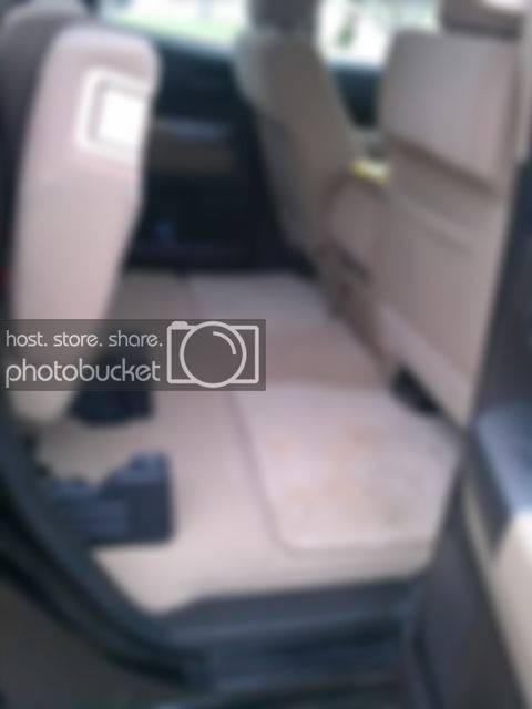

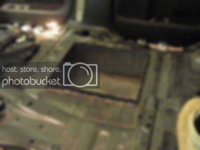

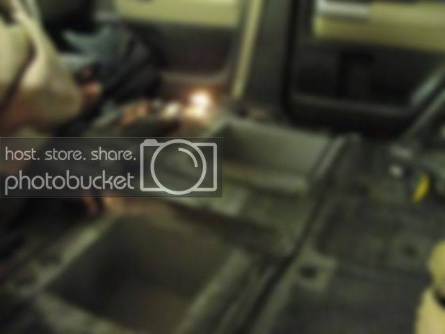

Where do you plan on mounting your sub? May I suggest this method?
