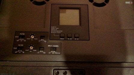

You would need controls like my Alpine F545 amp... or similar.
