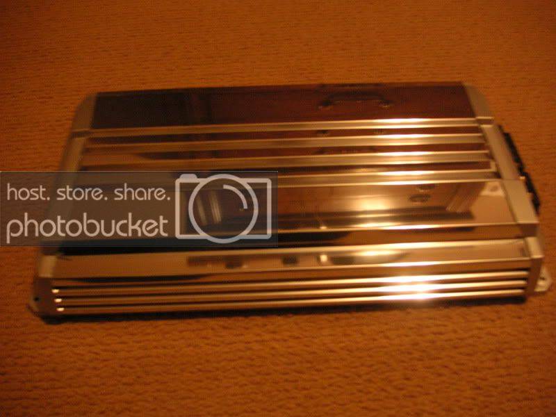

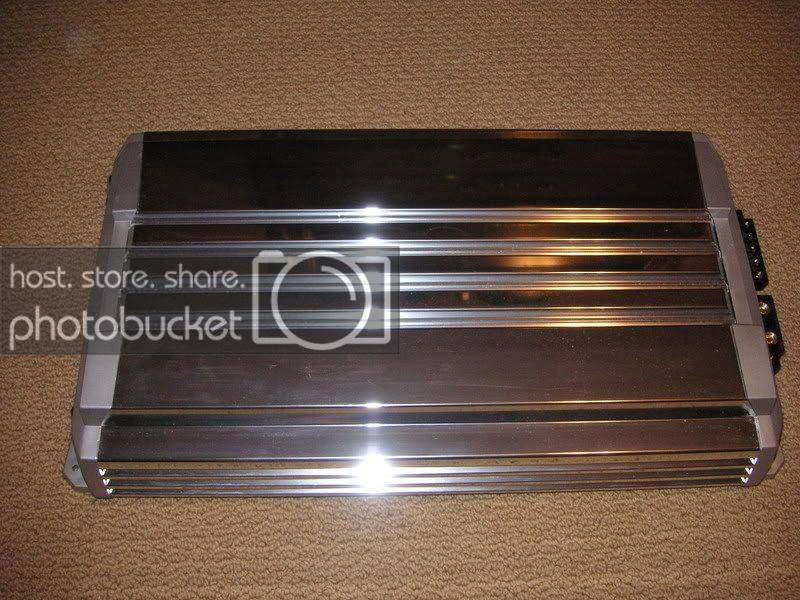

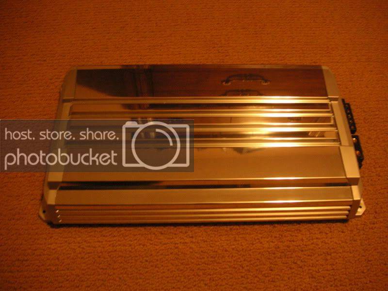

Ok this is going to be my first active setup. Just have a few questions. I'm not going to do everything for a couple weeks, but I want to plan everything out so it goes smooth. I am going to upgrade all my wiring first, all new Knu Konceptz (Big 3, batt to amp, RCAs, speaker wire). Here is a pic of the amp:

You sure? It doesn't have a LP filter on the front channels, just the rear...or so it appears. I was told to use the Xovers on the 9835 and not the amp...by other people on here before.
ah.. I didn't catch that you had a 9835. in that case, yes, use the x-over filters on the HU.
the settings on the amp should be 'full pass'.
if you're using the x-over on the HU, the x-over on the amp should be bypassed (not needed).

Yeah I know that^. I want to try active with what I have first. I know how relatively cheap piecing together a speaker set would be. I just want to try it out with what I have to figure out tuning and such. I will pick up my amp from home tonight, so I haven't seen it yet. Anyone know how to "bypass" the filters on the amp? I know on my Alpine amps the filters have a switch for "off", but I don't see it on this one in the pics that the seller gave me.
