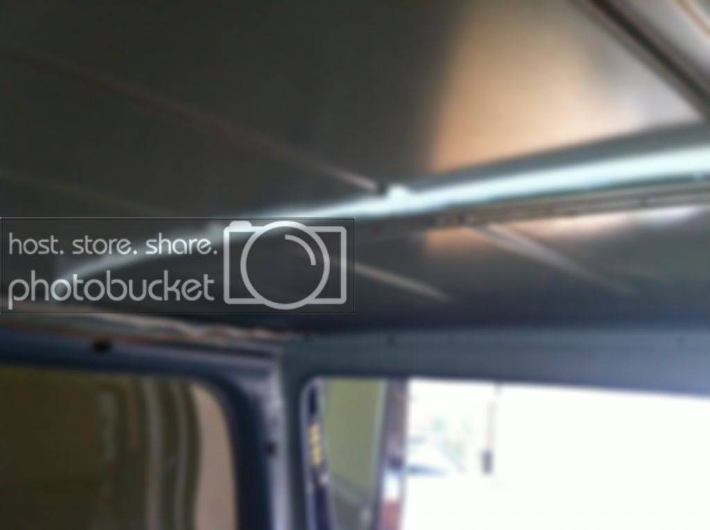

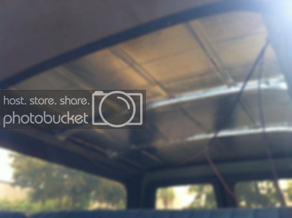

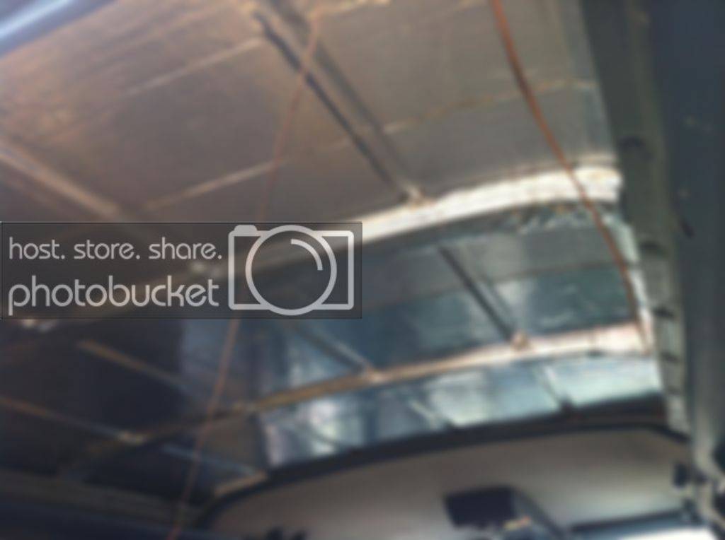

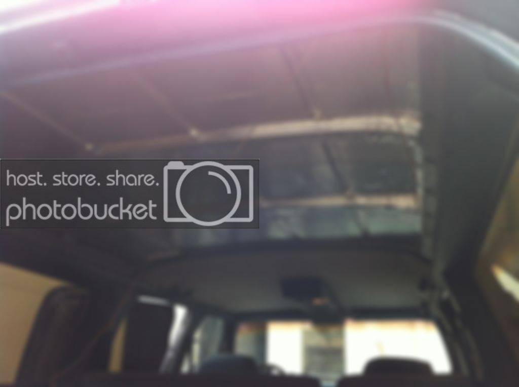

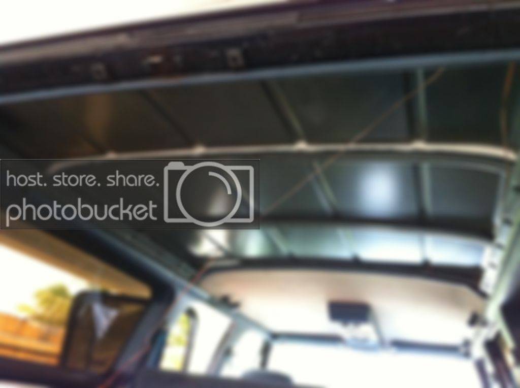

decided to start sound deadning process. pulled the rear half of the headliner - and tossed all the junk for the rear ac since it was not hooked up anyway.

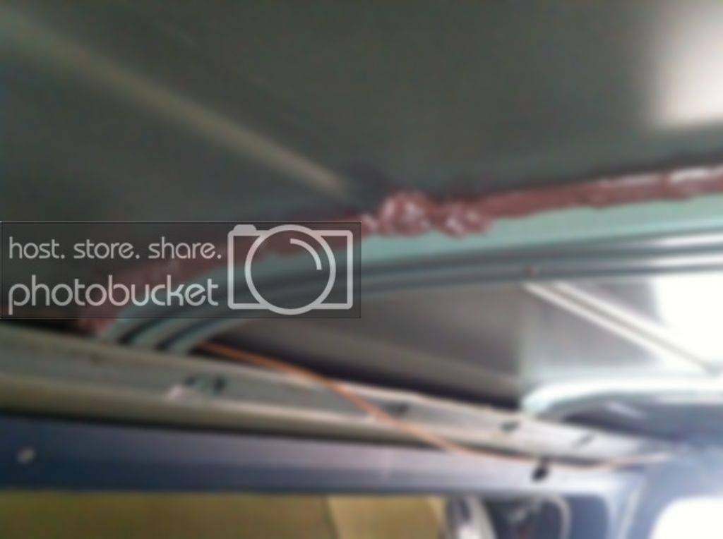

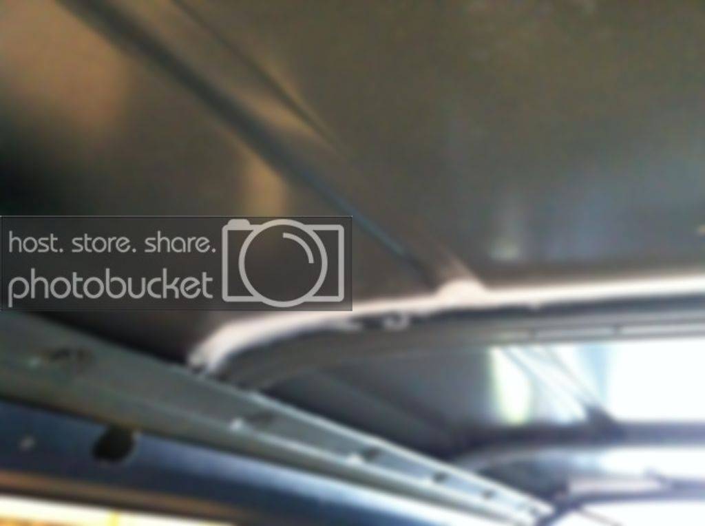

packed all the roof ribs with whatever left over tubes of caulking i had laying around my shop. idea was to bond the roof to them slightly and also prevent any metal to metal contact / rub / noise there. - some of the gaps were quite large - so im wating 72 hours before playing bass just to give caulking time to set up good.
im super messy with caulking. always have to mush it with a finger to "help" lol

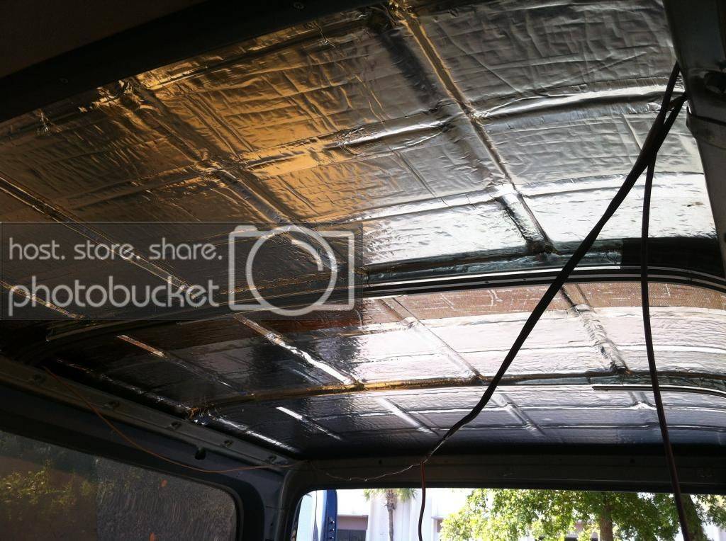

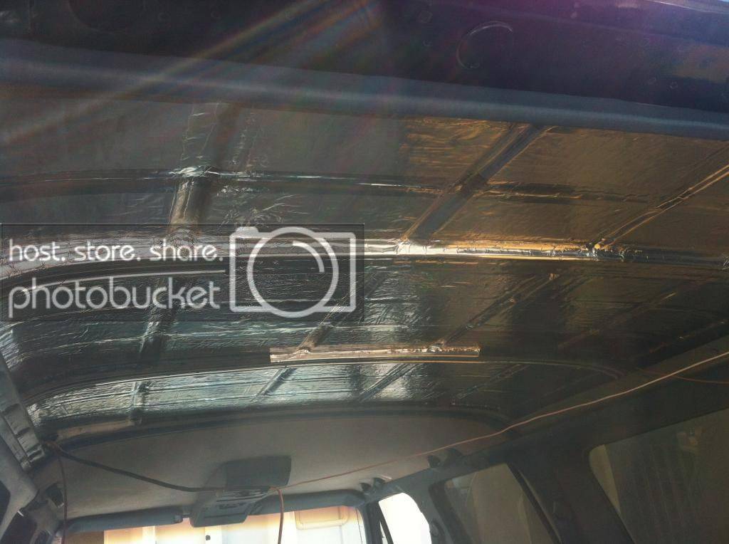

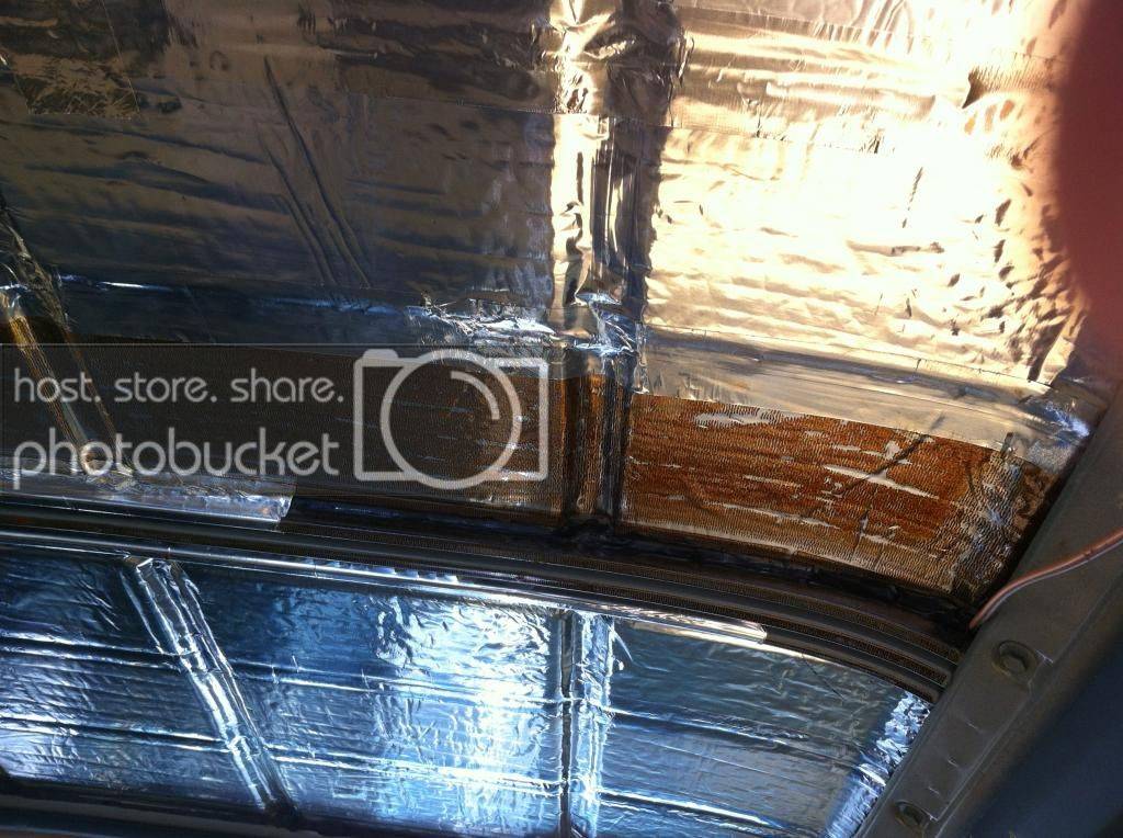

and since i had a home depo gift card - i picked up 4 rolls of this peal and seal type deadner $16 a roll and still have $4 left on my gift card - thanks santa !
went double thick on all areas of the roof. overlaped the seams. used a longboard skateboard wheels mounted to the trucks to "roll" all of it on for a nice job.
was tough on the arms and neck...
hopefully it will help some. still have to wait a bit to play bass and see if there is any improvment - might do my rear doors next - or might pull the side pannels back there and do that area next. still have a few ft of the cheap o peal and seal leftover - but i might wait and test with what ive done already
if i find that it infact did not help much at all - i might have to pony up and buy some real sound deadner
Interested to see if the peel and seel does anything for you.. a ton of controversy on this forum as to whether or not it works. General consensus seems to be that it doesn't.
But since you clearly have it installed, you should be able to shed some light on that soon.
im hoping double thick will do something. at double thick its still cheap - but if i have to go tripple thick it starts getting in to the "real sound deadner" price range per foot used at x amout of layers thick bla bla ...
tomorow on the way to work and home i shall play some and see if she rattles up there on the roof as bad as it did before.
I had horrible results with the peel and seal. I did multiple layers, it just really didnt work very well for me compared to good CLD tiles. but the worst part is it falls off in heat and its just a mess really. Hope it works better for you, this is a cool build man

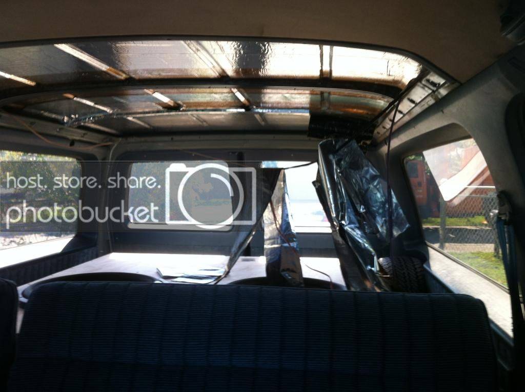

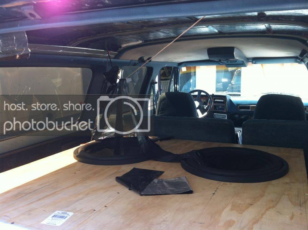

3 strips of 6" wide had already fallen down = landed on top of my box and subwoofers.
and that was only 10 am.
pic to follow. fml dont use peal and seal on your roof - the hot sun will literly melt it off. it will fall down - and make a big *** mess. you will be angry

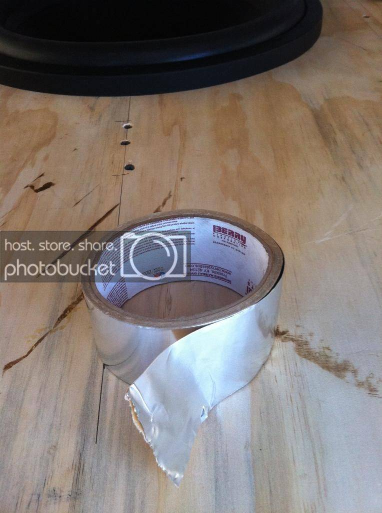

figured id try and stick it all back together as best i could. used this aluminum straping tape for ac ducts on all the seams to make all the seperate pieces "one big piece" so hopefully it wont fall down again. maby it will. who knows. i hate that this happened. but thats what i get. fail - learn from it - fix it - do better next time.

its still hot. the hot sun beats down on my roof - transfers to the asphalt of peal and seal - gets that hot - the aluminum face acts like a grill or oven convexing hot in to my truck. literly it was so hot to touch i had to wear a leather glove to press it all back on. id imagine the aluminum surface of that crap was well over 100 degrees on the underside of my roof inside the cabin of the truck. so yeah. even if it stays up and i keep it there - now my truck will be a gigantic slow cooker set to 125deg. from 9am to 7pm every day this summer. im not happy
stay away from peal and seal.
you will be so angry at your self - learn from my fail please
Seriously man I would just cut your losses and throw that crap away. If it's not even sticking to the roof it's not going to have ANY sound deadening properties...
