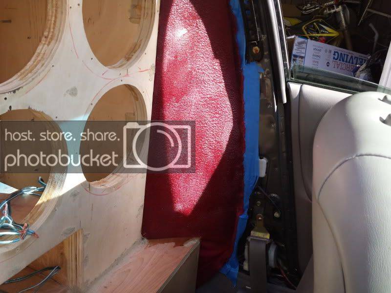

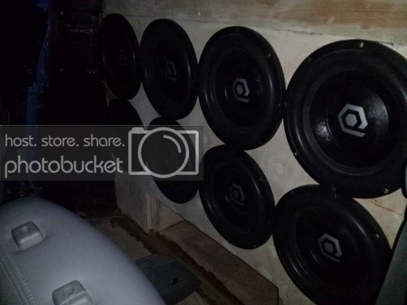

Galant wall, 10 obsidian 10's ported 2 7kw amps. ;)
Got both sides done. Gonna hook a saz 3000 up to it and try it tomorrow. //content.invisioncic.com/y282845/emoticons/biggrin.gif.d71a5d36fcbab170f2364c9f2e3946cb.gif

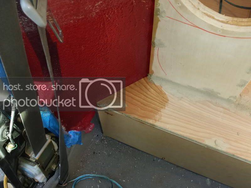

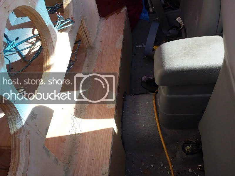

didnt get to try it out, still need to seal behind the sun roof, bondo the sides, make a comp amp rack on the floor and install a set of mids. i did run my power wire today. hopefully next wekk ill get to order my mids and batts.
here is a little pic for now.
2 cans of foam and the space behind the sunroof is sealed. //content.invisioncic.com/y282845/emoticons/smile.gif.1ebc41e1811405b213edfc4622c41e27.gif gonna try to play it today and see how it sounds on my buddys sundown 3k. If it plays lows well i know the cabin is sealed up pretty good.

Thanks, im pretty happy with it the way it has came out, esp since this was my first wall and first time glassing. Should be loud, 800 oz of motor force and a touch more cone area than 2 18's on about 11k clamped when i get my amps in.
If it sounds good im gonna take all the subs out, carpet the face, paint the port and sand and bondo the crap spots on the fiberglass walls.
Well tested her out today. I was dissapointed and pleased with it at the same time lol. I tried it out on my bros crescendo 5500 at .25 ohm. Amp was protect happy without the car revved. I got a ton of power out of it unclipped though. Box was hella loud from 42 hz to about 62hz. It faded at 40 and died in output at 35. Same at about 63 and up, of course that might have been the crossover. Moved some air at the lower hz but had no output. But holy shat, from 42 and up it hurts. Got a small youtube vid im posting up, had the volume at 3/4 car at idle, open the door at the end and unloaded the subs and it made it protect.
