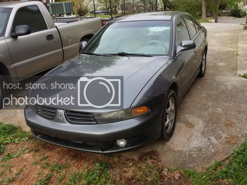

Pics of the car

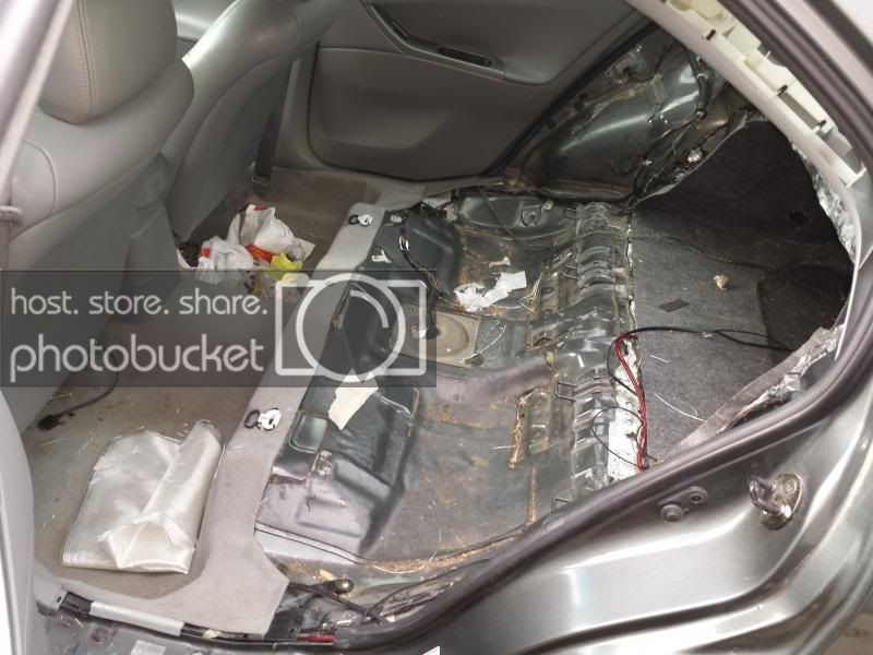

Gutted backseat plus lunch trash lol

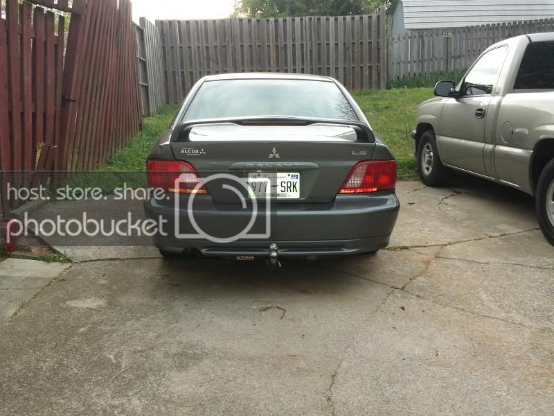

Yea i got a Uhaul hitch *******.

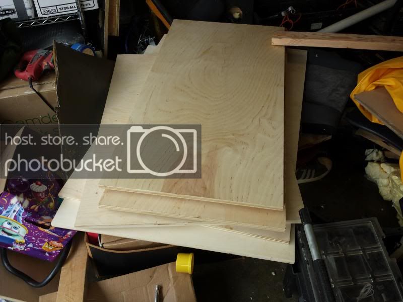

2 pieces of birch getting ready

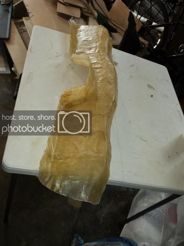

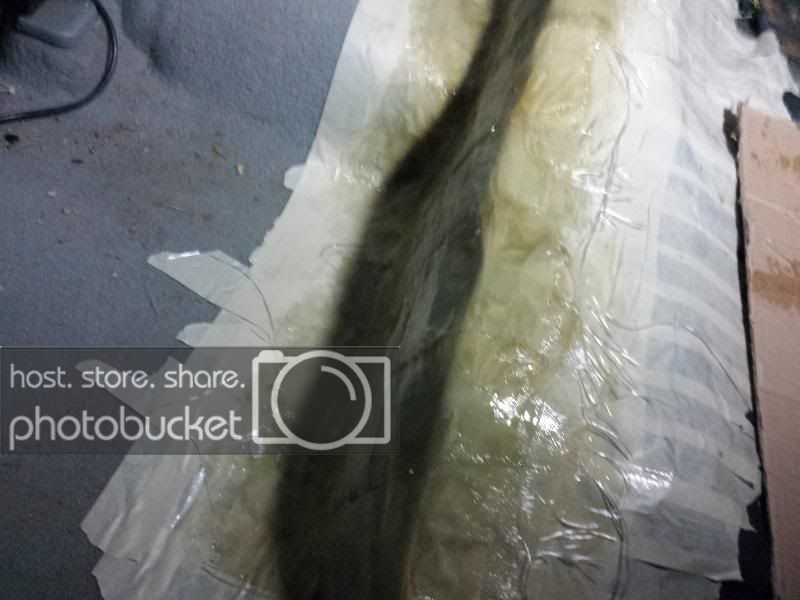

Started my first mold.
After 3 layers i pulled her off. Not bad for my first time ever glassing huh? //content.invisioncic.com/y282845/emoticons/biggrin.gif.d71a5d36fcbab170f2364c9f2e3946cb.gif 4 more layers and this one will be done then on to the next one. //content.invisioncic.com/y282845/emoticons/smile.gif.1ebc41e1811405b213edfc4622c41e27.gif

Pics of the car
