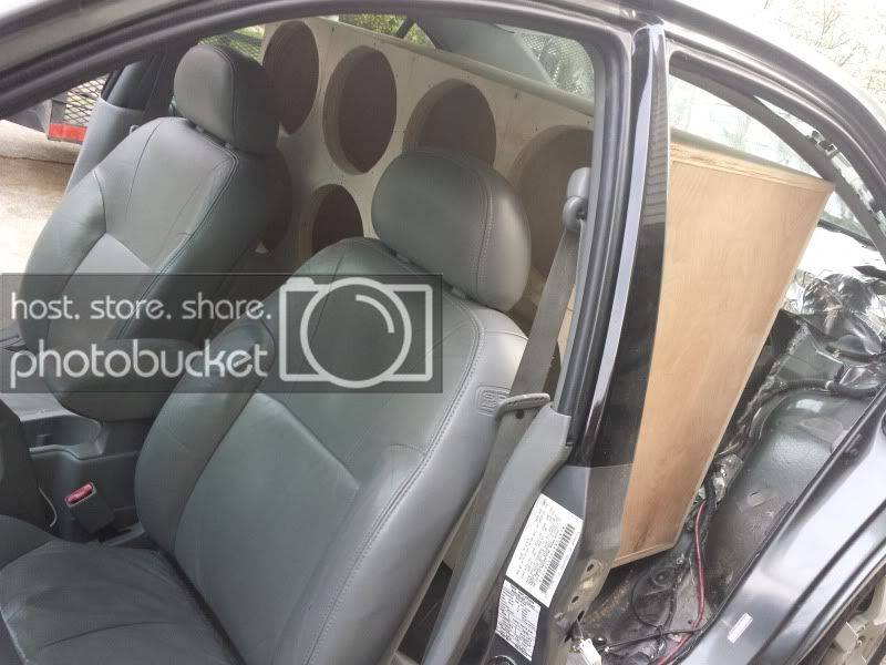

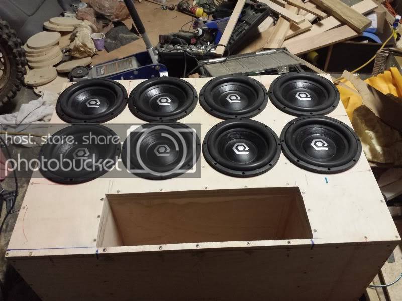

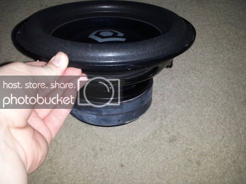

Galant wall, 10 obsidian 10's ported 2 7kw amps. ;)
If it's not a burp box why the 40hz tunning?
Because itll still play low. Every other setup ive done with aq has been tuned to 38 and peaked around 36 or so. I dont forsee any phase issues, ill have all 8 subs mounted above the port with the port on the bottom. Nominal load will be .5 ohms, going to be running one big amp for now. I will test it on my brothers crescendo 5500 then hopefully get a ct sounds 7000.

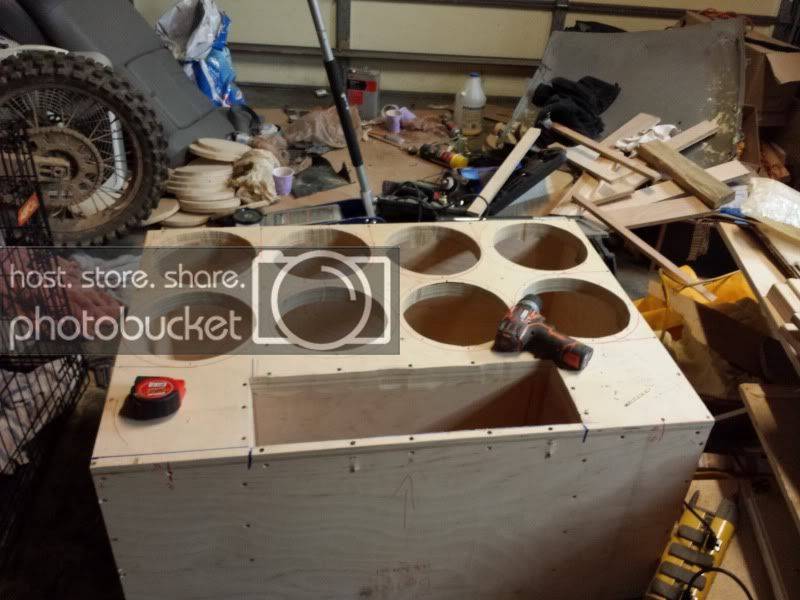

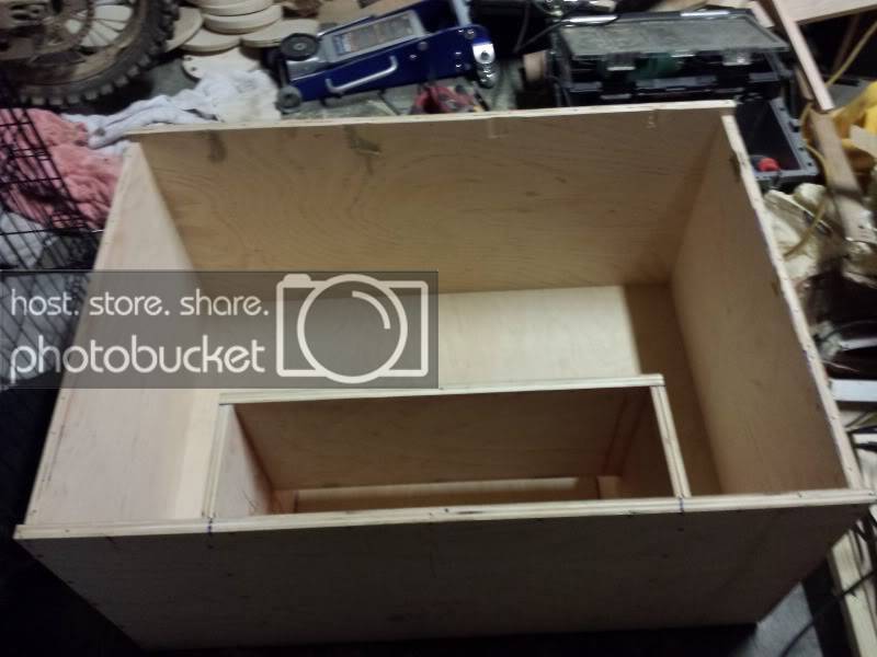

Its very very close on space, each 10 will see 1.2 cubes net tuned to 40hz with 21.375" port area. Im guessing this setup will do a 153+ easy in the high 30hz range at the headrest. I helped my friend do a similar build with 5 sa 10's and it was doing 151's at 35hz with 3kw and the wall not fully sealed from the back of the car.

thats just insanity in box!!!!!!!!!!!!!!!!
Lol it looks intense. I got the box in the car after i took my door off. I got it hooked up on a kicker 200.4 and honestly it was pretty loud not even sealed off at all. These subs are very efficient. Even on like 30-40 watts a piece they were movin. Gonna put a saz 3000 on it tonight and hopefully itll bang. //content.invisioncic.com/y282845/emoticons/biggrin.gif.d71a5d36fcbab170f2364c9f2e3946cb.gif
thats awesome you will have to get metered sometime i have been hearing a lot of good things about those brand of subs and thats what im shooting for. i got a DD right now its pretty good just need a better amp.
Yea, ill get it metered. Just got the box screwed down with brackets, glassed the box to the bottom mold, and im working on glassing the sides. They are gonna be a *****. But its gonna look bad *** //content.invisioncic.com/y282845/emoticons/biggrin.gif.d71a5d36fcbab170f2364c9f2e3946cb.gif

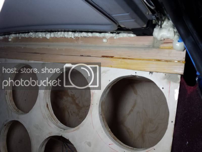

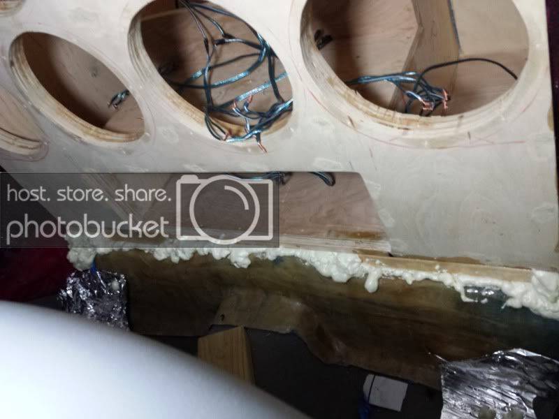

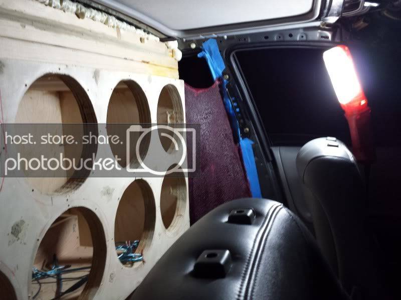

Boom put her in the car by myself. Birch FTMFW.

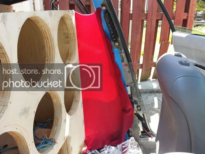

Ready to glass, fleece is stapled to the box then hot glued to the tape on the car.
glassed
Roof done besides beauty plate
floor sealed besides the edges im gonna seal with the flush false floor.
getting closer, on the passenger side i got 1 layer of glass down and **** is solid. gonna do 3 on each side then glass a 2x4 on the back and the sides will be done.
