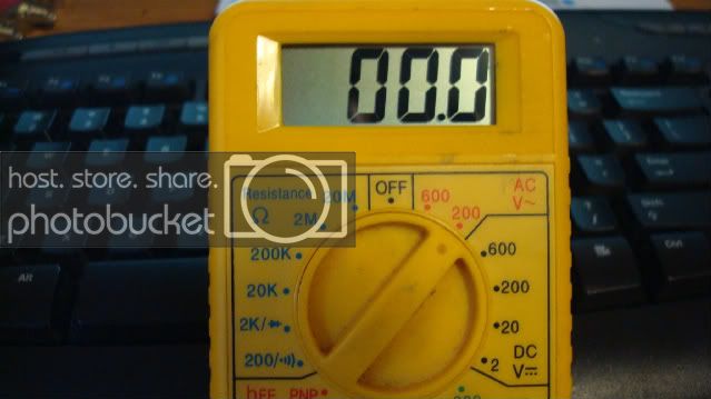

This is the thing.. I did everything that tutorial asked me to.. Connect everything in the right way,dissconected speaker cables,inserted a 50 hz tone,set the volume on 58,and when i conected my DMM to the speaker terminals or whats it called it was 0,00 or 0,01
There is nothing wrong with the DMM,becouse when i put it on the power cap it was reading 14,4 V.
After that i dissconected everything and connected my other amp,for the highs. Inserted the 1000hz test tone,and.. SAME THING.. DMM isnt reading ANYTHING! No changes.

After that i tried to measure my brothers sub,i removed the sub,and put the DMM on the sub wires,and same thing! 0,00 - 0,01

Turn the DMM to the AC (200) setting. or a similar voltage.
did you accidently put the DMM on ohms while doing this or reading any other current? i think you blew the fuse in the DMM it's self.. you can replace it, only costs a few bucks at radio shack or something, open the back of it and find out, cuz usualy when you read ohms while there is live voltage going through, it will blow the fuse
First it was on 200 AC and then on 200 DC and it was the same..
And when i connected it to power cap,instatly it was reading 14,4V on AC..
I really really dont get it.. Dont get it at all!
