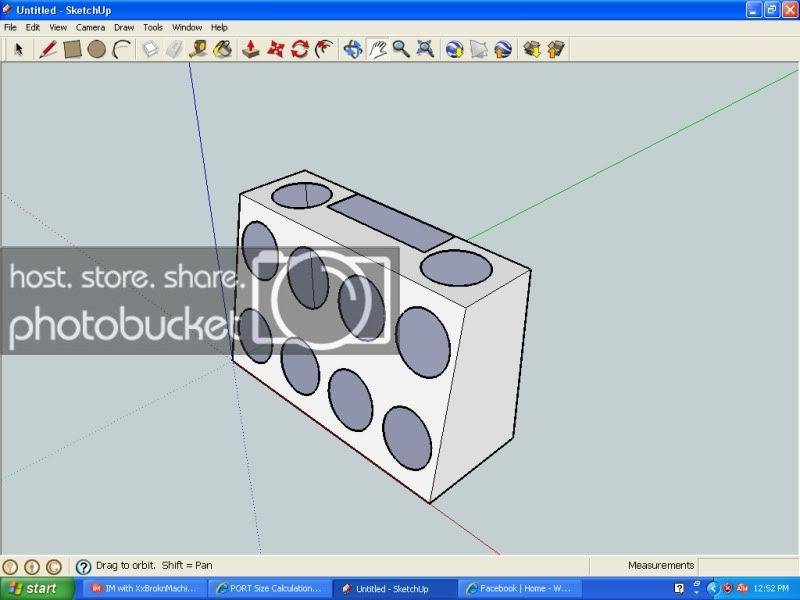

Well, Tired of my ghetto half'assed systems. Not going crazy blow ur mind loud on this one but i am going to do it right, nice and clean. Im planning on a low wattage, high cone area build. This will be going in an ext cab colorado truck. Not a wall but close to it, no blow-thru. It will go about halfway up the rear window. Box before any displacements will be 14 cubes. Im planning on putting around 1500 watts to the subs MAYBE 2000. Can anyone suggest a sub to use? Will be 4x 15s. So far i have my eye on Alpine Type Rs and RE SR's. Both would fit in this box and do very well on 1500-2000 watts. The SRs are almost half the price tho.

Lemme know if this box looks fine please and thanks.
Before port displacement and after sub displacement..its 12.2 cubes. The port is 22x7" for around 150 sq inch of port. This box will be housing 10x RE10s pushing about 1500 watts thru them.
Interesting to say the very least... look forward to this actually being built hopefully.
Build log will def come but wont be starting this build for another month or 2 atleast. Def wanna get all the kinks out before I start ofc. Bracing is what im stuck on at the moment.
