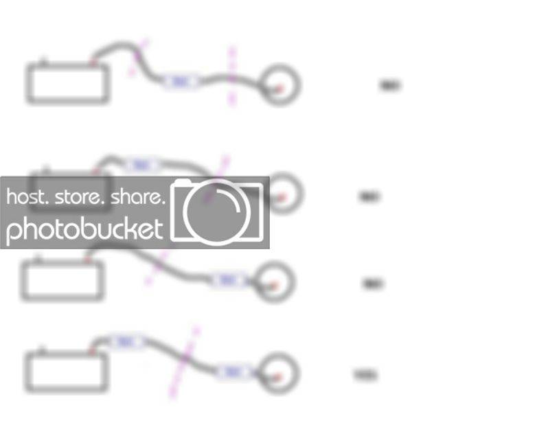

heres a little diagram i just made
the purple/pink line represents a cut/fray/fk up in the wire causing a short
btw, teh square thang is the battery, and teh round thang is the alt for the slower people
