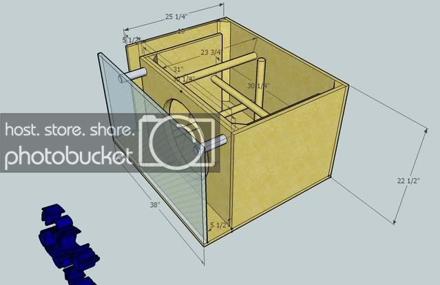

this is what i had, going off the idea it needed to be atleast as wide as the port
It doesn't have to be wider than the port. You can cut it down smaller without any ill effects. You will notice bad effects when you don't allow for enough exit surface area. In your case, make sure the exit area is about 1.25-1.5 times the Sd plus port area.
