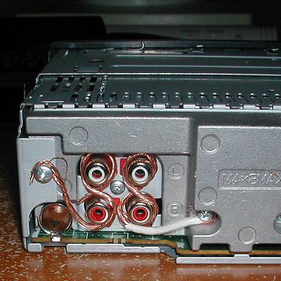

you do know how to ground the rca's, right?
(similar to this)
