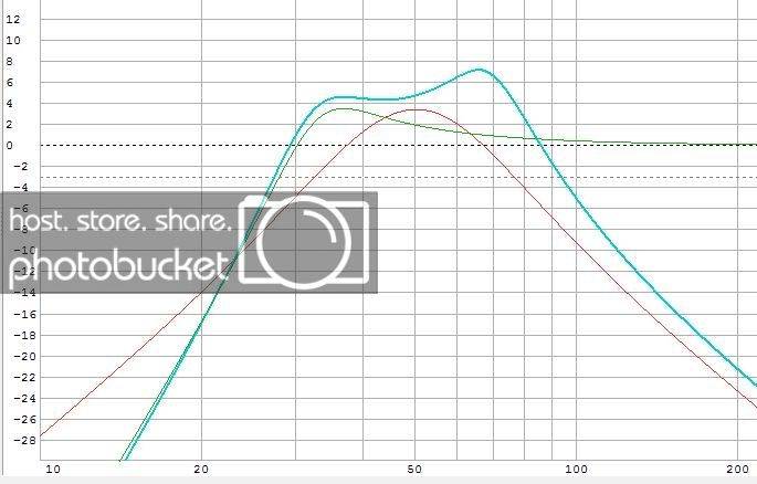

I modeled v2. I could not get a good result with 4th order bp. very peaky, one note kind of thing.
I modeled 6th order also. Much better, this could work well. If you can use a very long port. . I' ll post pics this afternoon, as I am heading out now.

Ok so I found a second. LOL
red is 4bp
blue is 6bp
green is Vented.
