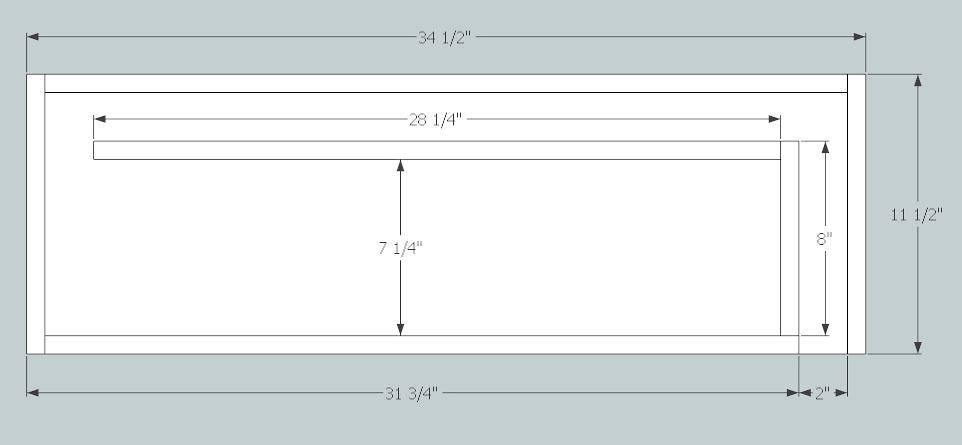

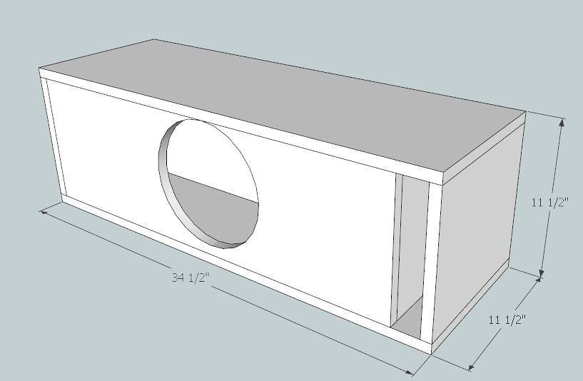

I've gone through the how to sticky on calculating port length, so I have that now, as well as the dimensions of the enclosure. This has left me with 2 questions:
1. Can someone look over my #'s and make sure they look right, and:
2. How do I actually translate the port length into the box, lol
The dimensions:
34.5"W x 11.5"H x 11.5"D Just a rectangular box. Port size is 10" x 2", and the calculator gave me a port length of 48". This should leave me with roughly 1 cube for the sub, a port displacement of 1.31 cubes, and a total internal volume of 2.41 cubes. Tuned to 33hz
View attachment 26529578View attachment 26529579
These are my extremely rough ms paint drawings, lol. Can someone tell me if I'm headed in the right direction here?
