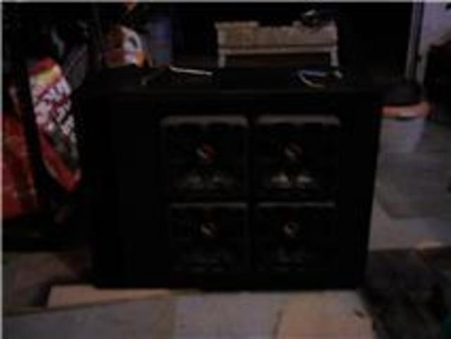

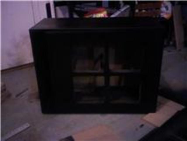

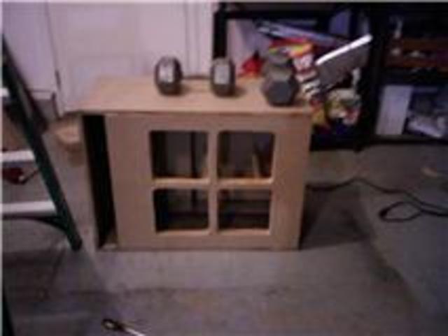

lol already almost done with my second box i only had like 36 sq in of port for 7+ cubes. I now have 91 sq in on a slot port design with 6.3 net cubes tuned to 31.6 hz. I also used 2x4's for bracing on my first box and now am using 3 1.25 in dowel rods for less turbulance. Box is turning out a lot better then the first just because I took my time more and lined up all the screws to prevent splitting. Another thing I did was for the sub cutouts I had it so when the grills are on the subs they all fit about 1/32nd of an inch apart so It looks a lot cleaner. Amp will be in this week, and the components, alt, and hu will be in in around a month or so.
one brace is going in the center, the other on the center of the 2nd length of port and the other to the right hand side. I just dont want this box to end up falling apart on me. I will paint this like I did the first box because I tried another brand of "stone" texture on my most recent fail and it didnt look near as nice as my other box aesthetically speaking. I cant wait to have teh dbz in my truck again. But my mids and highs have been SCREAMING since my most recent tuning. I just need a foth speaker amp for my stock speaker locations. Pry just end up doing a 2 channel to my infinitys in the door and leave my rockford 5x7's on hu power seeing as though they are so drowned out in the back with the box/batterys/wiring.
so after an hour with the cutouts using a hand file and sand paper I find out my dad had a dremel this whole time. Ended up taking me 10 minutes further with 2 subs to go and prefecting the other two. Front is double baffled and I braced it using 3 1.25in dowel rods on the second length of port, and bracing along the front.
Almost done with the paint just another coat of black and a clear coat. I also used a different brand of paint for my second box, but i liked the final texture of my first box so I went with that and this box is looking sweet. will have pics up tonight,
ill do one better Vids. But i just have a 3.2 megpixel camera on my phone. I just need to get a digital but the terrible pics are just to show that i am making progress. I am building a buddy a free box for 2 12" w6's just to get some references out there. Thinking about tuning around 30-32 hz with 3 net cubes. He is the one i sold my 2006 md1d.
