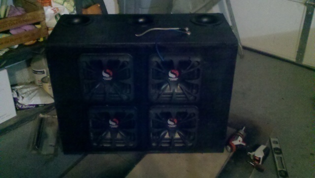

I already built it, but took your advice with the double baffle and aero ports its 37x27.5x16.5 and after displacement is 7.45 cubes so the 3 4" ports will be cut to 9.6 inches tuned to 33.1 hz
I'll snap a few here in a second. It doesnt have the top peice on and because the ports aren't in til tommorow and the cut outs are crude but the subs fit right in with a nice tight fit.
no they aren't "crude" just the top right sub is like 1/8th of an inch off from the others.
sorry for bad picture quality but you get the idea when its all finished up I will get pics with a digital camera.
It will I have a good feeling. I took my time and double triple checked my math to figure exact displacement. precision ports also has a nifty tuning tool.
got the ports and top piece all put together the only problem throughout the whole box was deciding to switch from cordless screwdriver to a power drill. I ended up over torquing and it cracked the top front right hand corner. Since its double baffled it will still be sealed plenty fine. Just got to finish up the paint(ran out of stonecraft tonight) and another tube of silicone for the aero ports. The final tuning is 32.8Hz
