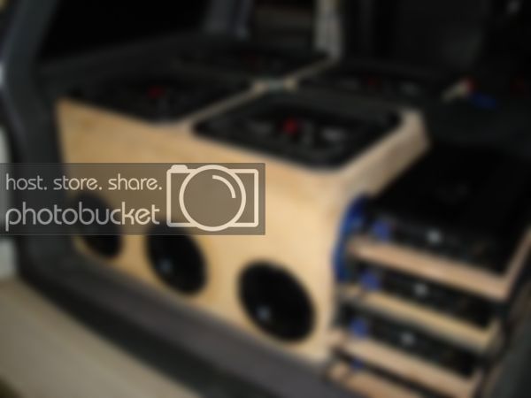

Yeah they're loud, here's a 154 @ the head rest. Probably does another 2-3 dB's in the kick.
thats not under windowline
It would be in a biggggg mod class in any org....except GAY MECA apparently....haha
This is though...and in Street C....so 1 batt in the rear :
156 legal on dash
Not mine though
