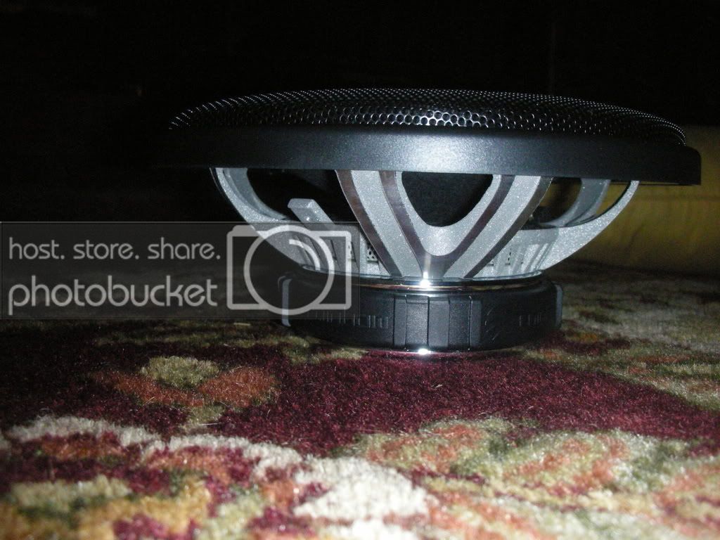

They and the Profile Ap1000 are being replaced with this 2008 Rainbow SLC 6.5" component set and Sundown SAX 100.2 two channel amplifier. I hoping with the new baffles, and deadening material, that it sounds really nice.
The midbass, whooo..

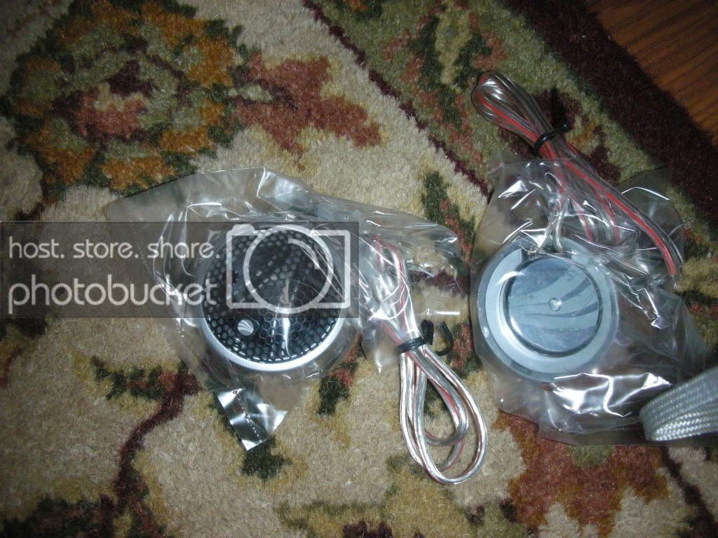

The Cal25 tweeters, these things are tiny!

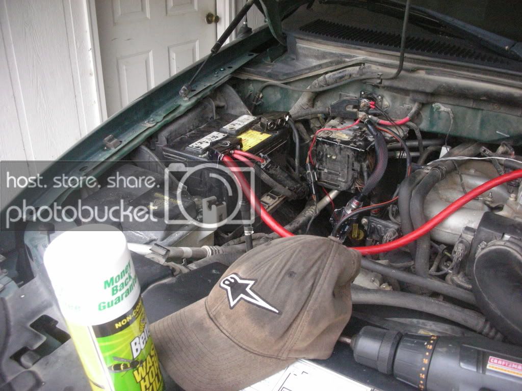

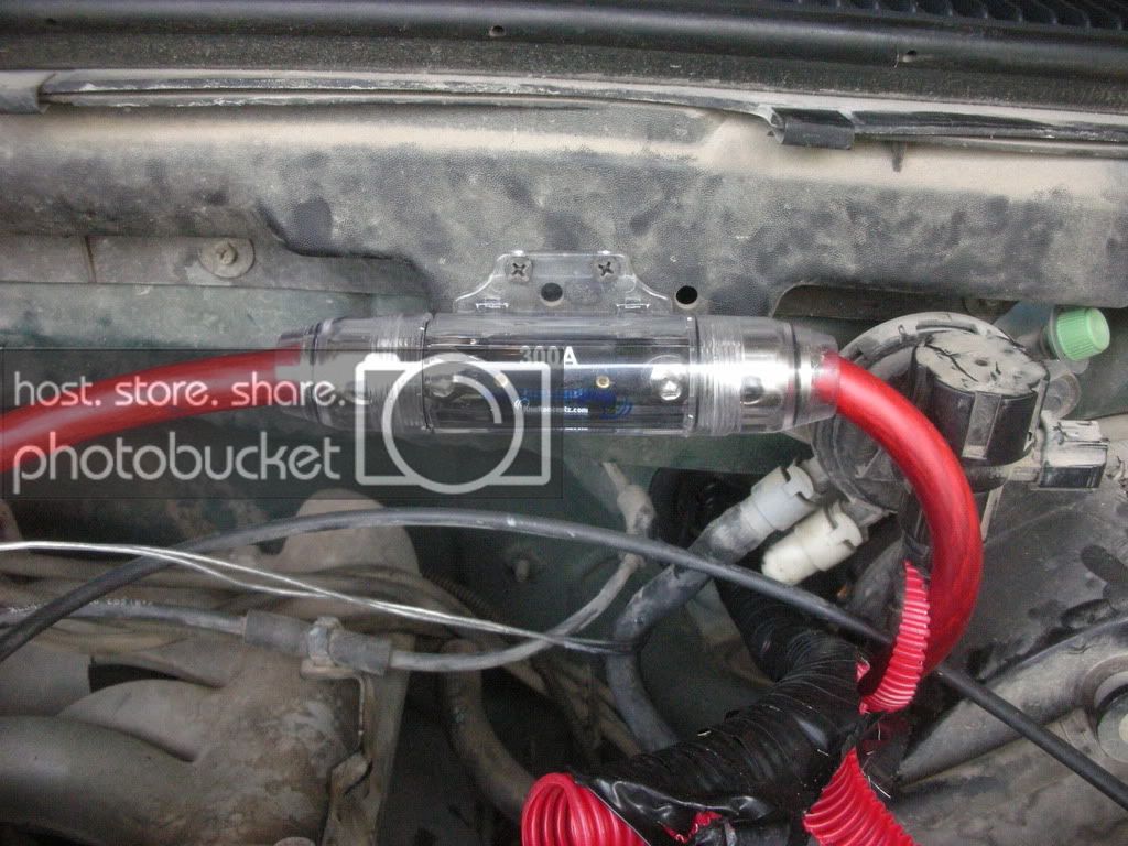

I am working a very slow pace, hitting certain areas at a time, and right now I am working on the engine compartment wiring and eventhough I finished the fuseholder wiring wednesday night, I just wasn't happy with the presentation of the exposed wire on each end of the fuseholder and also the messiness of the split loom so this morning I managed to re-install the fuseholder(pain in the ***) and eliminate most if not all of the exposed wire. I also got rid of the split loom and I will either leave the wire like it is and tuck it a little bit or I tech-flex it.
I also better secured the fuse on the fuseholder.

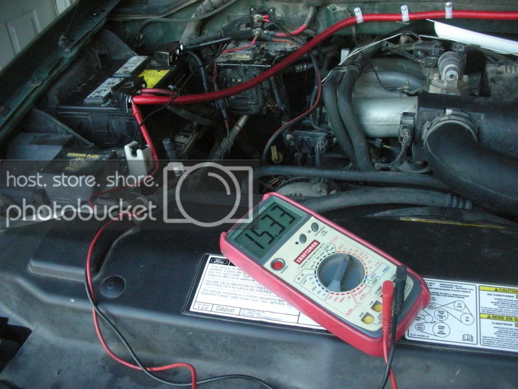

I decided to see how the connection was so I took the DMM out and reconnected the negative terminal to the battery and measured the voltage. Without the engine cranked I was reading 14.5v(rounded to the tenth) at both the battery, relay switch, and the end of the fuseholder, I then cranked the engine and it increased to 17v.

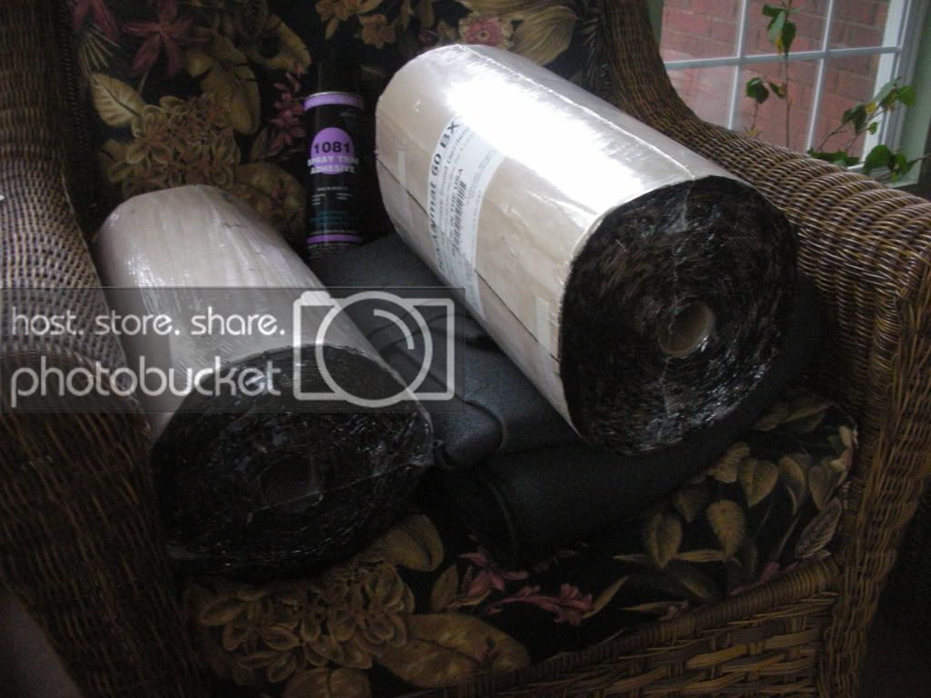

Yay my deadening came in!

The changes I made to the fuse holder to get rid of excess wire. Looks a lot cleaner.

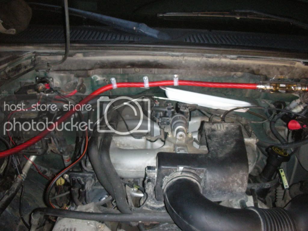

This is how I am going to try and mount the power cable in the truck to keep it from draping over the engine or swinging. Just a temp. setup, I'll tech-flex the wire, uniform the screws, make it look a bit better.

Thats with the vehicle initially cranked.
And a different DMM, that voltage dropped down to 15v.
With the vehicle not running, it read 12.5v.
