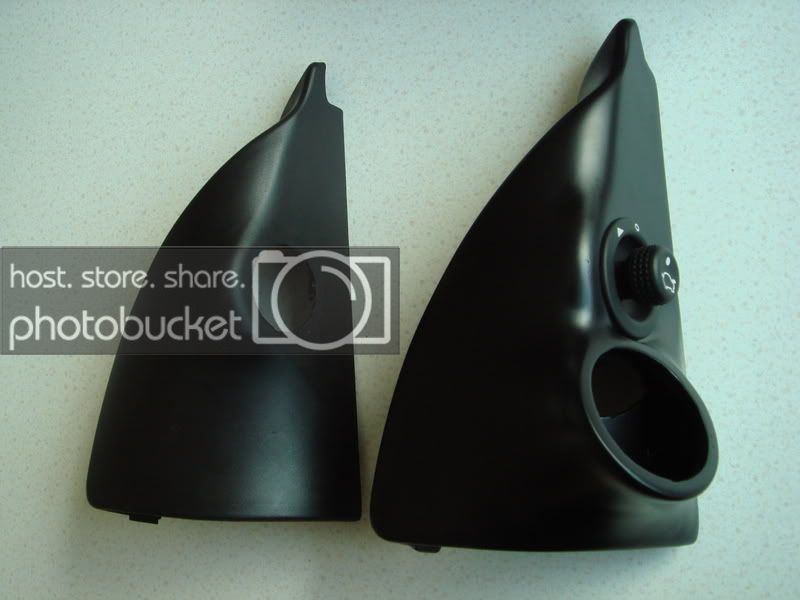

Showing comparison between original and new pods. I bought some more pods from a scrappers and so the untouched ones are the ones that came with the car:

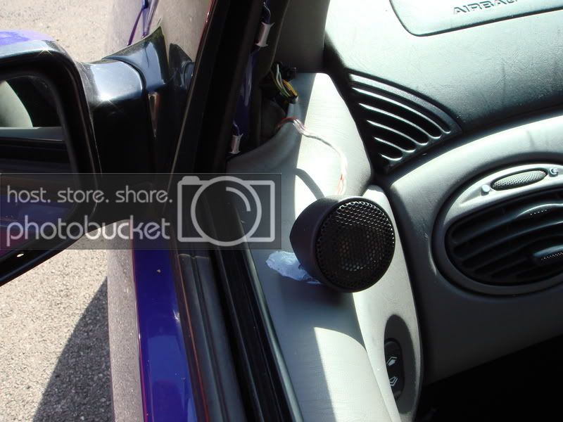

Few photos of the setup Ive had for the last few weeks:

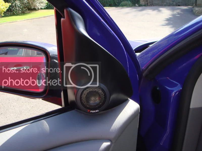

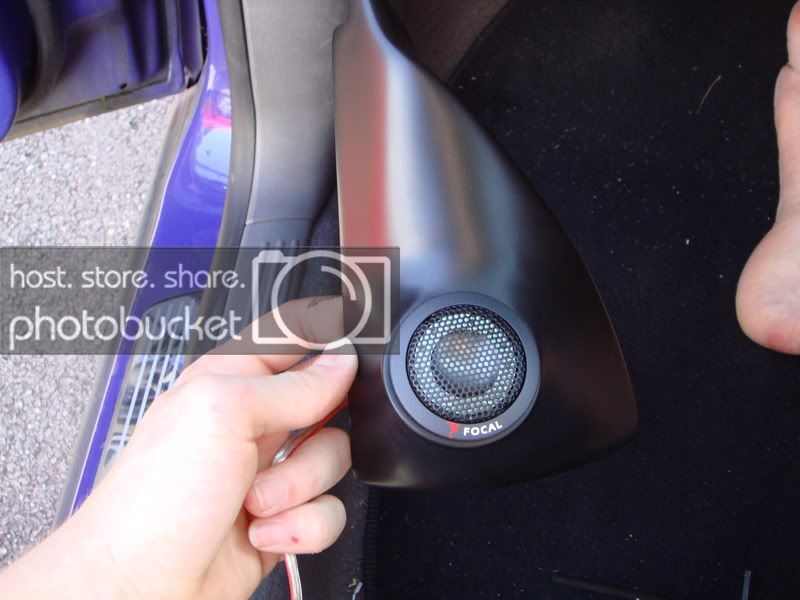

Passenger side tweeter in pod:

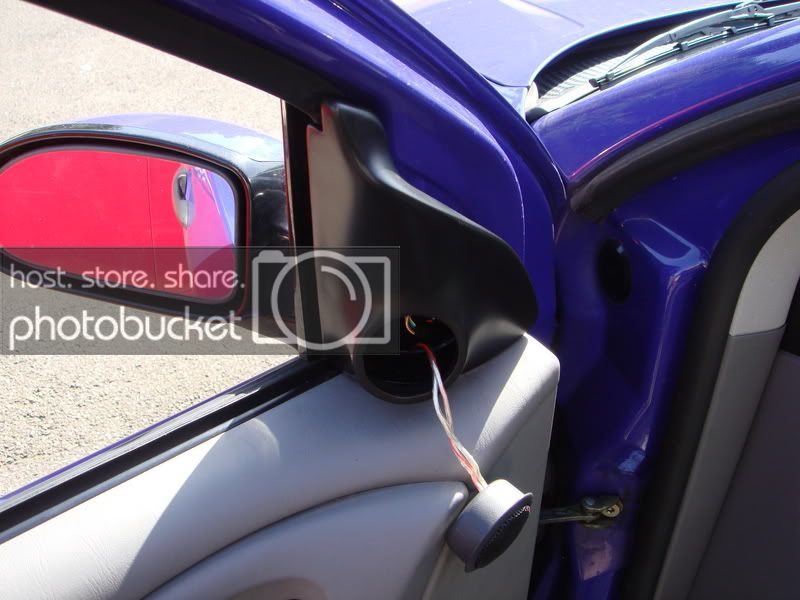

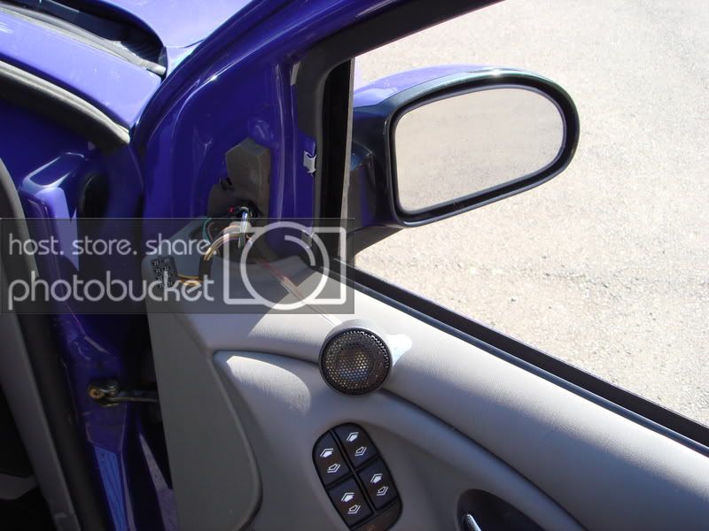

Pod installed in car with tweeter ready to fit in:

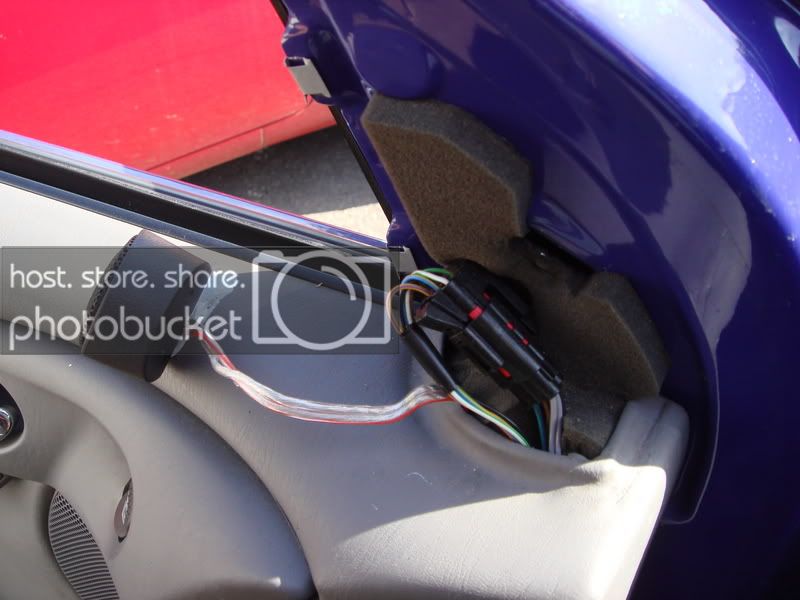

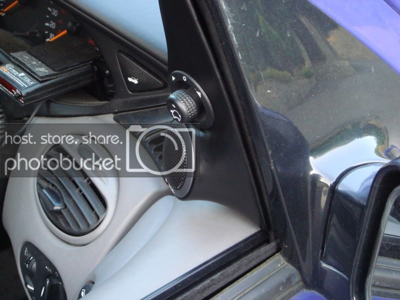

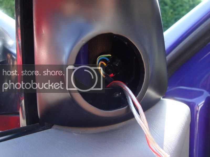

Showing clearance on plug/socket for electric mirrors:

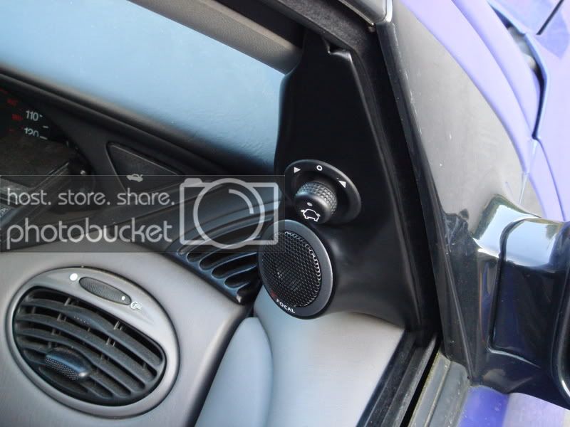

Fitted:
View from the drivers seat:

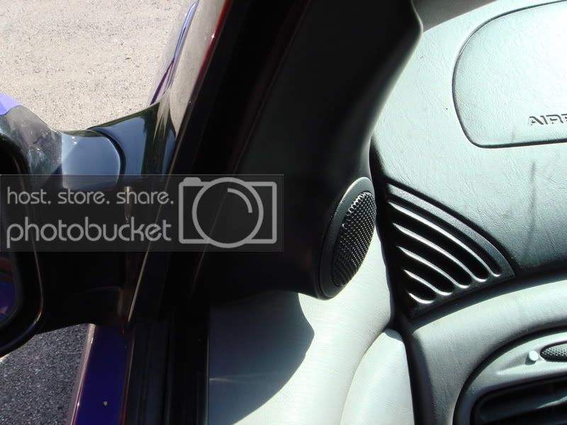

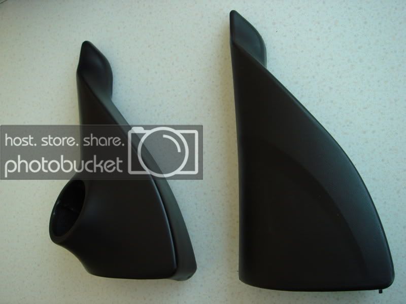

Drivers side comparison between new and old:

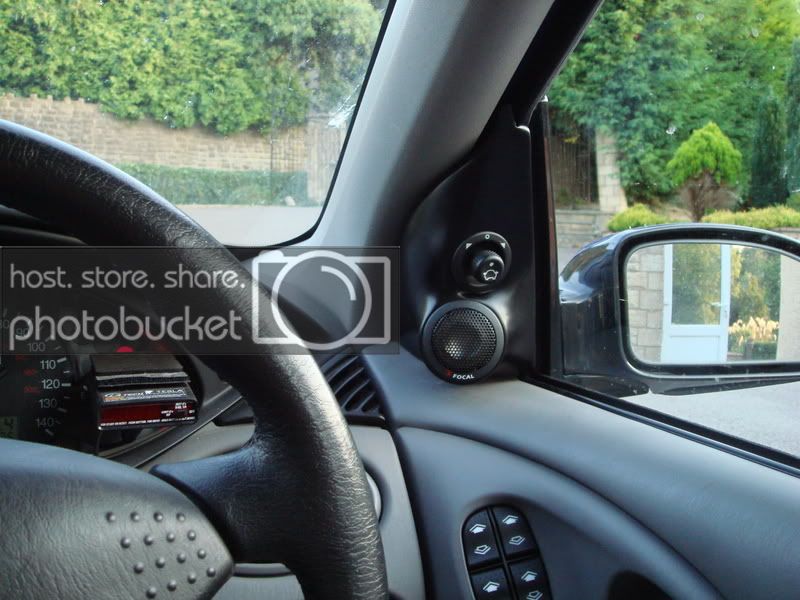

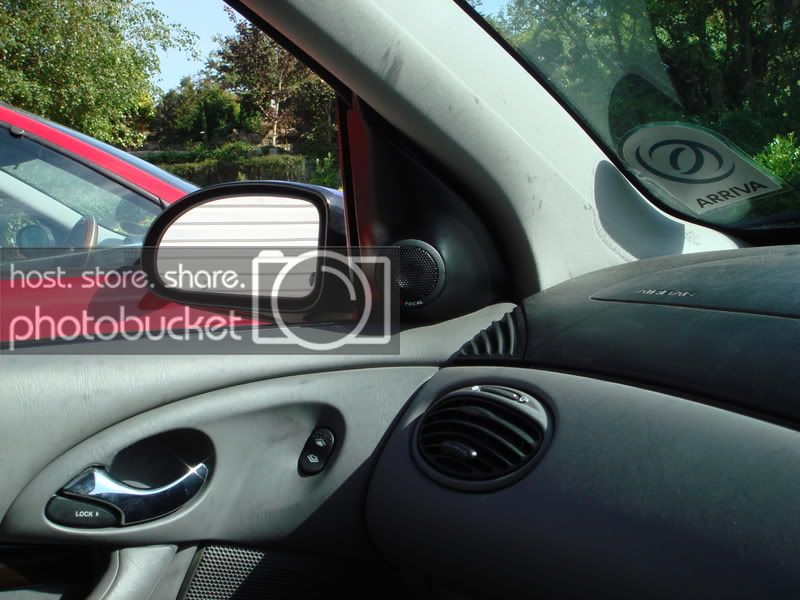

Installed - from drivers seat:
Other angles:

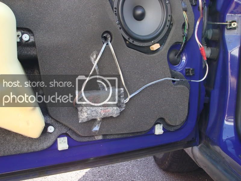

Couple of questions:

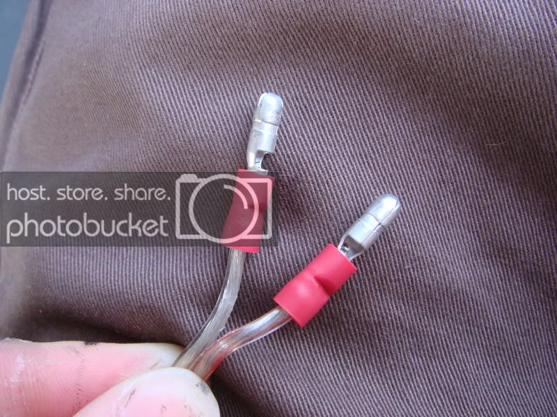

What do you think to connecting speakers/crossovers together with bullet connectors, like the ones shown:
And do I need to unwrap my crossovers out of the bubble wrap they came in, I left it on to protect them, but I heard that they can get hot???
