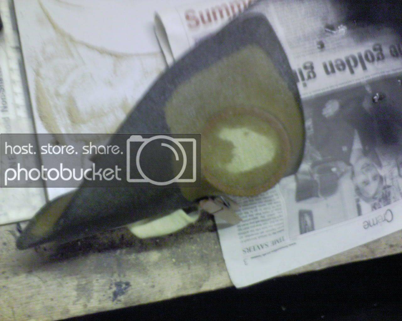

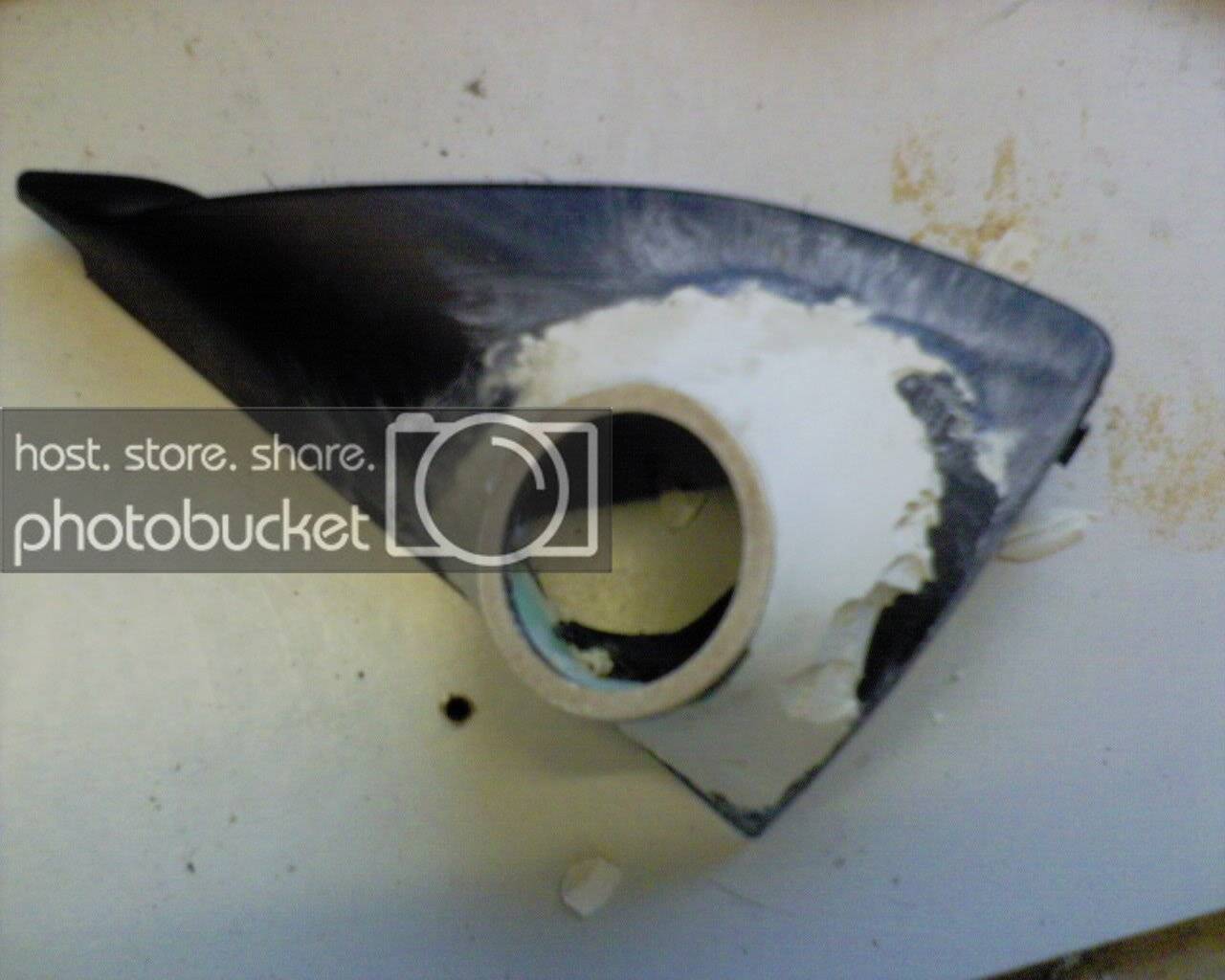

Removing filler:

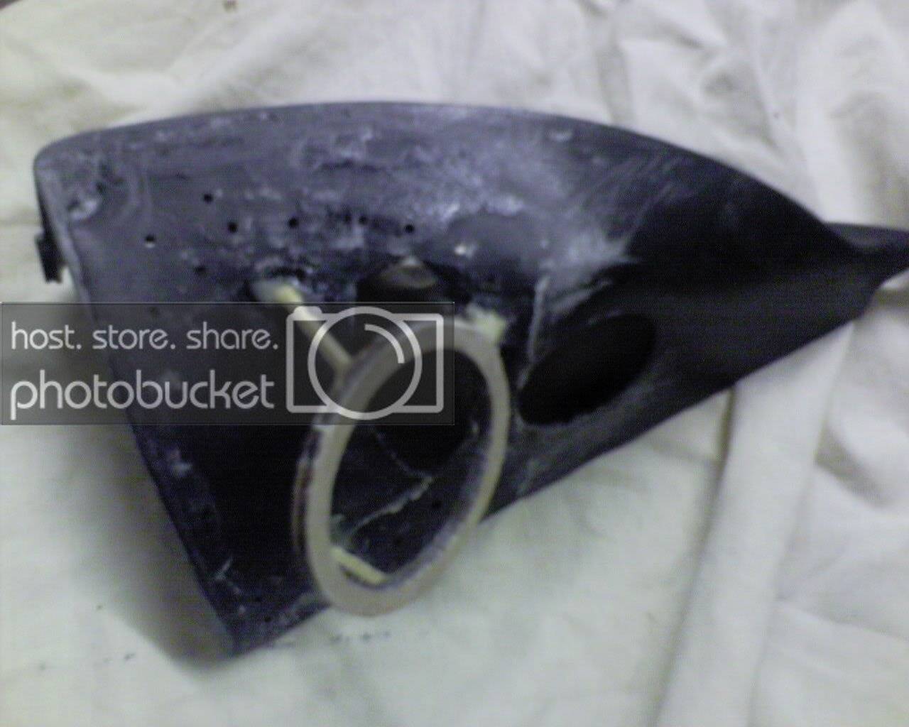

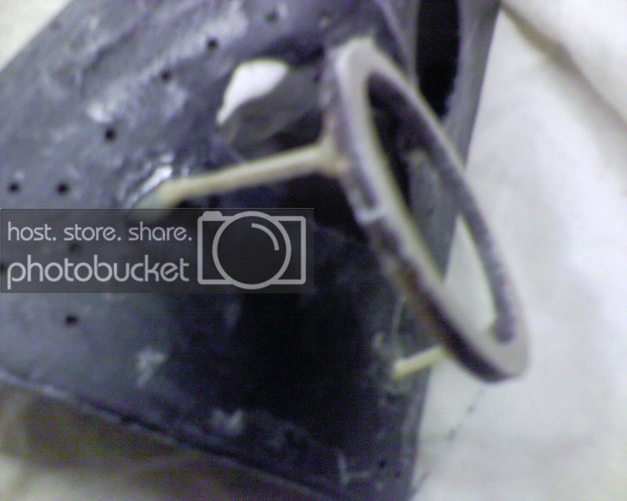

Filler removed. Back to mirror casings with laser cut MDF rings supported with matches:

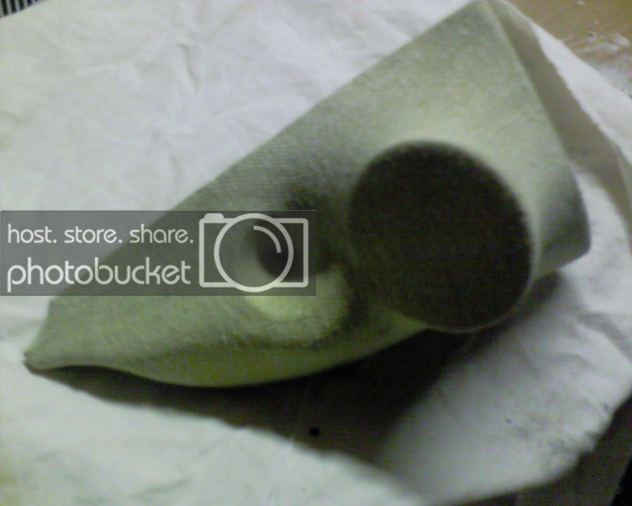

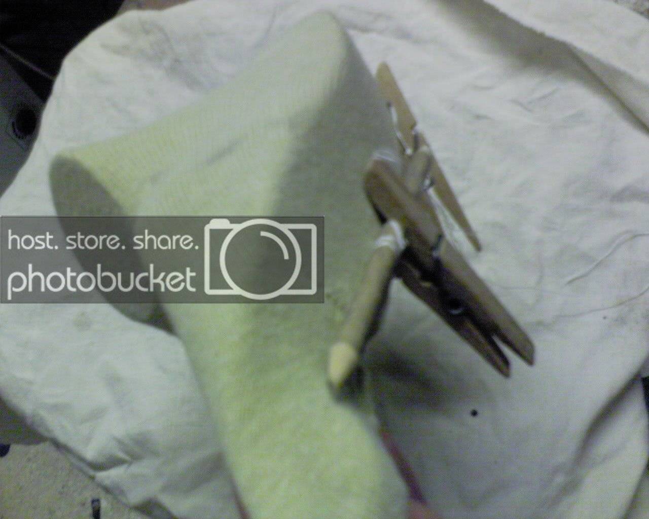

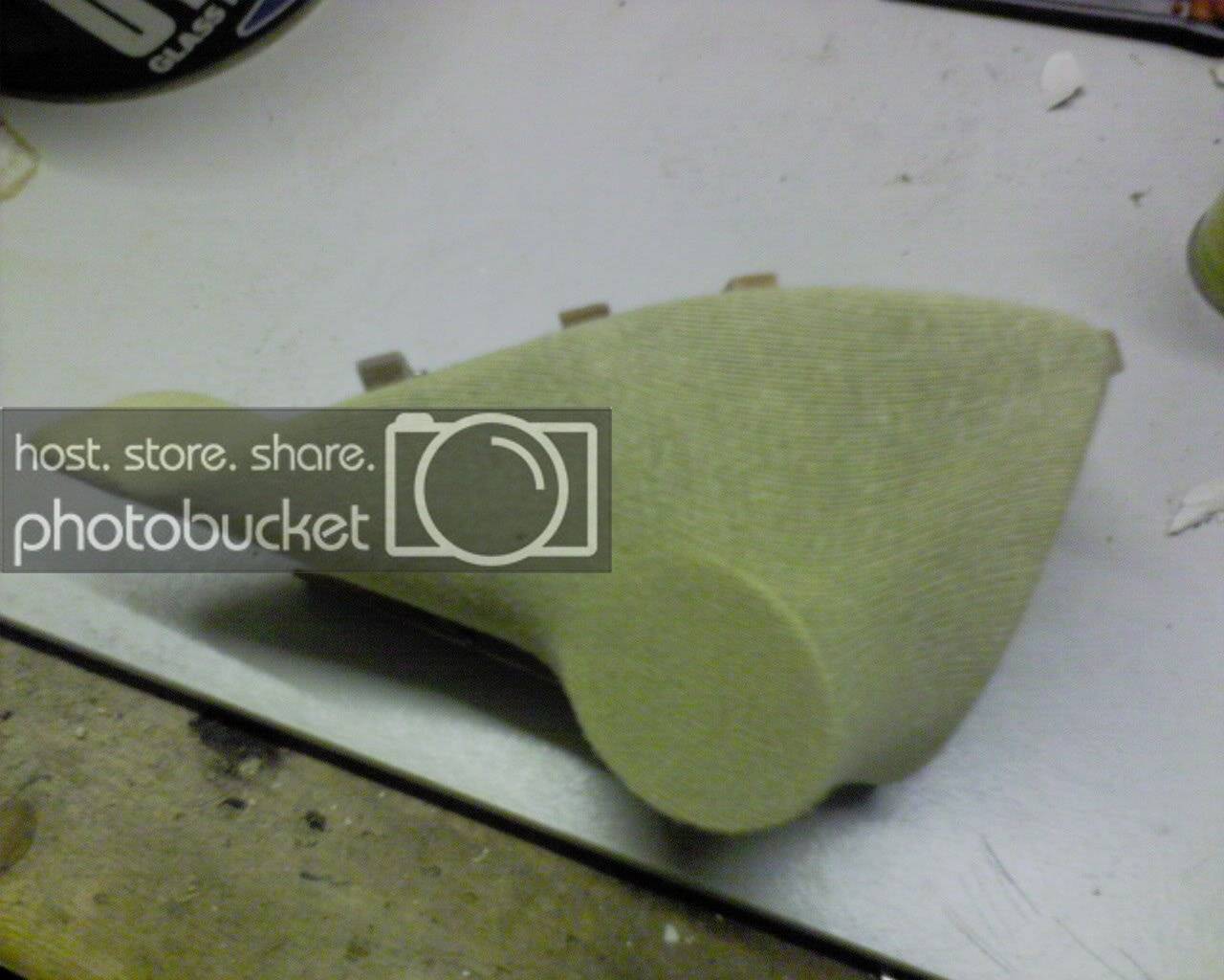

As I didnt have any proper fleece and didnt want to go out and buy some especially as I didnt need a huge amount i looked round the house for something. Ended up using socks as they were nice and stretchy and so easy to get the right shape.
After first layer of resin:

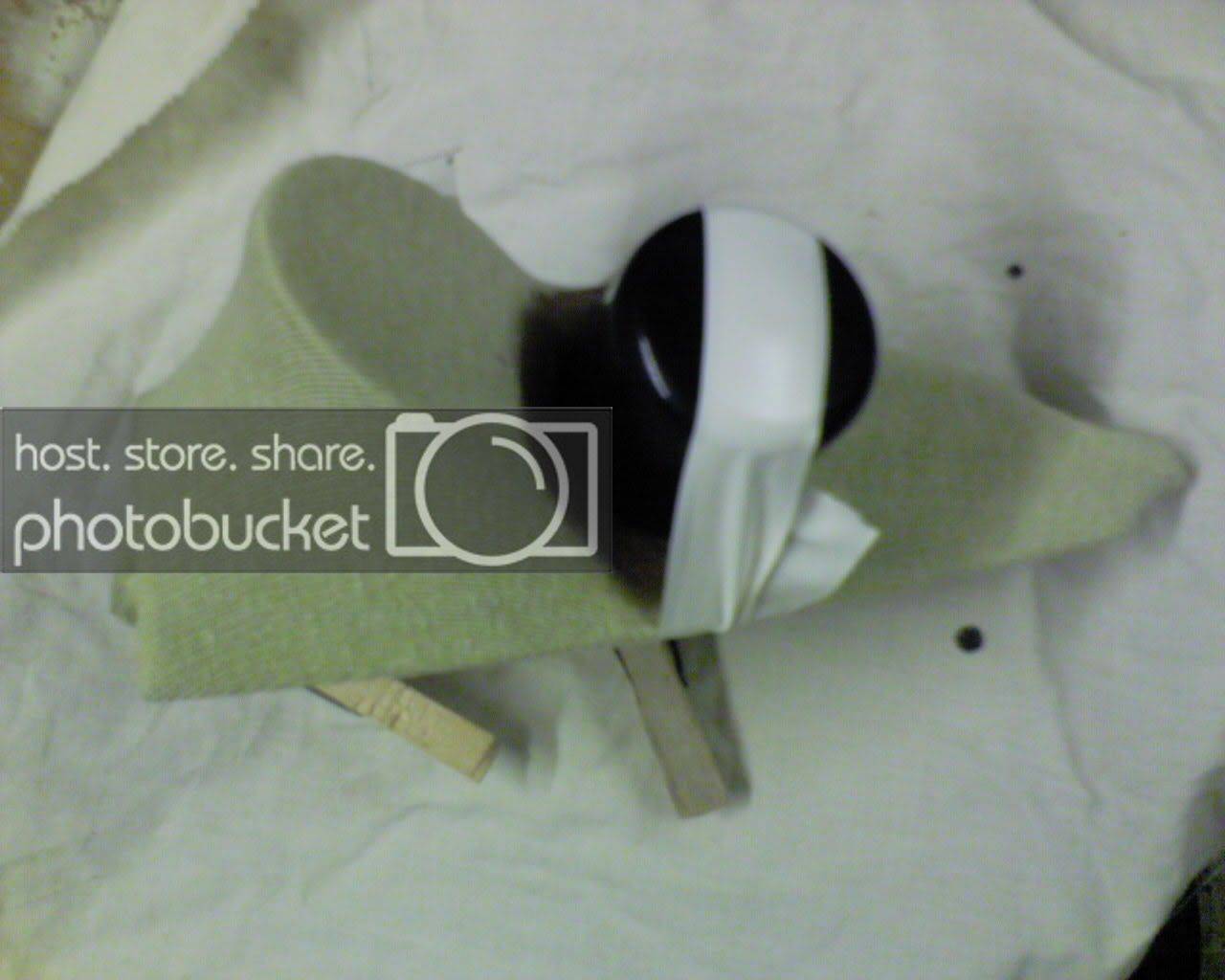

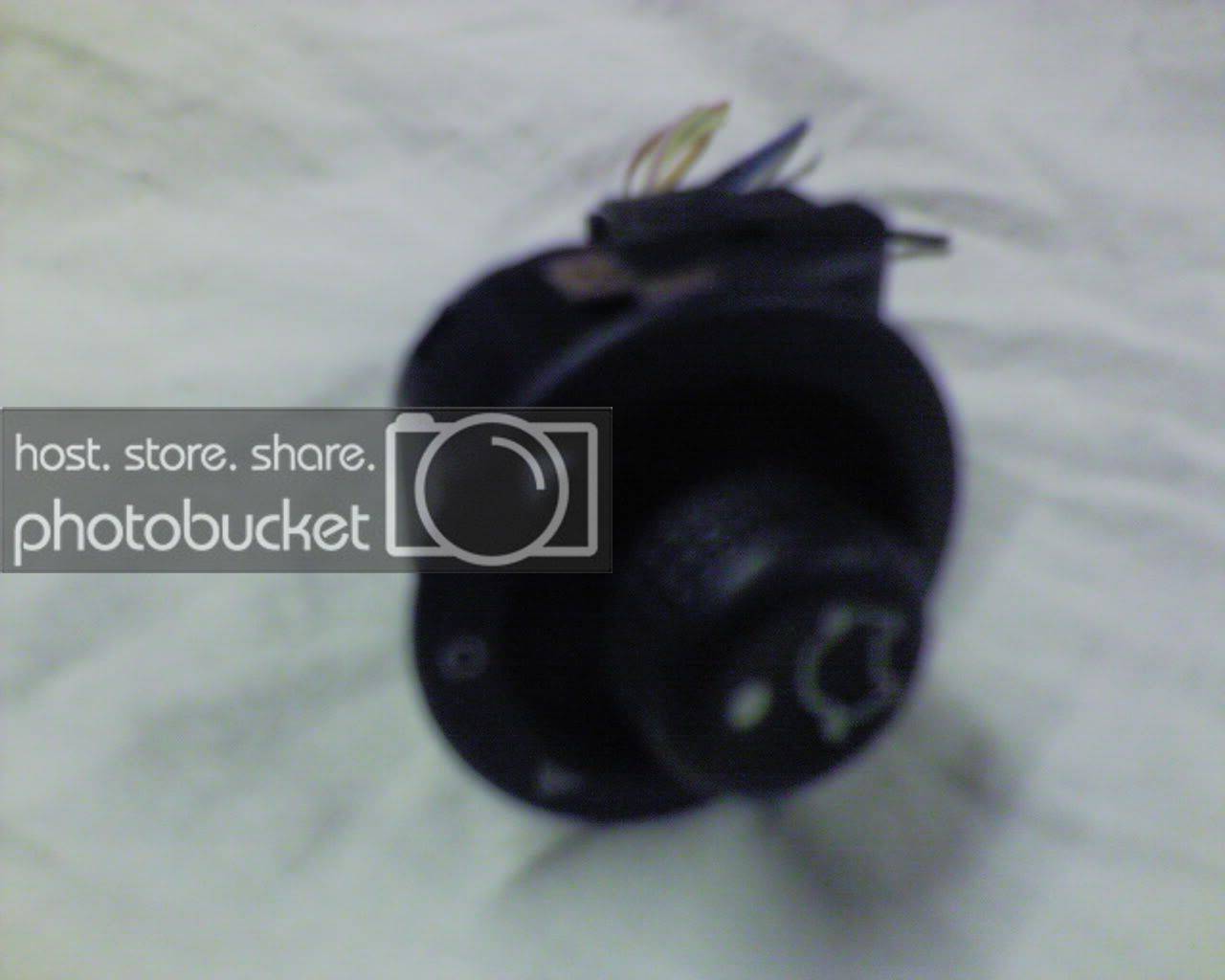

Drivers side casing contains a joystick for moving the electric mirrors. Pulled material down into hole using some cotton through it:
Joystick:
To ensure area around joystick was flat a lid was taped on to hold the cloth against the plastic of the mirror casing.

Got 3 layers on them now.
Havent been putting glass on, just the resin.
Im thinking one more will do. 4 layers or resin enough???
I sanded them down after the first 2 layers and got them nearly perfectly smooth. Going to sand down again and put another layer on tonight and then hopefully tomorrow I will sand them down completely and they will be flat enough to paint without any filler. We'll see though...

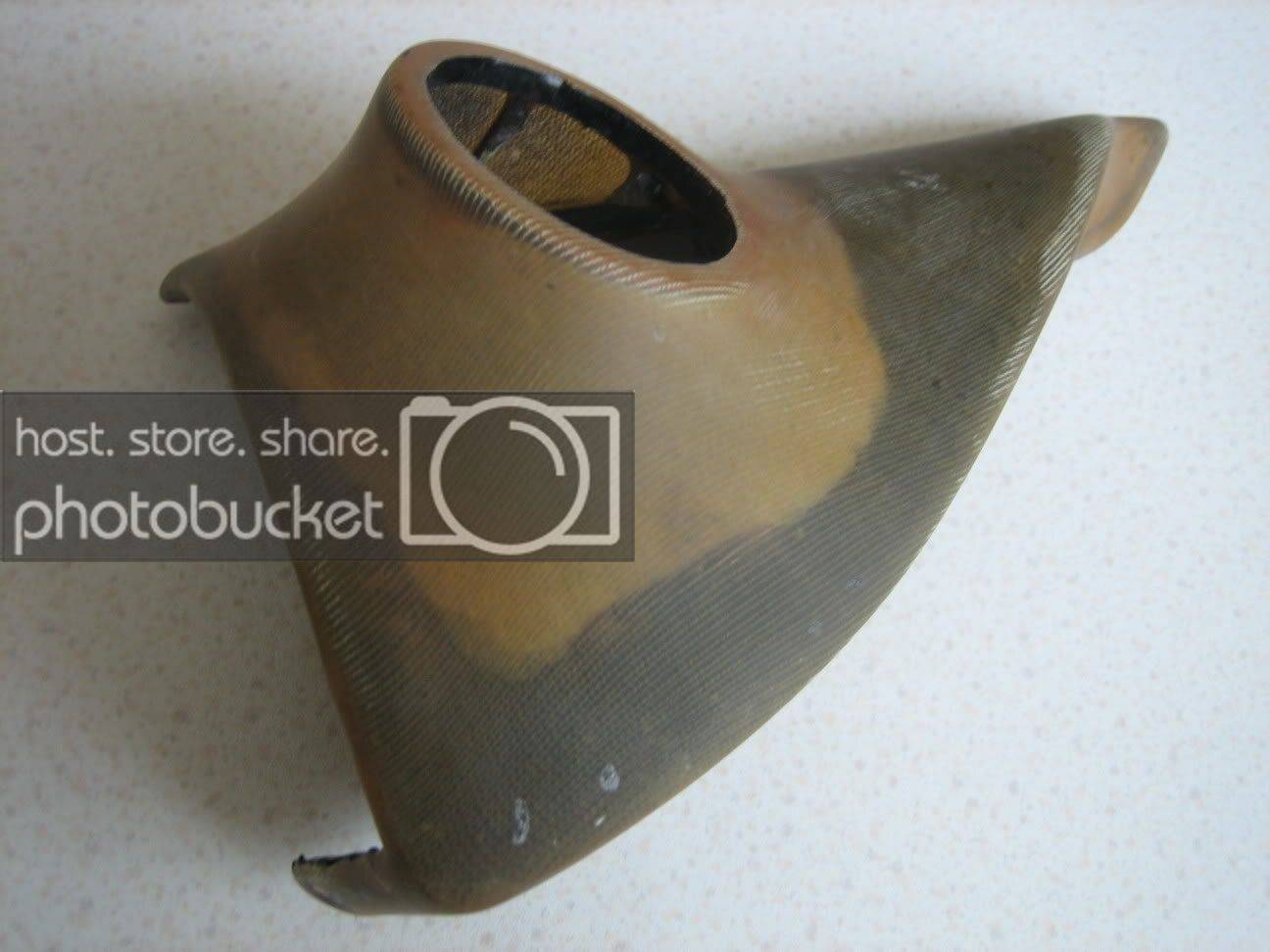

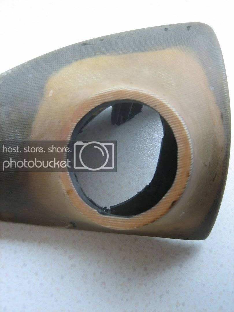

Drivers side pod after rough sanding of 4th layer of resin:

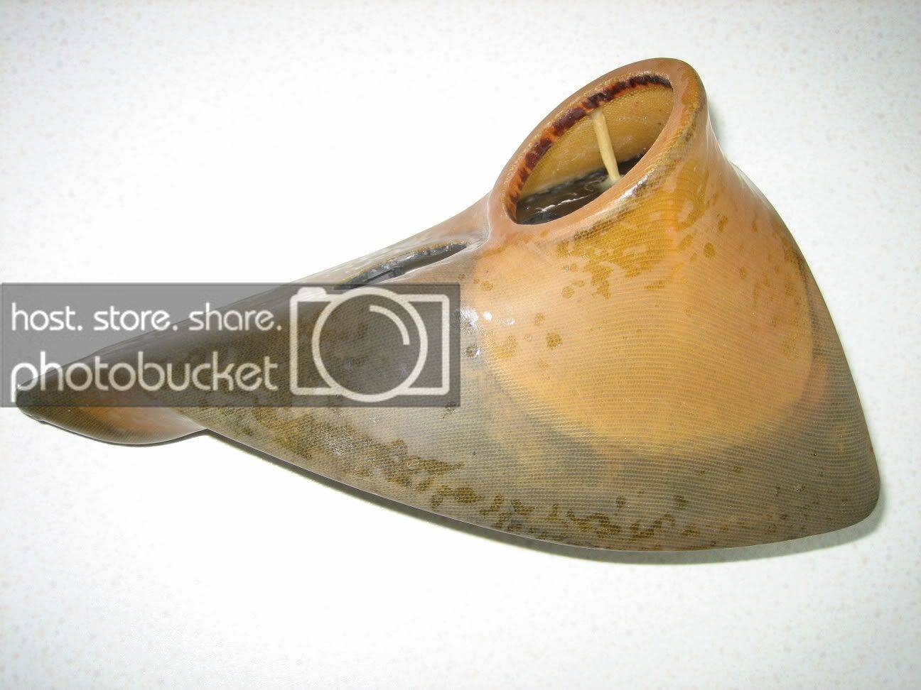

Passenger side pod after final 4th coat resin sanding, ready for paint:
Another view:

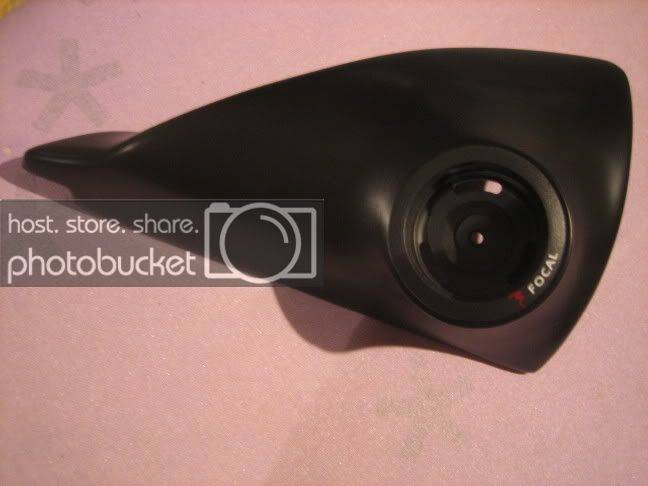

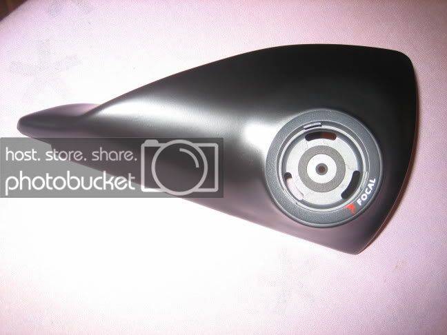

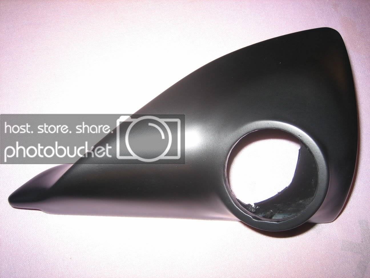

After final coat of paint. After doing 2 coats I decided the finish wasn’t flat enough and so sanded right back down to the resin and made it flatter. The paint was helpful as it showed the low spots up. The photo below is after 4 coats with a light sand after the 3rd coat:
And with tweeter housing in place. These push fit inside the rings as are tapered and the rings were laser cut to the exact size needed for them to be a push fit, i had four attempts!
And without the flash if its easier to see:

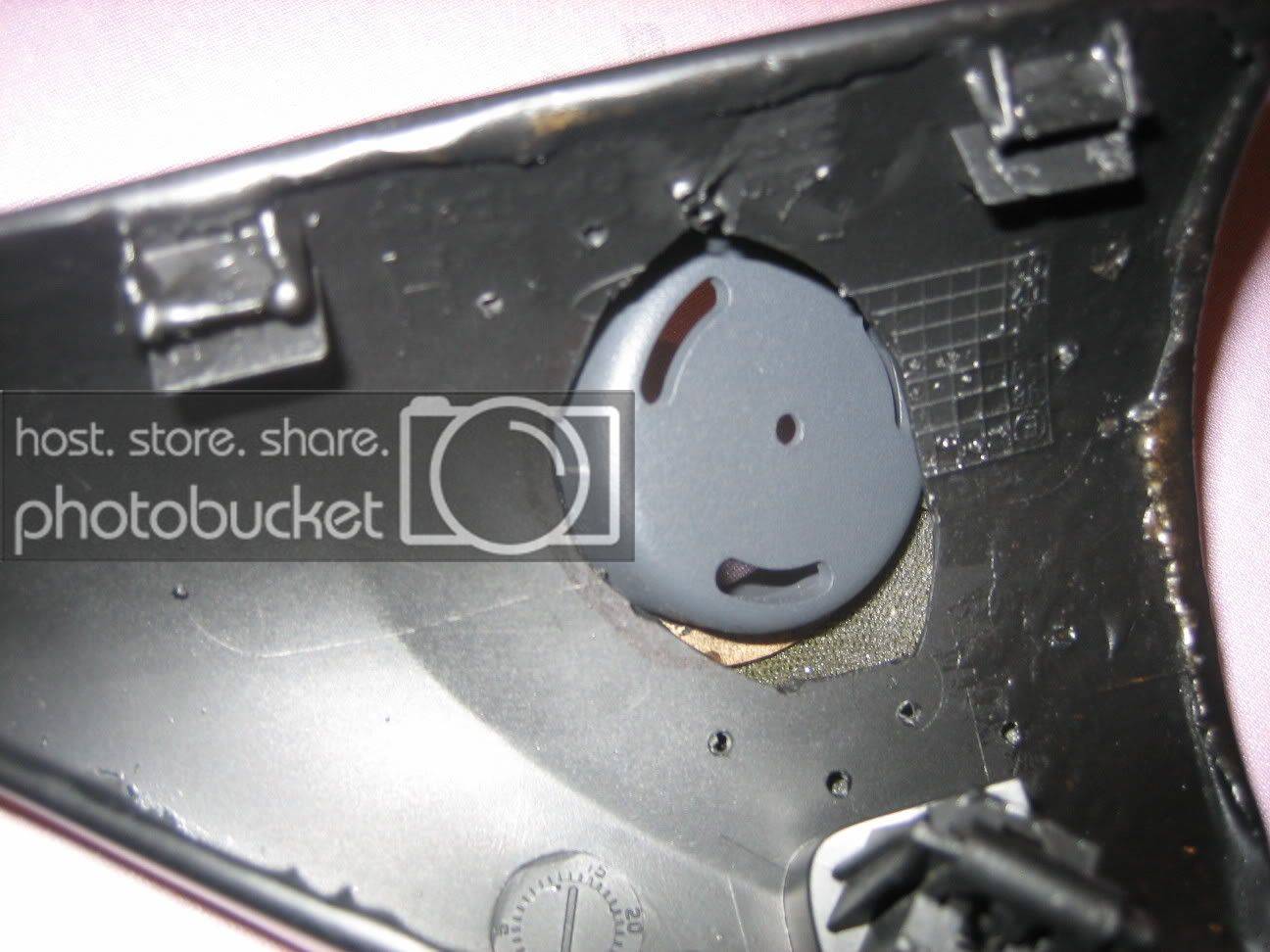

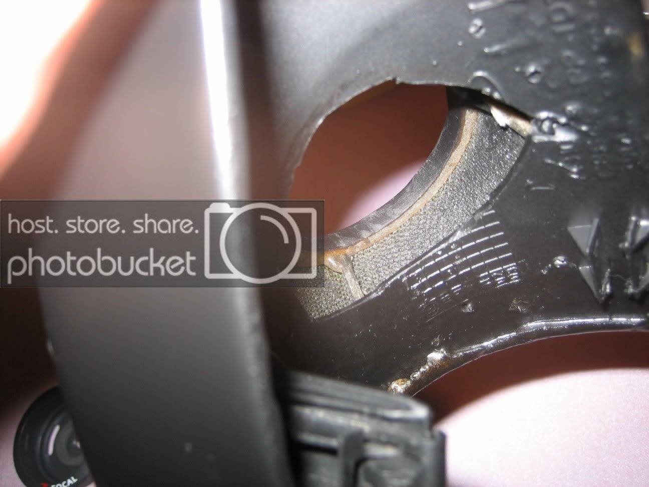

View of the back. Plastic original pod cut out to allow tweeter to protrude through:
And with tweeter housing installed (note small holes to allow filler to grip into pod on first attempts):
