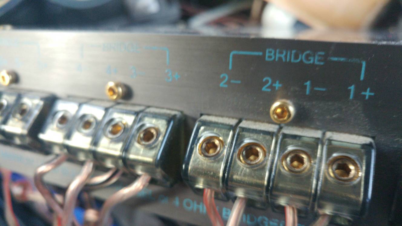

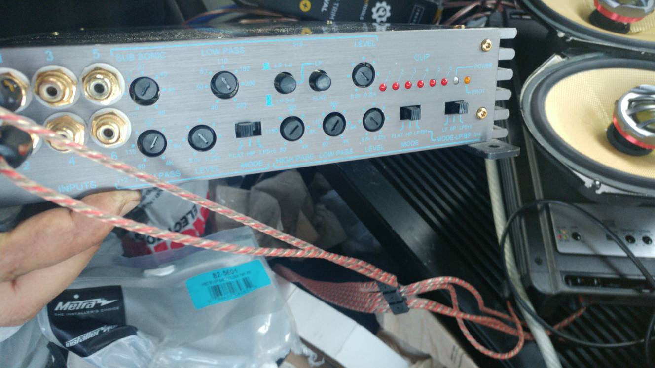

I wanted to provide an update on changes I made. I took out the crossover and wired the tweeters directly into channel 1 of my zed amp and the woofer into channel 2. Now my issue I only get the tweeters working and if I move the rcas to channel too I get the woofers working. What am I doing wrong

you should stop before you blow your tweeters.... did you see what I said? your head unit does not offer any of that capability. if you wire the tweeter straight to the amp without your head unit to cross things over you'll blow the fk out of your gear.
your goal is to first
get an active capable head unit for example pioneer 2800bs or 3800bs, 4800bs, 5800bs.
the top rca output from the head unit will be tweeter
the mid rca will be midrange
the bottom will be subwoofer
buy some rca splitters and split the midrange rcas so you'll have two lefts and two rights.
tweeter rca should be plugged on channel 1 and 2. same with speaker wire.
channel 3 and 4 will be left mid rcas and the speaker wire will be bridged
channel 5 and 6 will be right mid rcas and the speakers will be bridged as well.
you will need to start off the head unit in network mode or else you'll blow your gear. report back when you are at this stage. If you still haven't changed head units then nothing else matters, you'll have the same sh*tty issues over and over again.
