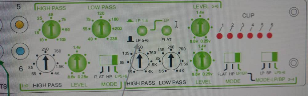

Or use the leviathan's amp crossovers. mid channel should be on low pass around 3000 to 5000hz, tweeter channel should be high passed around the same hz as well.
afterwards just use the kenwood's EQ and try to cut peaky nasty frequencies out.
Here's the controls on the amp
Sent from my LG-H831 using Tapatalk
This is what the dealer told me. But the tweeters don't sound right. They give this high pitch sound.
HIGH PASS set at about 25Hz for initial listening.
LOW PASS set at about 100Hz (1/2 way between 75 and 120)*for initial listening.
Set 1st push switch in to "LP-1-4" and set 2nd push switch to "LP"
Set LEVEL control for desired loudness.
YOUR SUBS WILL WORK.
Now looking below to Chs 1+2:
Set HIGH PASS to between 85 and 290 Hz*for initial listening.
Set LEVEL*control for desired loudness.
Set slide switch to "HP"
