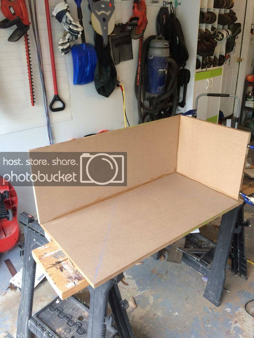

First few joints being held together

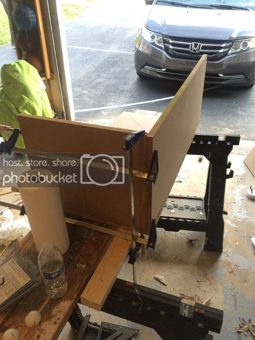

Another one

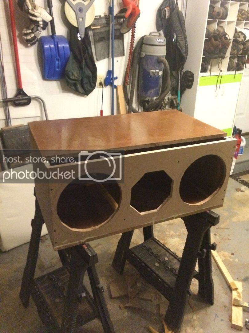

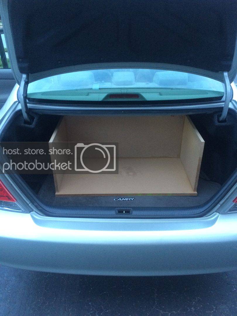

Next side wall attached and a quick test fit

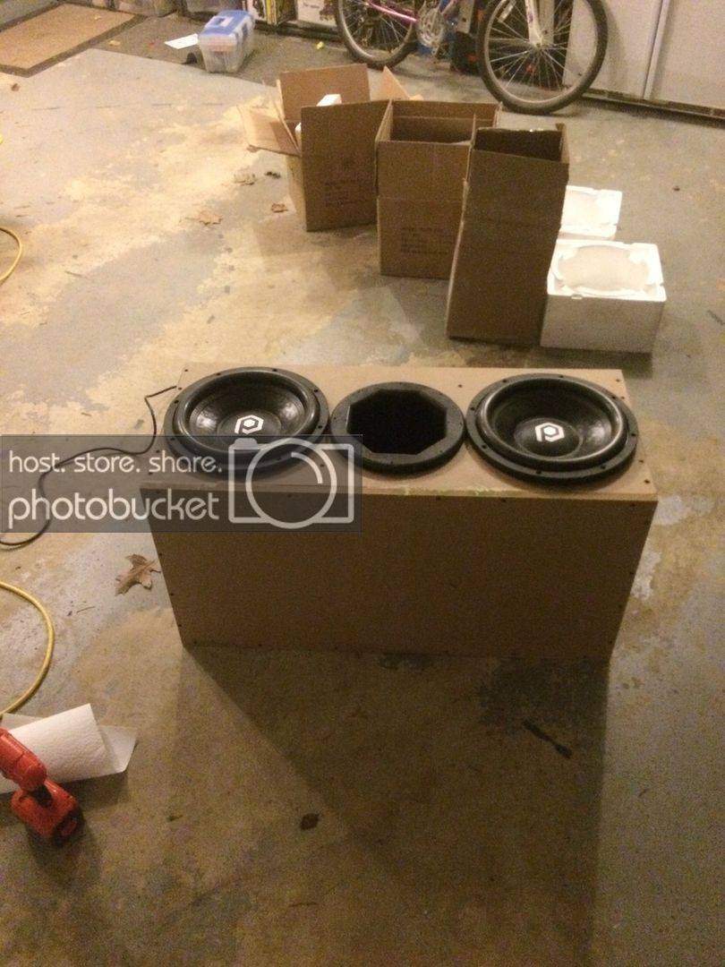

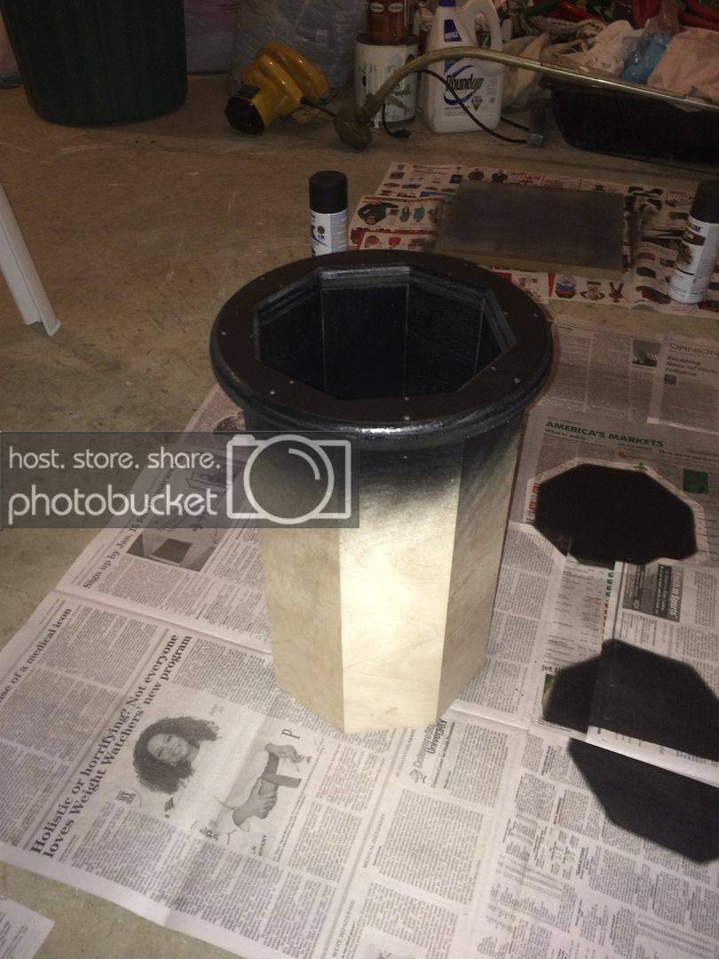

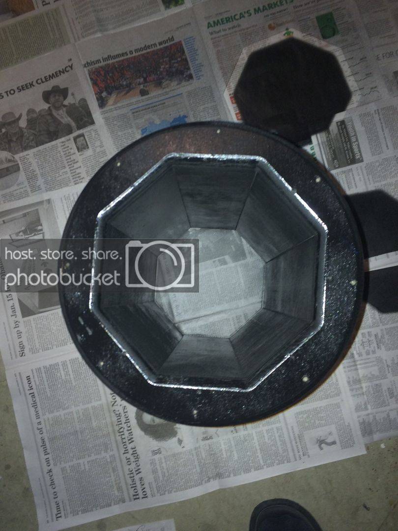

Port arrived and I hit it with some paint
Another one

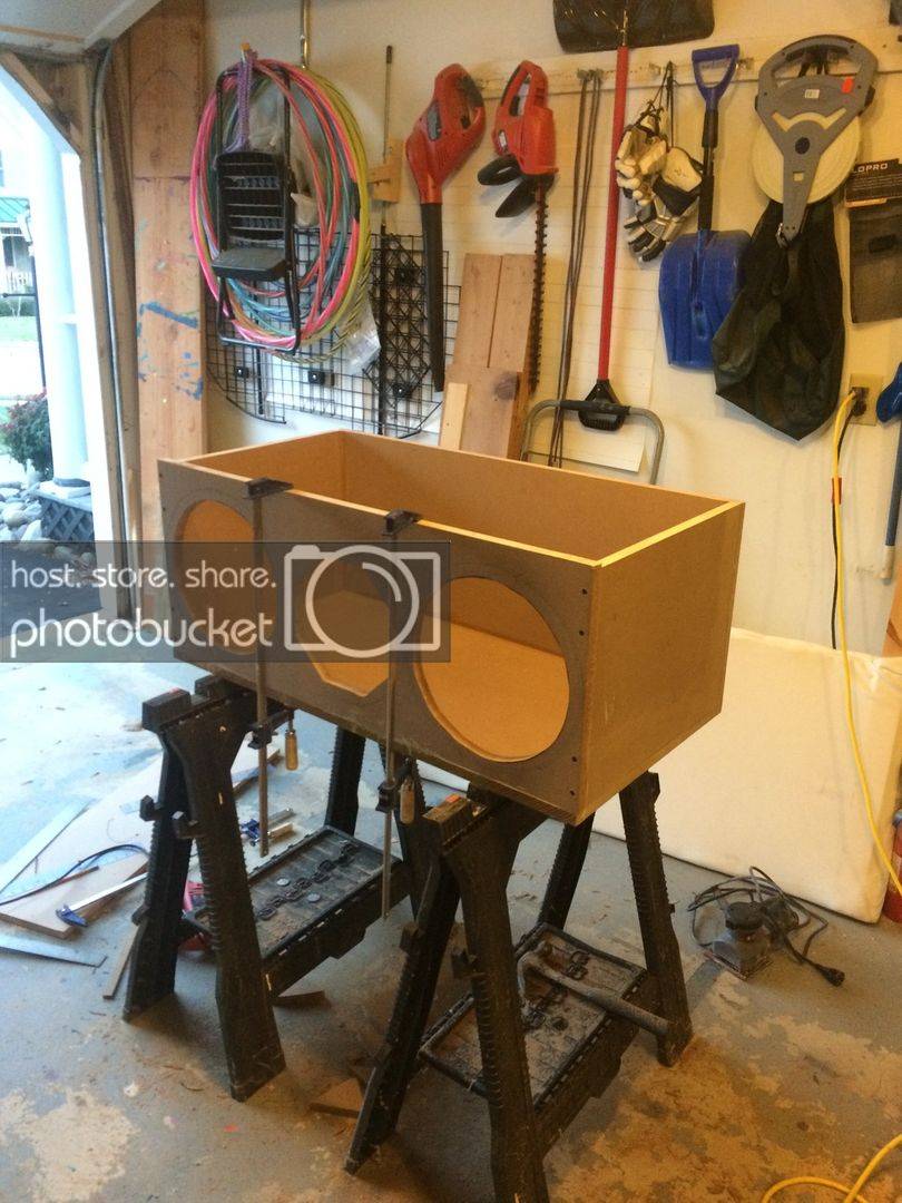

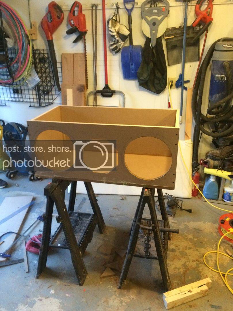

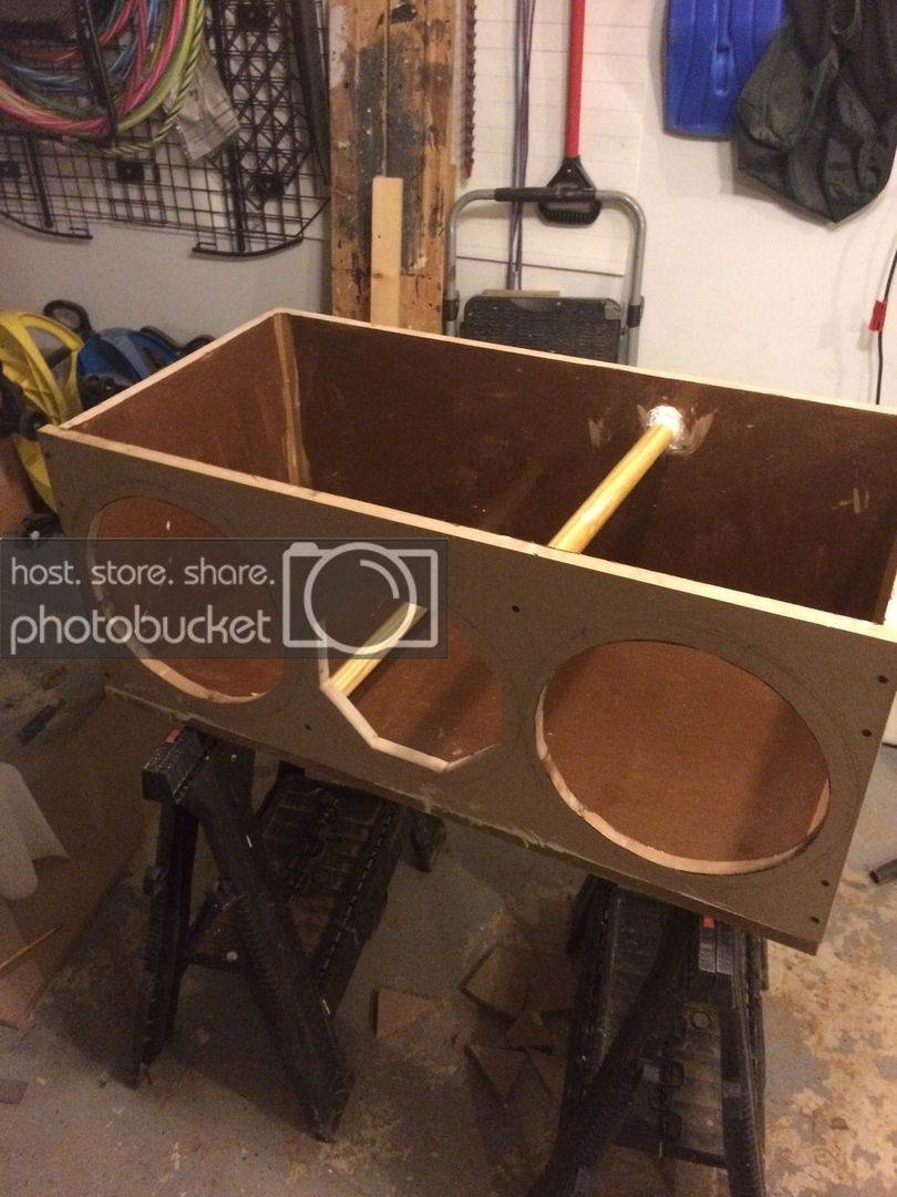

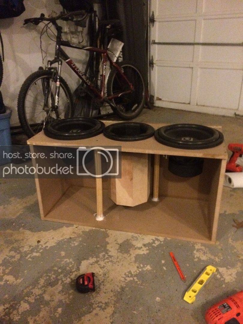

Front baffle cut and set into place
Yet another one DJ Khaled
Put some 1.5" dowel in for some support + test fit everything
Had literal milometers to spare. Still don't know how I pulled this off

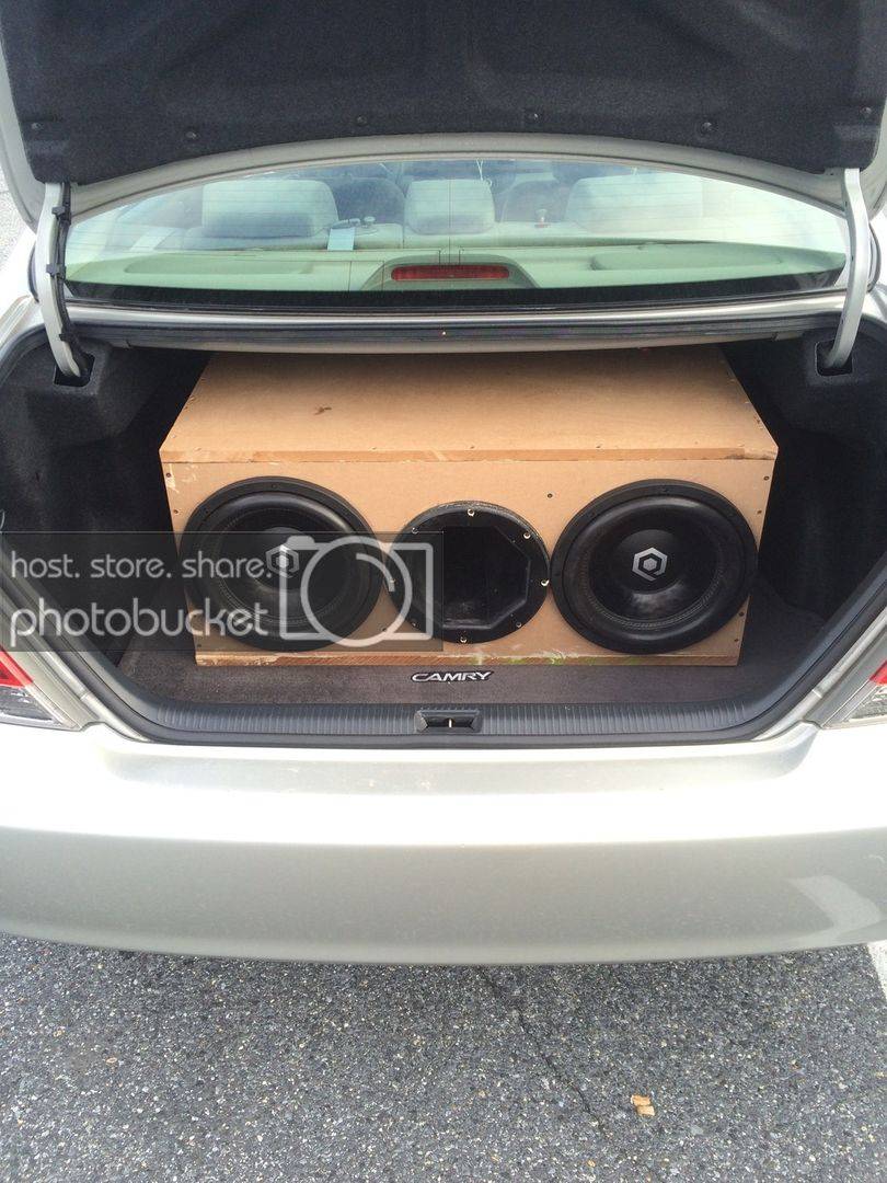

Top put on, and everything put inside. Looking very ugly for now

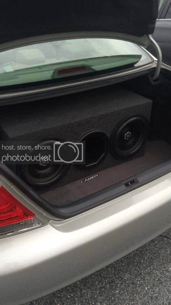

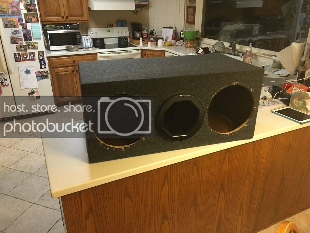

Fabric applied featuring staples galore + more paint on the port

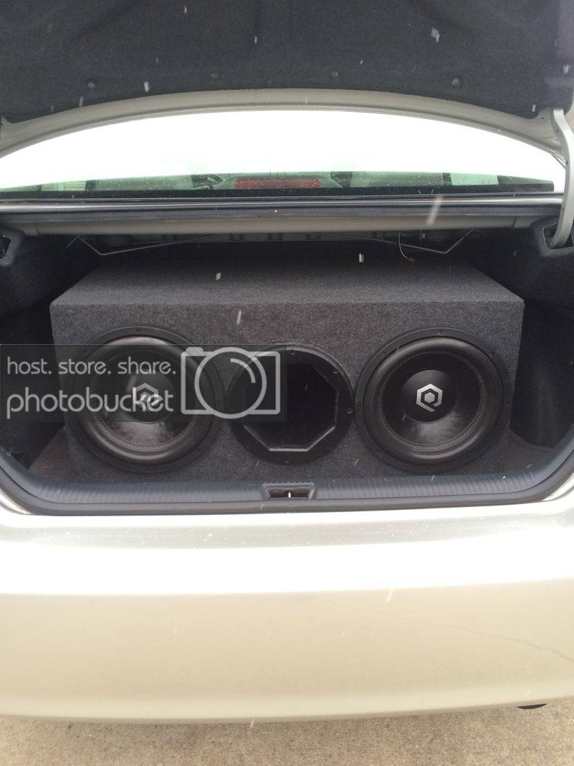

Final product in the carro
Head on featuring snow
I believe it turned out to be 4.6ft.^3 tuned to 34 hz. Hope you guys like it!
