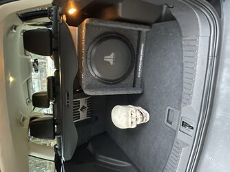

I am a new member (first post), but I recently installed 4 of the Jl c1 components tied to a Rockford Fosgate 400/4 amp along with a Jl 12” base edge sub tied to a Jl 250 w monoblock amp and am very happy with this setup in a ford escape
