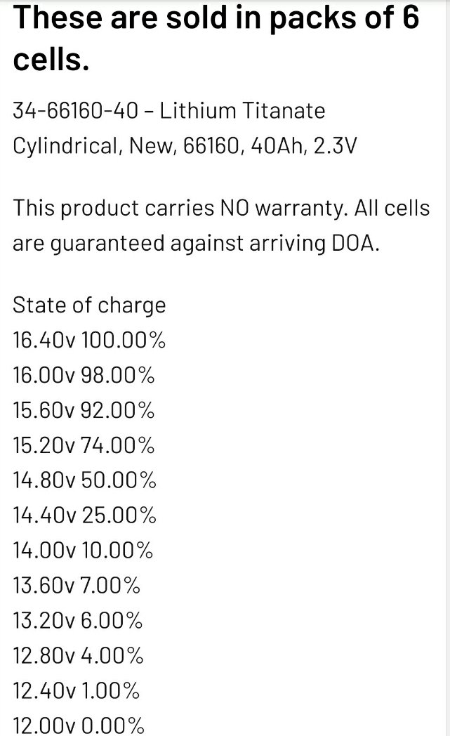

Just so you guys know. Sorry if you've seen this before. This is why you only need a 5S lithium in most 14.4v systems.
