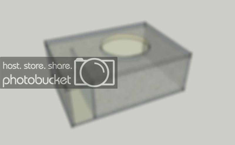

Box is for a friend of TreyE, for an 18" Fi Q. Specs:
8.3 cubic feet
29hz tuning
98in^ of port
Exterior dimensions are 44 wide, 31 deep, 16 1/4 tall.

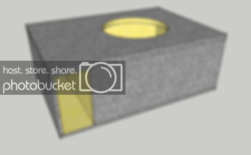

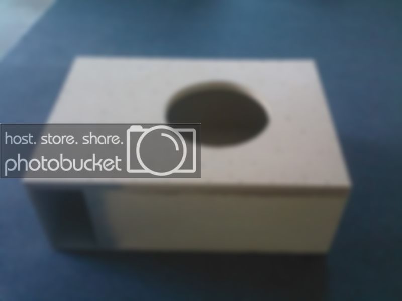

Heres what it will look like. Box is almost done, just need to paint the top port piece, cut the hole, and carpet it. Will be getting a light gray carpet.

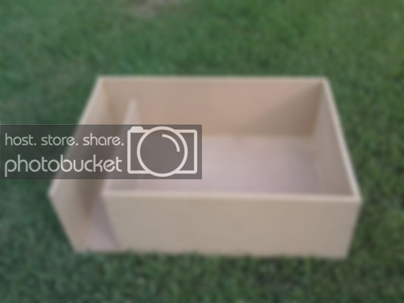

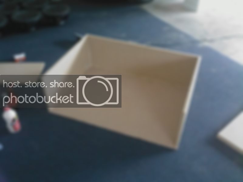

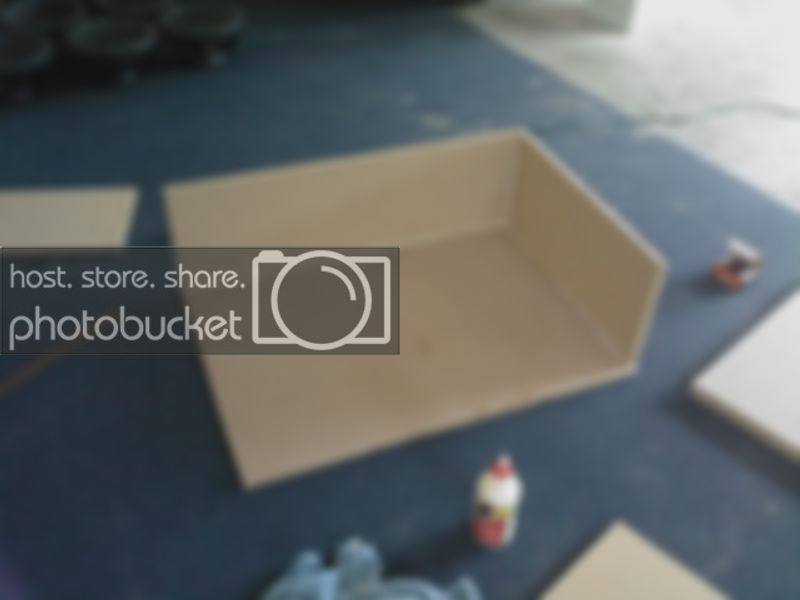

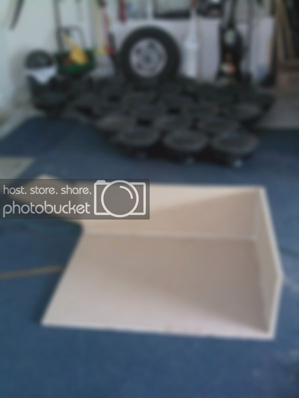

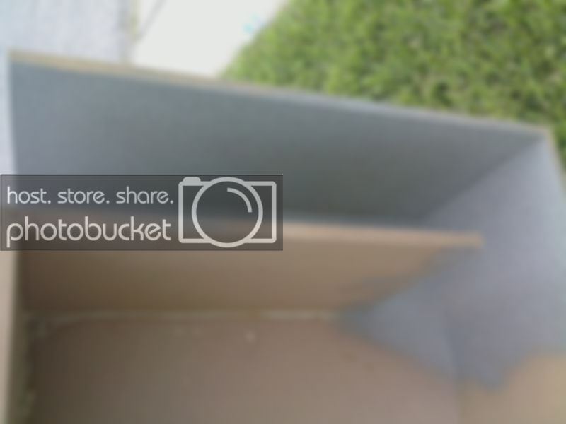

So far what Ive done. Gotta attach the top and cut the hole tonight. Then tomorrow he comes for me to wire the car and install it all. Should jam in an Explorer.
Anyone wanna buy some 15s? //content.invisioncic.com/y282845/emoticons/smile.gif.1ebc41e1811405b213edfc4622c41e27.gif

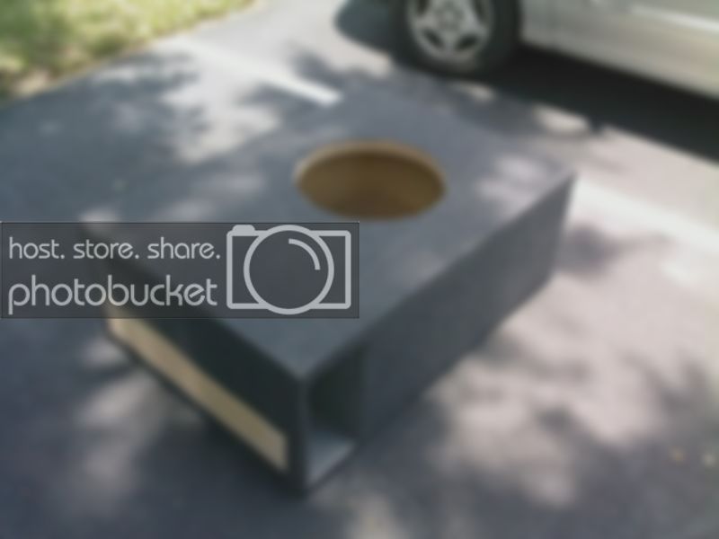

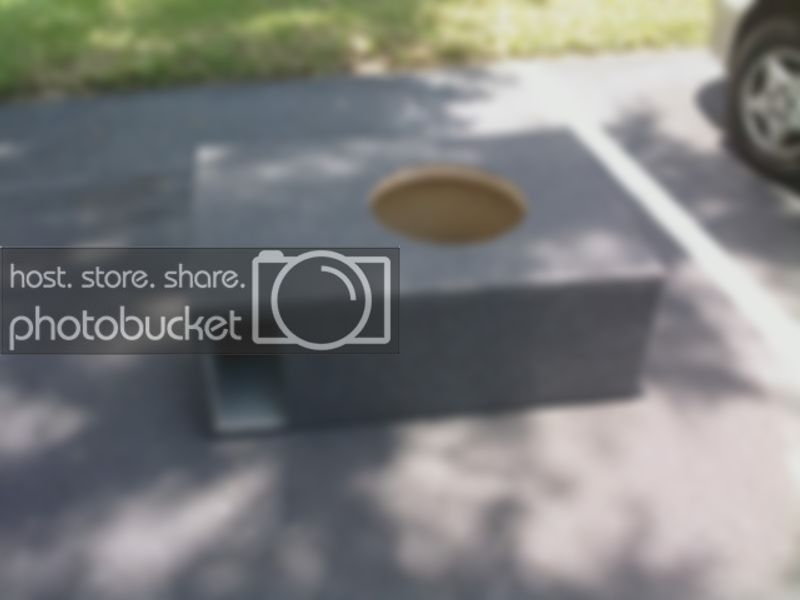

I figured the textured spray paint would look cool for the port. Change it up since almost every box you see is sprayed black in the port.
Nice i'm going to be buying a fi q 18 soon let me know how it sounds i might make my box like this. lol at all the 15's //content.invisioncic.com/y282845/emoticons/smile.gif.1ebc41e1811405b213edfc4622c41e27.gif
Na, unfortunately they didnt.
Ill sell it empty though. It fit 24 15s like a hotdog down a hallway. //content.invisioncic.com/y282845/emoticons/laugh.gif.48439b2acf2cfca21620f01e7f77d1e4.gif

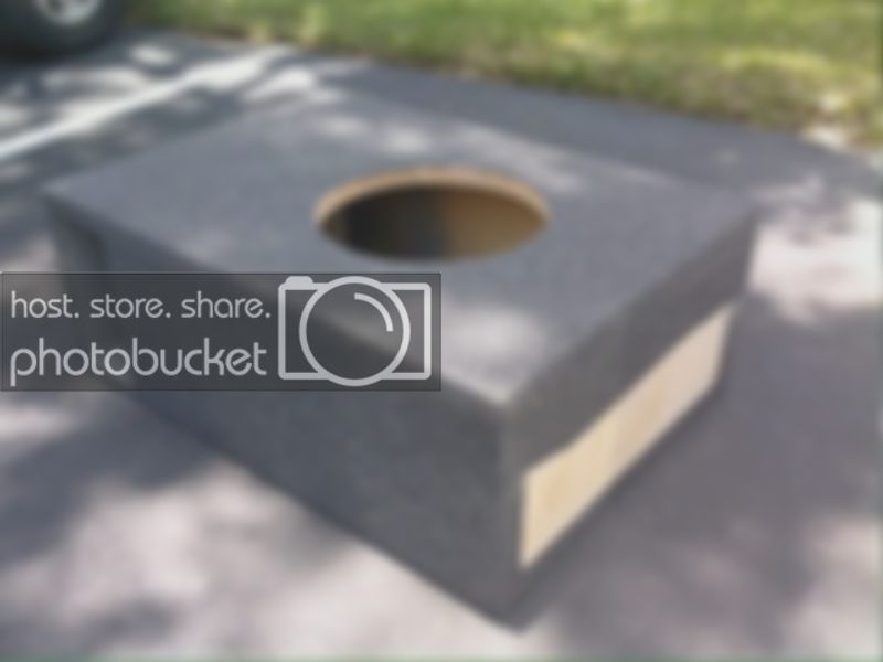

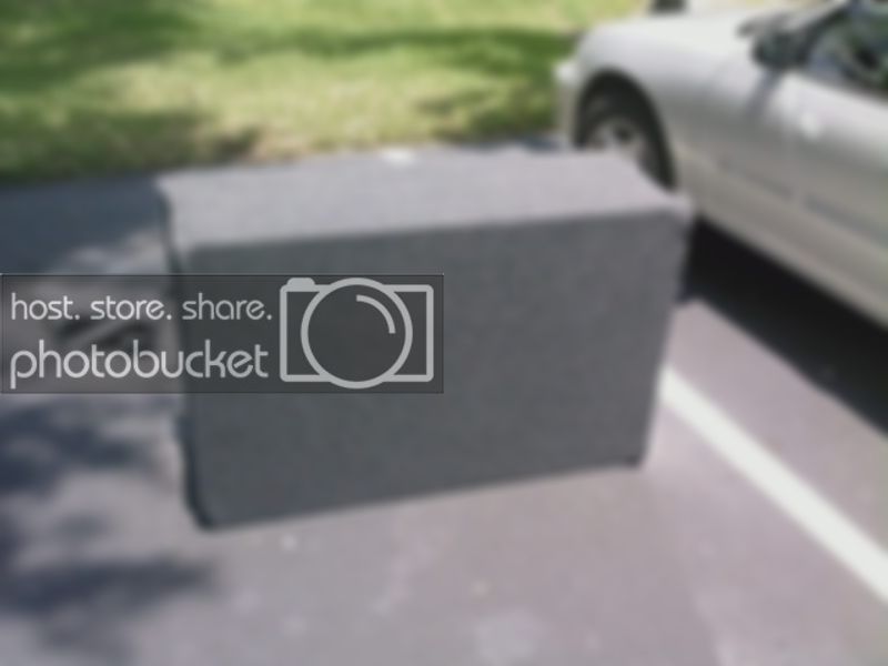

Tried carpeting it today with a dull POS box cutter. Bought some carpet, but it turns out it wasnt enough. I would have just carpeted it sideways and left the back bottom edge uncarpeted, but it wasnt wide enough. I just carpeted it normally, and used some other carpet that was left over and carpeted the top sides. The bottom sides are bare, but you wont see the sides at all since they will be up against the sides of the Explorer anyway. Besides that, it looks pretty good. Its alot of box for the money, most of which was spent on materials.
