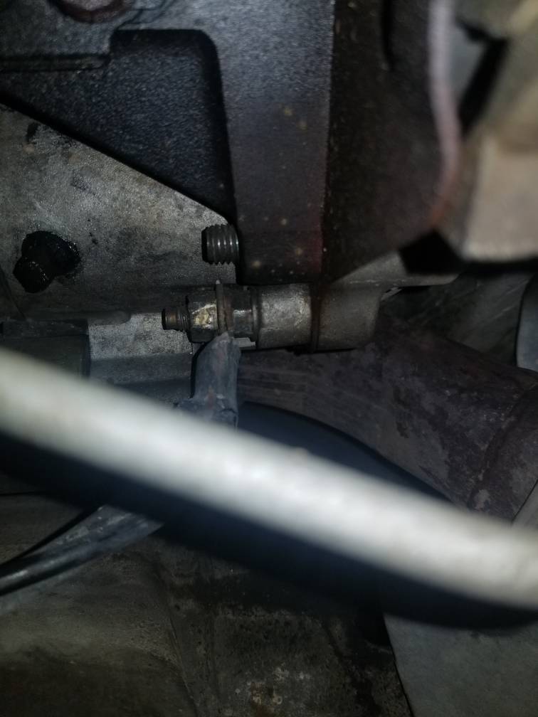

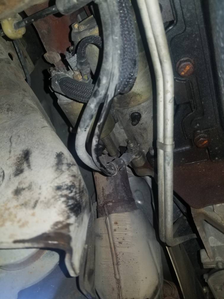

Does anybody know where the chassis to motor ground is I think I found it in this picture but it's going into the starter which I think is actually grounded to the transmission is that going to work
