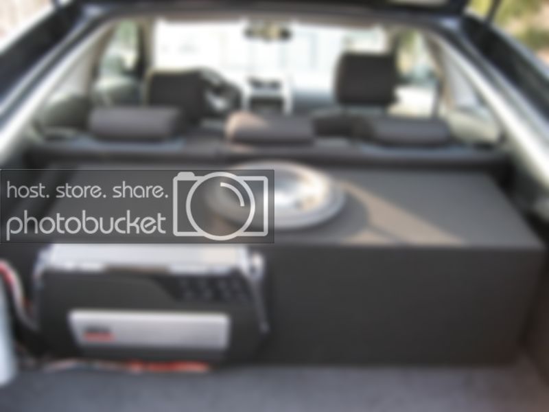

i tried both back before and like the way it sounded with them both facing up. everything also rattled more with both facing the rear. i had a type-r ten(the old school one) in a box with the sub pointing back and the port facing up. it was my first box and i didn't think it out when i built it so it didn't sound to good. i used a 3 inch port so it was port noise heaven. then tried a 4 inch port but i had to have a 90 degree bend in it to tune it the way i wanted which still had a lot of port noise.
this is the way i have it right now.
