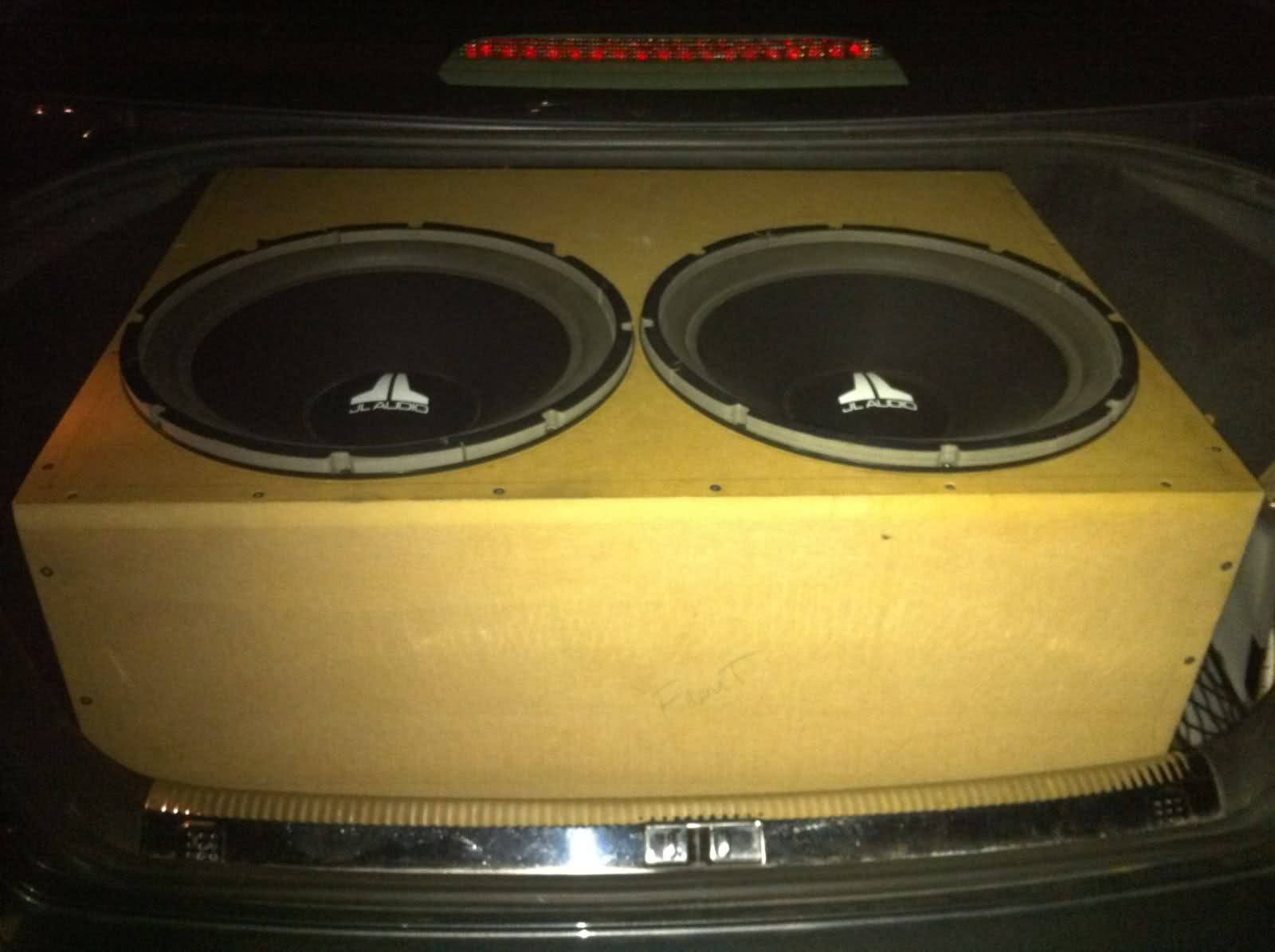

Finished my box for the 15w6's last weekend.
xmakeafistx
Extremely sloppy setup, obviously not the best.
I think I did decent on the box though. I'm pretty new to all of this.
Pictures are also kinda crappy, but whatever. Comments/opinions/advice/ etc is acceptable.
Just nobody bringing their biased uneducated "opinions" around.
This is what I still have left to do.. Bracing, some decent terminals (suggestions would be great) and thicker wire.
Please forgive me for some of the dumbshit things I probably did with this setup, Once again I am rather new.

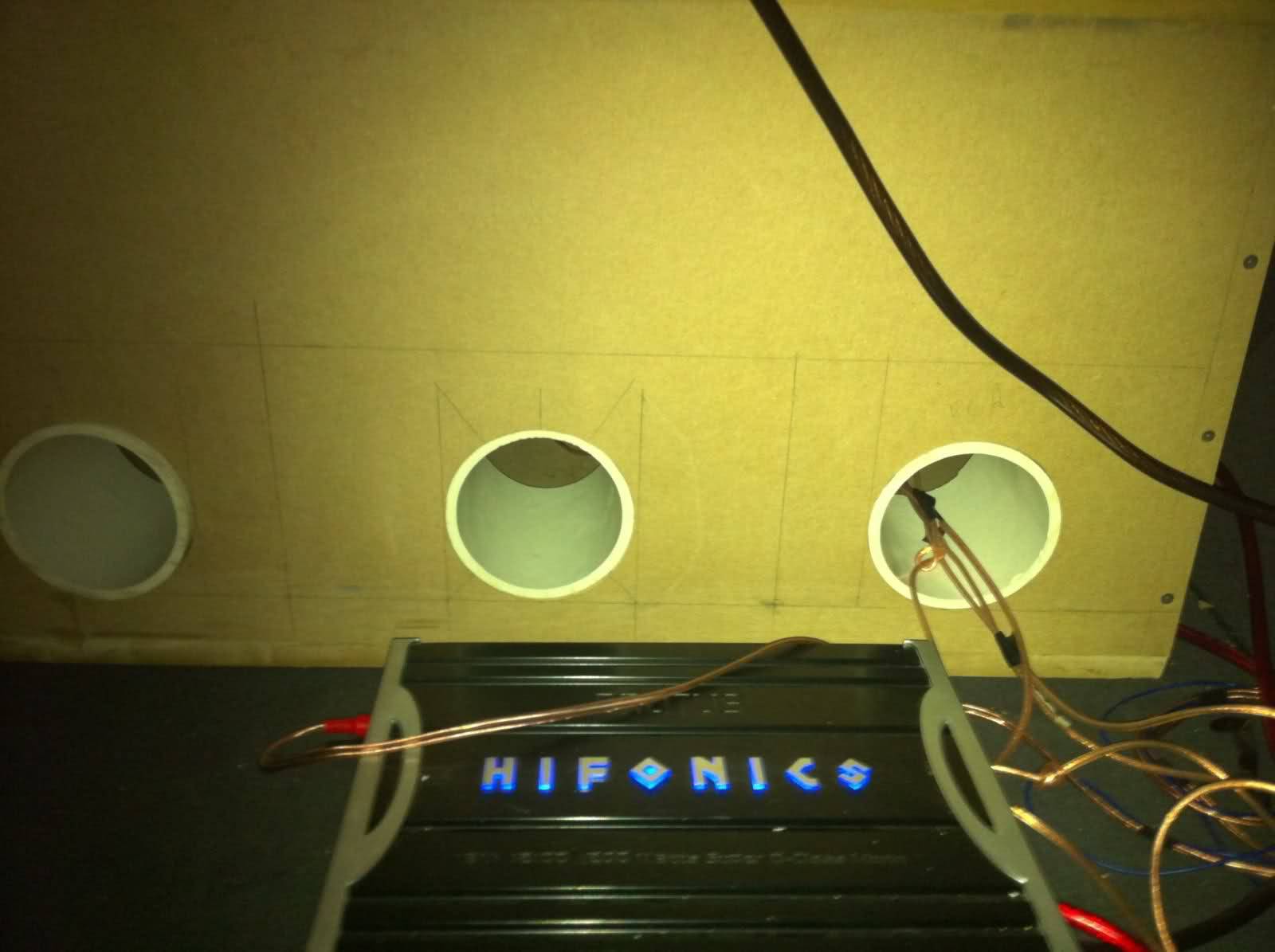

Those are not aero ports.
x2, I hate it when people refer to plain round ports as aero ports.

6.5 cubes.. I think. Lol. & Yeah these are old as hell haha.
I honestly expected these to get a lot louder though, am I going wrong with the port area or amount of cubic feet?
heres manual and stuff for those of you who really wanna help, lolol. http://mobile.jlaudio.com/pdfs/15_18W6_BDS.pdf
Your port area is on the small side, but you're also firing the subs up, right into your trunk lid(and it looks like it would be pretty close to the lid). That's probably killing some of your sound as well.

Op, you should try more port area
Also the pvc your using now seems to be mighty short
THIS! Doesn't that concern anyone else? lol. OP what is the length for the ports and what was your desired tuning frequency?
Please don't tell me you just cut the PVC to a random length and threw it in there (don't laugh, I know a full grown electrical engineer that does this)
I just went by JL recommendations for the port area. lol. & I cut all the PVC to 8 inches each. I had no idea that the size of the pvc mattered lol. I kinda just went off of Buck's base plans for the box he was going to design for me, but he never got back to me on it. He kinda backed out on this idea and wanted to do a slot port, but I mentioned that it would not fit the trunk, unless he could design a way that could. Then I just never really got a reply.
He said that this should be tuned to 30hz, but I probably did something to mess that up.
