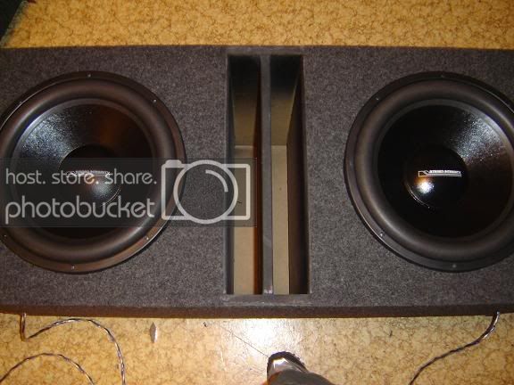

Well I finally got around to having time to finish it up //content.invisioncic.com/y282845/emoticons/wink.gif.608e3ea05f1a9f98611af0861652f8fb.gif
I'll have more pics up of the install tomorrow when i get home from work but for now this will have to do heh.
Oh btw its 3.5 net per sub tuned to 28 hz 3/4 mdf double baffled.
The port is painted about a 1/4 of the way in my install the port wont be showing much its gonan be a in a downfire setup for my ext cab silverado .
Nice my brother, that a big freakin box. Now round over them edges //content.invisioncic.com/y282845/emoticons/biggrin.gif.d71a5d36fcbab170f2364c9f2e3946cb.gif//content.invisioncic.com/y282845/emoticons/smile.gif.1ebc41e1811405b213edfc4622c41e27.gif
