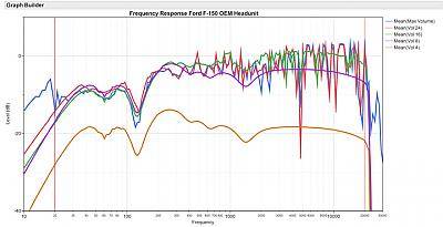

I agree, I found an image of the Ford factory radio output response.
This is the actual output at the speaker lead, goes into the head unit flat and comes out hacked up, different volume levels shown. Any volume over 20 results in the jagged mess at the top.
