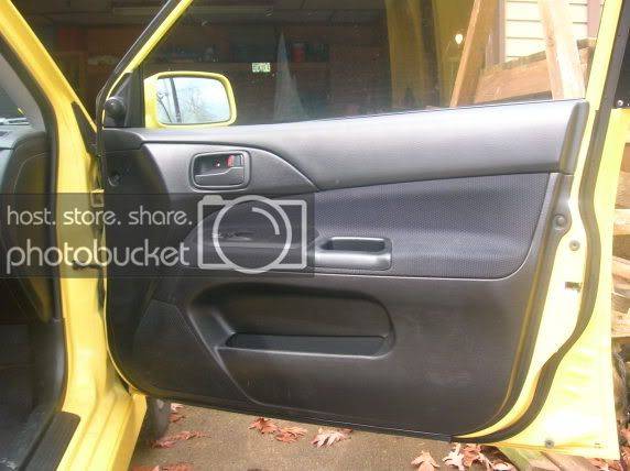

my door panel b4 the operation...

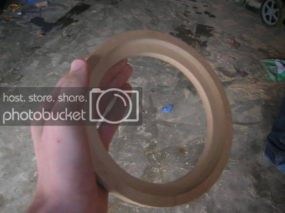

speaker ring...will be rescessed to give it that "different" look

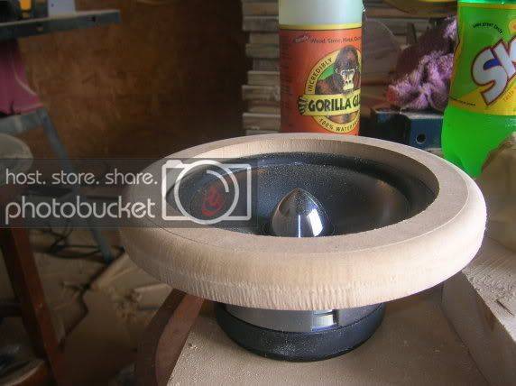

after it got routered...is NOT sanded yet...

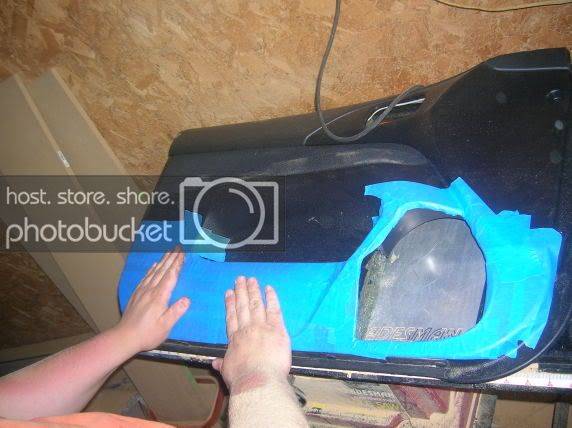

taping off teh door panel...the speaker grill was already cut out

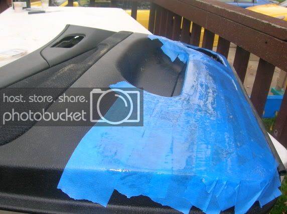

first layer of resin on door panel...

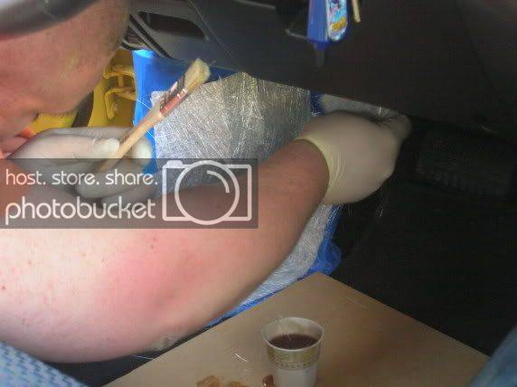

glassing the kicks...(the door panels warped so we are goin to start those again later)

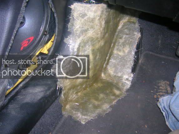

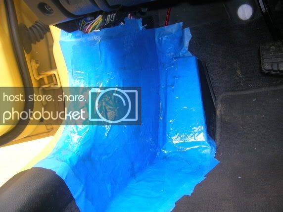

first layer of glass on, tape removed...fits like a glove!

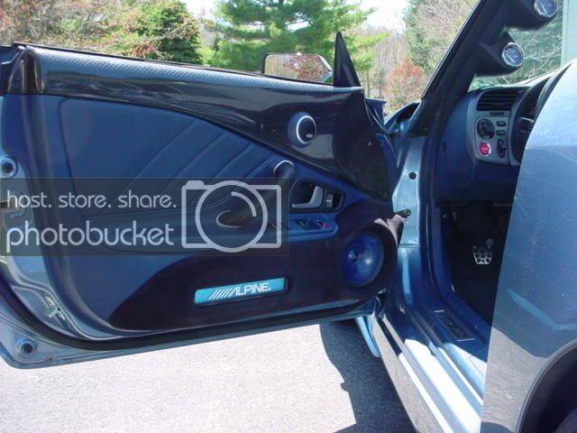

her is a pic of my typeR's in the fiberglass kicks I made

Looks that way too me as well. Did you remove the dead peddle ? //content.invisioncic.com/y282845/emoticons/smile.gif.1ebc41e1811405b213edfc4622c41e27.gif
the only place that it is dry are the places that we are going to trim off anyway...and actually most of it is just the flash on the camera //content.invisioncic.com/y282845/emoticons/wink.gif.608e3ea05f1a9f98611af0861652f8fb.gif
plus that is only one layer...apprx 5 more will be going on. and no, we didnt remove teh dead petal...
Removing the dead peddle itself sometimes makes for a great mounting point for the drivers side. Did in mine, once removed left me two bolt holes to use for mounting //content.invisioncic.com/y282845/emoticons/smile.gif.1ebc41e1811405b213edfc4622c41e27.gif
