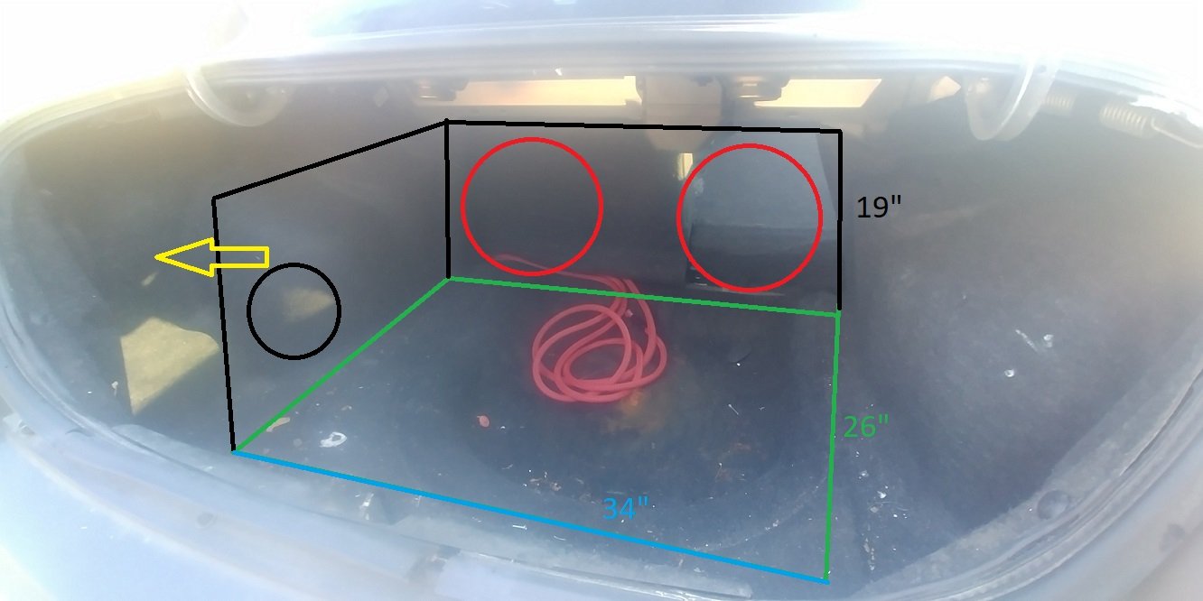

I hear ya. The issue is just that i have a small trunk. If i want a 15 or two 12s, i will be building box in the trunk, and wont be able to move stuff around after the build.
Face sub to the rear and port to the side. It's been done that way for decades. Which ever way you build your box, you will not know if the other orientation is better unless you start over. If you can fold your back seat down. Face the sub forward and port to the side. Then, if you don't like it, fold your back seat down and remove the sub and cap the box. Then, install the sub facing to the rear. If that doesn't suffice, remove sub and cap box. Then, install the sub facing up. Is that feasible?
Yea, im following you for the most part. I think to truly test these paramaters i should just build a box for 1 sub, then i will be able to experiment like you say. Not enough room to do that with 2 subs in my trunk.

well, 26"x34" is max dimensions. its not turning around in the trunk. trust me, i wish it would... it would make this process way more simple.
