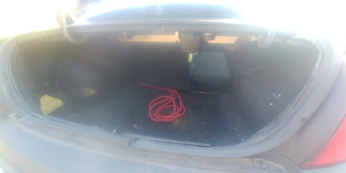

My trunk isnt very big (Neon). Max dimensions is 7 cubes net before port displacement. Im gonna need to use all the space i can get. The front baffle would be 24" from the back of the box next to the trunk wall so not 3 or 4 feet apart like i previously said.

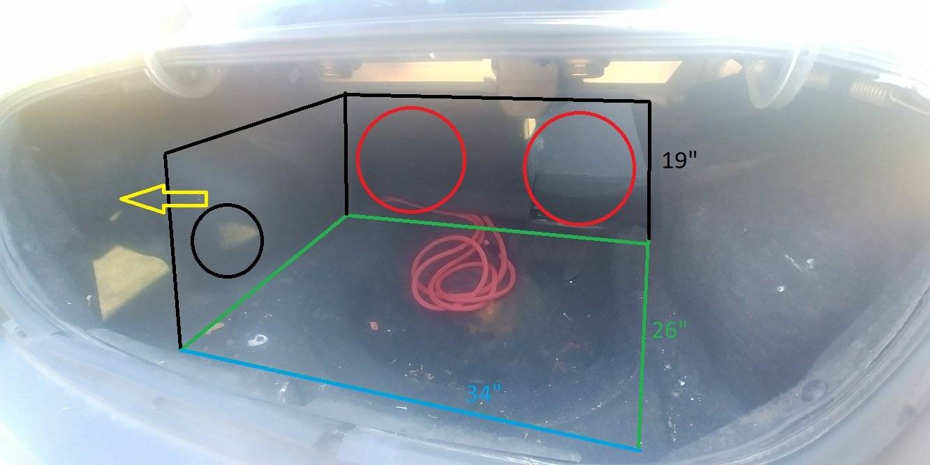

The only way i could see testing different orientations of the sub/port position is if i built a box for just one 12. The trunk opening is small so i have to build in the trunk. I dont think i would have the space to move a box with two 12s around in different positions.
However, in terms of making the most of the real estate... subs forward, port to the side would allow my box to be built all the way to the rear of trunk wall. If the subs were facing to the rear, the box would have to be pulled back from the rear trunk wall to leave some space for the subs to fire into and id lose some precious volume.
well we wont know about your car unless extensive testing is done with a meter. We always thought subs and port rear was the way to go in my buddy's altima until we built a box with removeable ports in different orientations and found our sweet spot.
Is this the idea of where the port would be when you say on the side?
