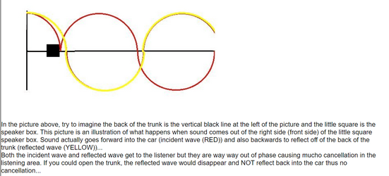

I was under the impression that if your sub was facing forward, (its going to be close to the back seat) and your port is toward the rear of your vehicle, you get cancellation issues as the back wave is out of sync with the front since they are emitting from locations like 3 or 4 ft apart from each other.
