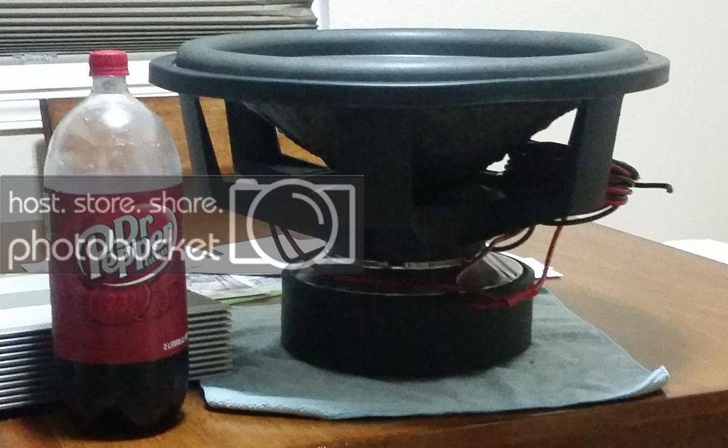

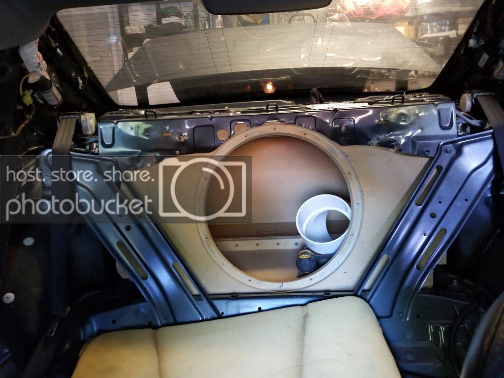

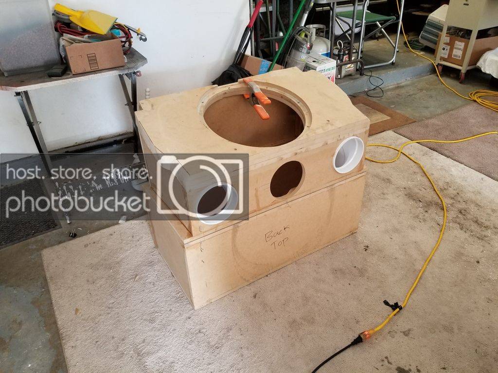

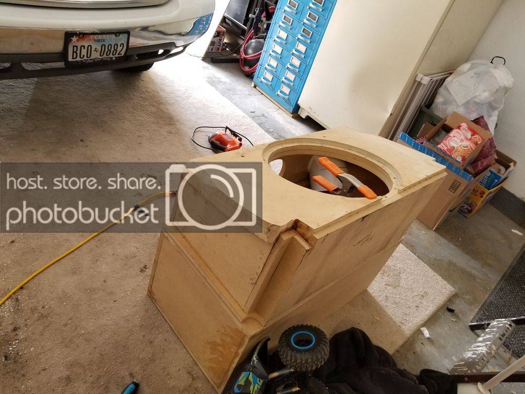

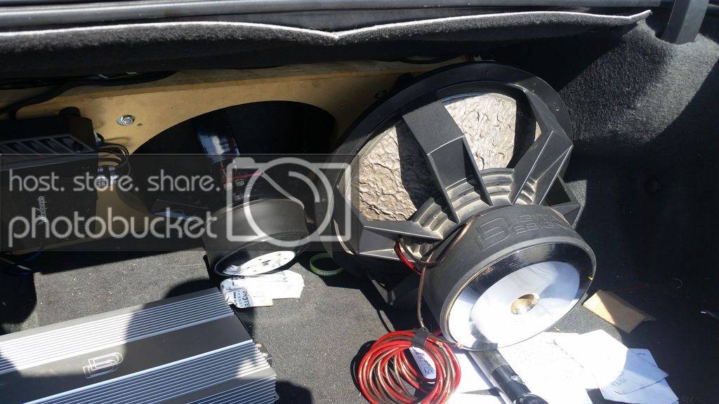

So I caught a good deal on the DD sub and amp from a buddy, and proceeded to make it fit. Had to cut some metal out. And since my back seat doesn't fold, just the arm rest. I decided to port through the rear deck. Had to build the box in 2 parts to fit it in the trunk. Ended up reusing my baffle from my IB setup. 2 layers with a 3rd flushed.*

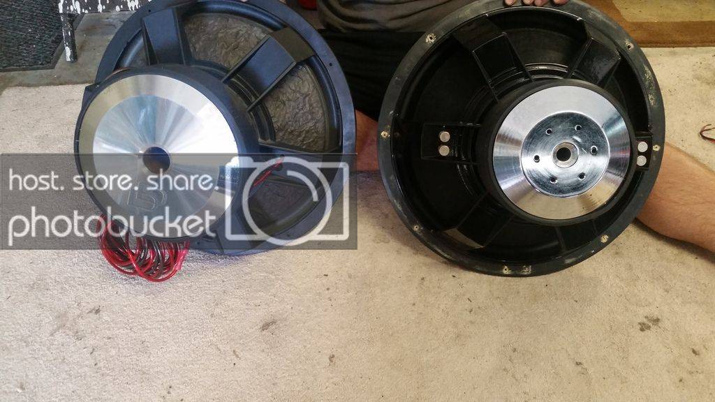

The DD next to the SI

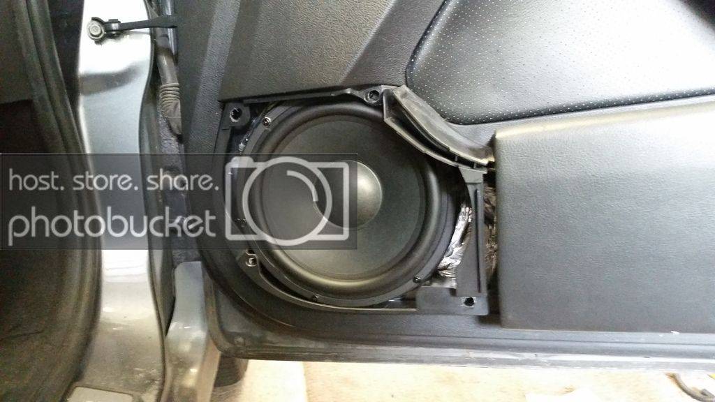

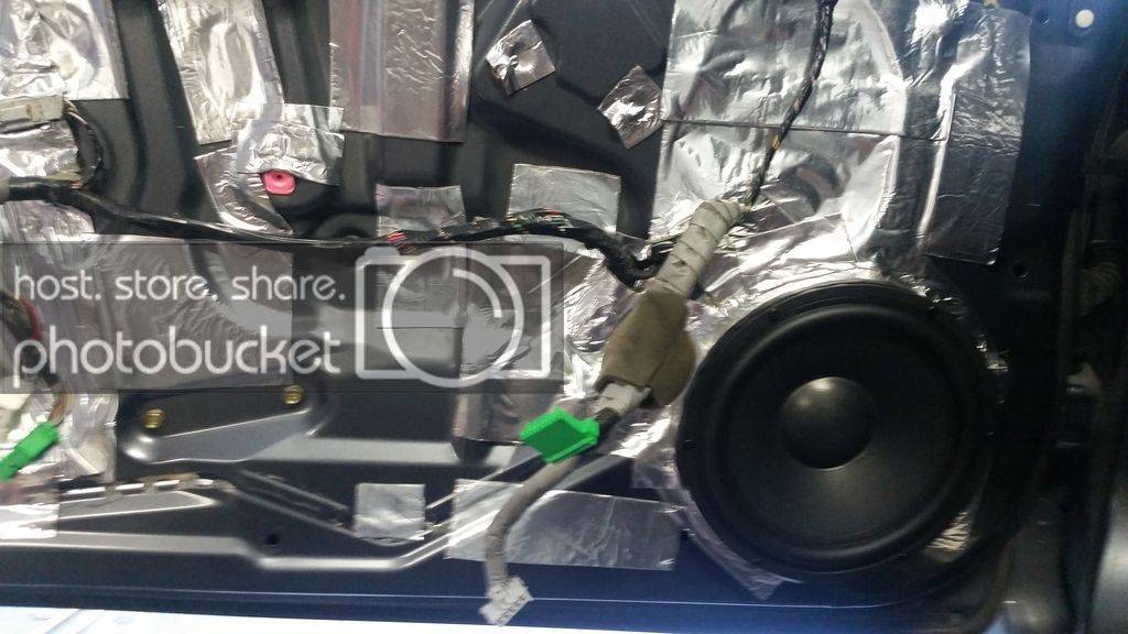

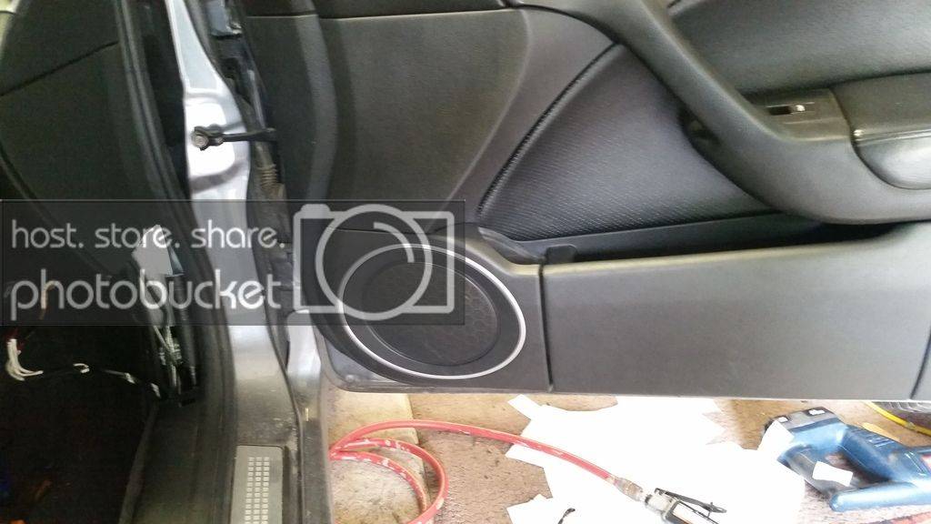

The 8s in the doors. Pain in the rear!!

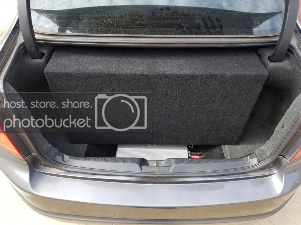

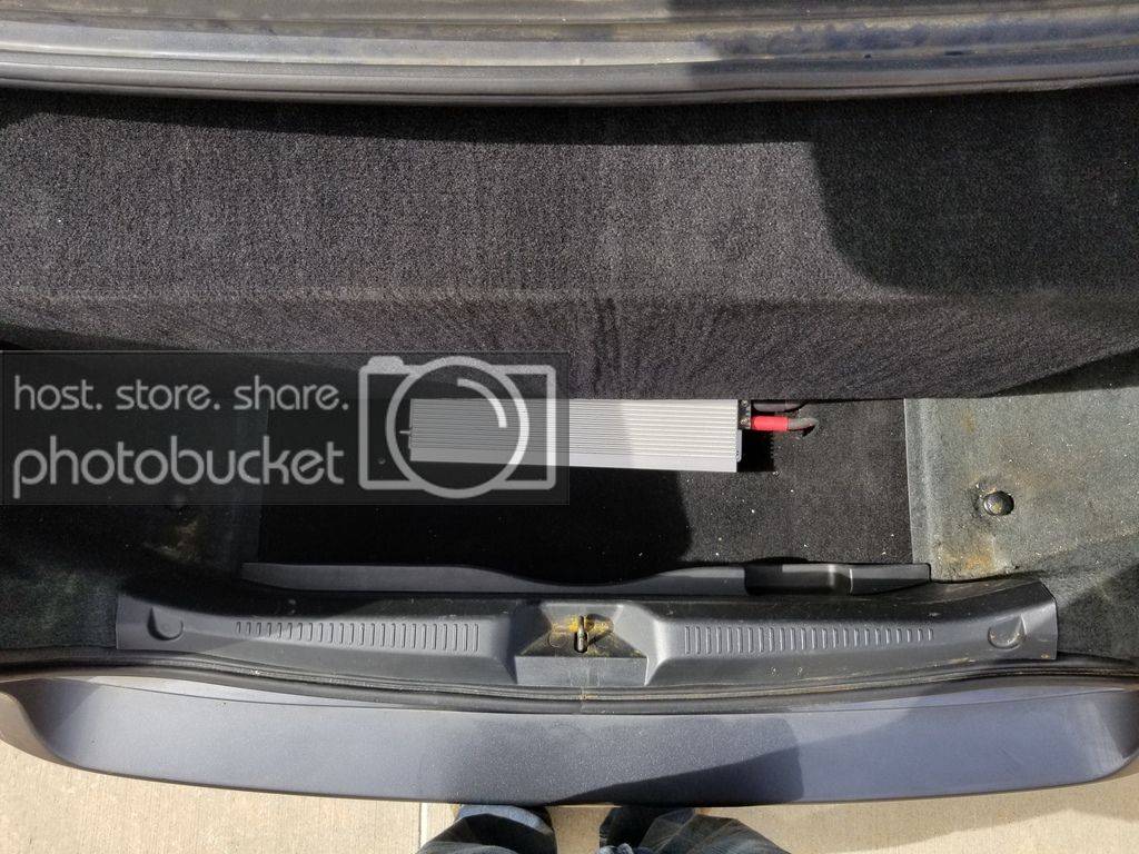

The box. 7 cubes net. 32hz. 2 6" flared ports. Tried for a 3rd, couldn't get it to clear the magnet... Might try again later.

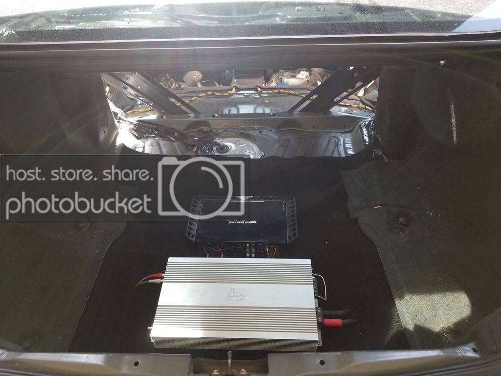

And here is the sub and amp rack

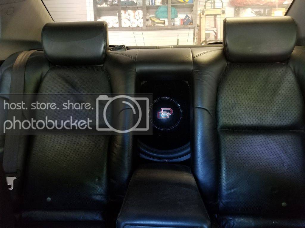

Backseat and amp cover in

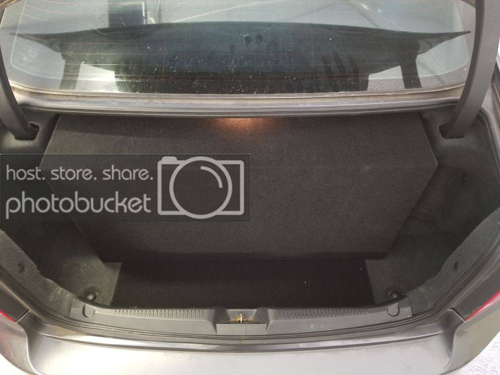

I forgot pics of sealing the box off with foam. Sealed the deck off with ram mat.
Overall I am very happy with it so far.
