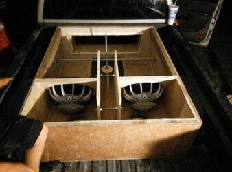

I wouldn't be opposed to a blowthrough, but I've never heard or seen one in person so it'd be solely done from common sense and the internet.
No build logs but I might be able to find some pictures.
This was two Fi BTL 18s in a 6th order blow through in a Silverado.
Oh man beautiful, I loved the one going through the window. Seems like you know your shit. Think im gunna scrap my original plan and start saving up for a blowthrough.
