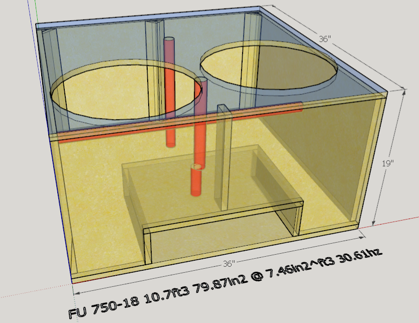

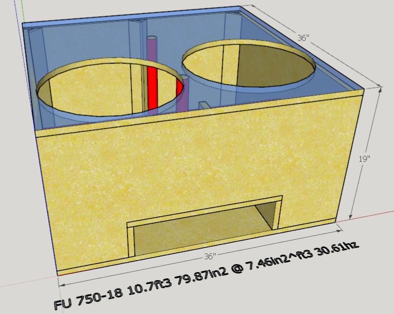

I did try to brace the thing in a way to use a single .75" construction all around, minimize displacements (I ended up with 1.37ft3 total displacements with bracing/port/drivers) I know an round/areo would save volume but I was just playing around... it's Sat.).
What else am I missing here guys?
So much wrong with this one that I don't even wanna post it but here it is...
Dogpile away boys... I deserve it for even posting this... lol

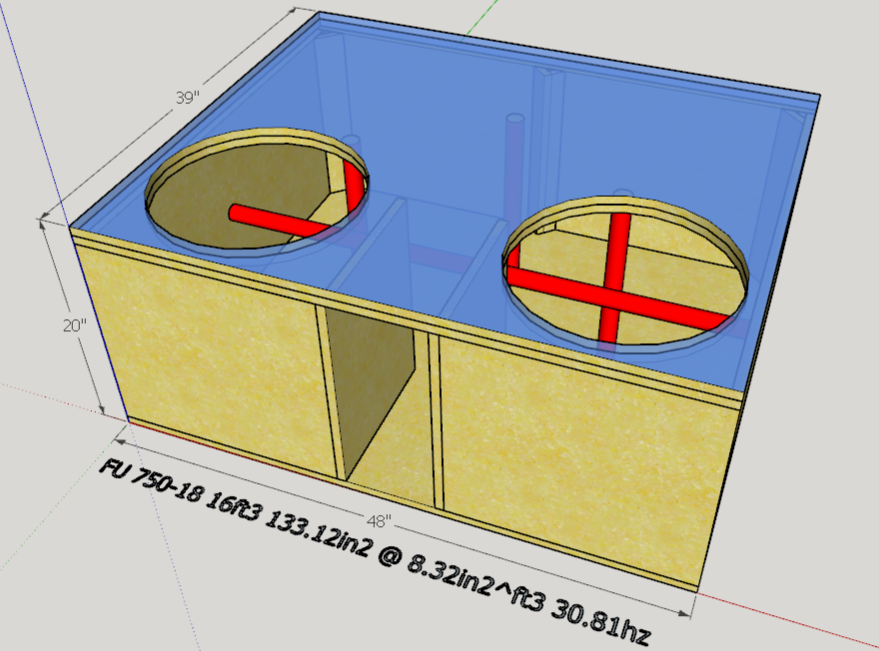

I'd do something like this if I had 2K and a pair of those subs...
I wouldn't even consider doin a pair in a Century trunk... I'd either wall it or find something cheap that'll fit something 15-16ft3 net with some port.
That ^^^^ is pretty much what I'd do and it should do just what you want unless you want it to sound like a it's got a pair of X-18's for example.
