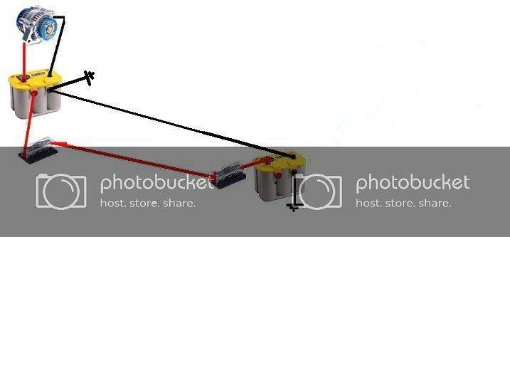

That was my old set up.
Just run your + and - to the amp off the rear battery as well. not in picture.
thanks guys, what gauge wiring do you recommend between the batteries? i know i'm currently running 4 AWG from the main batter to a splitter between my amps, should i use larger gauge or does it really matter?

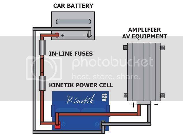

Page 8 is a better pic like he said but same as mine just better lolOnly thing missing in the pic below is that rear battery should be grounded.
